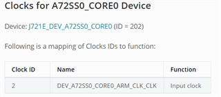

    Link: software-dl.ti.com/.../clocks.html
    So actual clock is  <&k3_clks 202 2> & frequency is 2 GHz.
    The other clock is GTC Global Time counter: &k3_clks 61 1
    Basically we are enabling the Global time counter before enabling the A72.
    So <&k3_clks 202 2> is the actual clock that is running at 2GHz for A72.
