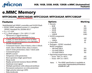

I found a problem while verifying "CAN Response and Bootloader Demo Application".
Loading the kernel would take 5 seconds.
The MCU will take a lot of time to load the firmware, is there a way to speed it up?
