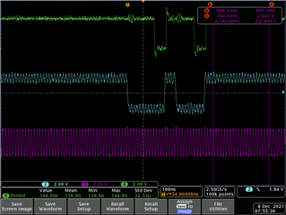

The GPMC registers are configured as below for the CS0
# devmem 0x3B000050
0x00000100
# devmem 0x3B000054
0x00000301
# devmem 0x3B000060
0x00601000
# devmem 0x3B000064
0x00080801
# devmem 0x3B000068
0x00000000
# devmem 0x3B00006c
0x08000800
# devmem 0x3B000070
0x00080808
# devmem 0x3B000074
0x88000380
# devmem 0x3B000078
0x00000E50
When we accesses the 16 bit device on the GPMC bus using the commands
# devmem 0x50000000 16
0x0002
# devmem 0x50000000 32
0x00000002
We see this on the scope for both 16 bit and 32 bit access. The pink is the clock, blue is chip select 0 and green is the wait signal.
For the 16 bit write we see this on the scope.
devmem 0x50000000 16 0x0002
