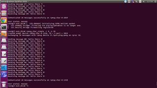

  • Hi Suman,
    Thanks for your reply!
    as per your suggestion we referred ti_rpmsg_char library.
    we have few doubts after running the application.
    1.running "rpmsg_char_simple -r 0 -n 10" considering -r 0 denotes MCU1_0,we received an output as attached in SS1.

    4. One more thing,
    We have replaced rootfs/lib/firmware/j7-mcu-r5f0_0-fw with our own application and executed command
    Still we are getting response as mentioned in your example.
    Our understanding is that we have replaced the MCU1_0 and how come "rpmsg_char_simple" example is working?
    your help is highly appreciated!!
    Tanvi
  • Hi Tanvi,
    Can you give the output of "cat /sys/kernel/debug/remoteproc/remoteprocX/resource_table" where X corresponds to the number associated with MCU1_0 (You can use head /sys/class/remoteproc/remoteproc*/name).
    The common issue is that you are either looking at a different location or you are not accounting for Cache.
    regards
    Suman
