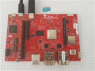

Hello TI,
I have bought a SK-AM64 starter kit and have issue to get started.
First of all i used an incompatible SD card (SDXC) instead of an SDHC. After googling that issue I ran into this issue.
The console is continuously printing out mmc1: "Got data interrupt 0x00000002 even though no data operation was in progress." followed by a register dump.
Am I using wrong version our do I need the build a new one to solve this?
Wrong SD card maybe?
I am using the "tisdk-default-image-am64xx-evm.wic.xz" 8.00.00.21 flashed to SD card with balenaEtcher.
This is the board and sd card I use.
Console printout below

Best regards
Magnus
  • Hi Magnus,
    We have occasionally observed this type of behavior with different SD cards. It is not necessarily a certain brand or type of SD card, but seemingly simply variability between one batch of cards to another. SDXC cards are also not an issue, you should be able to use them.
    Can you please try a different SD card? I expect that should solve your issue.
    If you are continuing to see this issue, please let me know.
    Andrei
  • Hi Magnus,
    You're using the right version of the SDK. Your boot log looks good until the mmc1 error:
    [ 1.439590] mmcblk1: mmc1:59b4 00000 14.7 GiB
    [ 1.448533] mmc1: Got data interrupt 0x00000002 even though no data operation was in progress.
    Please try a different SD card as Andrei suggested.
    Jianzhong
    Thanks for the answer .
    I tried an other SD card with an another error.
    U-Boot SPL 2021.01-g53e79d0e89 (Aug 10 2021 - 21:47:42 +0000)
    EEPROM not available at 80, trying to read at 81
    SYSFW ABI: 3.1 (firmware rev 0x0015 '21.5.0--v2021.05 (Terrific Llam')
    SPL initial stack usage: 13392 bytes
    Trying to boot from MMC2
    Starting ATF on ARM64 core...
    NOTICE:  BL31: v2.5(release):08.00.00.004-dirty
    NOTICE:  BL31: Built : 21:46:29, Aug 10 2021
    U-Boot SPL 2021.01-g53e79d0e89 (Aug 10 2021 - 21:47:02 +0000)
    sdhci_transfer_data: Transfer data timeout
    Error reading cluster
    ** Unable to read file u-boot.img **
    SPL: failed to boot from all boot devices
    ### ERROR ### Please RESET the board ###
    No one of these works,
    Do you have any SD cards to recommend?
    Best Regards
    Magnus
  • Hi Magnus,
    I would suggest trying SanDisk 32GB (or similar) Ultra UHS-1 cards or another UHS-1 card.
    Andrei
