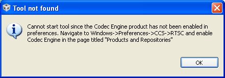

Cannot run the Genserver Wizard in CCS4.2.3

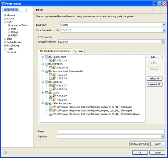

I'm running CCS in Windows.  My Windows-->Preferences-->CCS-->RTSC Settings:
I click on Tools-->Codec Engine Tools-->Genserver, and I get:

  • GenServer is not supported in that release of Codec Engine.  Bummer that you don't get a better error msg.
    CE 3.20.* only supports BIOS 6 (no Linux), and only 1) local codecs or 2) remote codecs on homogenous multicore processors (like C6472).  In the local codec case, there isn't a Server (so no need for GenServer!).  In the homogeneous multicore case, we just don't have GenServer wizard support for those devices.

  • I'm not trying to run a local codec, but a remote one on the DSP using iUniversal.  I am running on the c6a8168.  Which version of Codec Engine should I be using?  EZSDK came with 3.21 which is not yet in general release.  I tried the latest version 2 of Codec Engine, but support for the c6a8168 was missing.  If I cannot run the Genserver wizard, is there an example of a remote server, codec running on the DSP controlled by linux, that I may copy?  Or, on the other hand, are you saying that I cannot use Codec Engine to run DSP code controlled by the ARM running Linux, and I have to develop using Syslink?

  • You should use the version of CE included in the SDK - something in the 3.21.* family.  CE 3.21 is not yet GA (Generally Available - implying production quality), meaning it's still under development.  But pre-releases for new devices (like C6A8168) have been made available via the EZSDK releases.
    From other posts, I _think_ the EZSDK is using CE 3.21.00.02_eng, which is an EA (Early Adopter) release which I don't think had GenServer support for the 8168 parts.  We added that in a later CE build.  You certainly can run DSP code controlled by the ARM running Linux using that release of CE.
    Yes, there is an example server in the codec_engine_<ver>/examples/ti/sdo/ce/examples/servers/all_codecs directory that you can start from.  That's a very general example, with tons of copy codecs and support for lots of different devices, so it's not as nice-and-concise as GenServer would have done for you... but it's something to start from.
