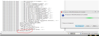

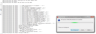

Connection to R5_0_0 looks ok:

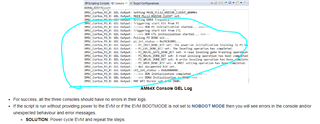

Executing script "AM24_DDR_Initialization_ECC_Disabled"
Here is a screen shot of console showing where the script stalls:
The above is from a PC with Win7 OS.
I have tried the same sequence on a Win10 PC with the same results.

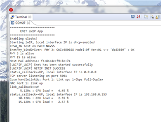

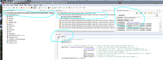

    Yes, I have been using SBL_NULL.  Below is a screen shot of output from hello_world example for EVM (not LP) including serial terminal window indicating proper operation of the boot loader and the example:
    As you can see, it loads and runs as expected.  (This example does not use DDR4 memory)

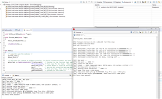

    Following is an attempt to load the "enet_lwip_cpsw_am243x-evm_r5fss0-0_freertos_ti-arm-clang" example which does use DDR4 memory
    The console shows that the problem is writing to memory at 0x80000000.  This is ddr memory.
    linker.cmd line 144.
        DDR       : ORIGIN = 0x80000000 , LENGTH = 0x1000000
    So, is the DDR4 memory initialized by the boot loader and if it is, why does this example fail?
    Thanks in advance,
           Joel

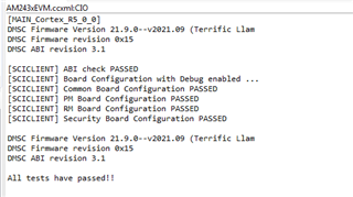

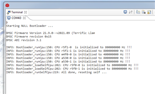

  • Hi Joel,
    I am positive that the DDR initialization is done in SBL_NULL. One way to verify it is that use "memory browser" to read/write to 0x80000000 manually after connect to R5F_0_0 core.
    I also verified the "enet_lwip_cpsw_am243x-evm_r5fss0-0_freertos_ti-arm-clang" example on AM243x EVM. It builds, loads and runs fine on AM243x EVM. Are you using the SBL_ NULL from the mcu_plus_sdk_am243x_08_01_00_36\examples\drivers\boot\sbl_null\am243x-evm\r5fss0-0_nortos\ti-arm-clang\tiboot3.bin?
    Looks like you are using the older SBL_NULL. Here is my UART display for the SBL_NULL:
    Starting NULL Bootloader ...
    DMSC Firmware Version 21.9.0--v2021.09 (Terrific Llam
    DMSC Firmware revision 0x15
    DMSC ABI revision 3.1
    INFO: Bootloader_runCpu:150: CPU r5f1-0 is initialized to 800000000 Hz !!!
    INFO: Bootloader_runCpu:150: CPU r5f1-1 is initialized to 800000000 Hz !!!
    INFO: Bootloader_runCpu:150: CPU m4f0-0 is initialized to 400000000 Hz !!!
    INFO: Bootloader_runCpu:150: CPU a530-0 is initialized to 800000000 Hz !!!
    INFO: Bootloader_runCpu:150: CPU a530-1 is initialized to 800000000 Hz !!!
    INFO: Bootloader_loadSelfCpu:202: CPU r5f0-0 is initialized to 800000000 Hz !!!
    INFO: Bootloader_loadSelfCpu:202: CPU r5f0-1 is initialized to 800000000 Hz !!!
    INFO: Bootloader_runSelfCpu:219: All done, reseting self ...

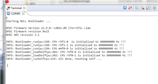

  • Hi Ming,
    I tried flashing the SBL_NULL bootloader as you indicated in a previous post.  (following the instructions here: https://software-dl.ti.com/mcu-plus-sdk/esd/AM64X/08_01_00_36/exports/docs/api_guide_am64x/EVM_SETUP_PAGE.html#EVM_FLASH_SOC_INIT
    These instructions were for AM64x EVM but I have AM243x EVM so I flashed the bootloader using the configuration found here:
    C:\ti\mcu_plus_sdk_am243x_08_01_00_36\tools\boot\sbl_prebuilt\am243x-evm\default_sbl_null.cfg
    Here is a screen shot of the results:
    After switching boot mode back to OSPI and powering the board I see this on the serial port:

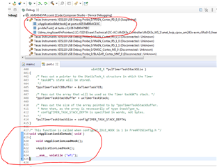

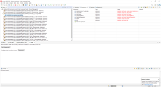

    I attempted to load the "enet_lwip_cpsw_am243x-evm_r5fss0-0_freertos_ti-arm-clang.out" example which failed in the same manner as previously.
    Next I attempted to use the memory browser as you suggested.  Memory writes to 0x80000000 failed (screen shot below):
    Attempts to write to address in the 0x70000000 range were successful (Specifically writes to 0x70080000 and 0x70080004)
    Please note that I am using mcu_plus_sdk_am243x_08_01_00_36.

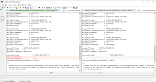

    "Are you using the SBL_ NULL from the mcu_plus_sdk_am243x_08_01_00_36\examples\drivers\boot\sbl_null\am243x-evm\r5fss0-0_nortos\ti-arm-clang\tiboot3.bin?"
    So I loaded that binary file (tiboot3.bin)
    This was successful but memory browser still fails to write to DDR memory.

  • Hi Ming,
    Thanks again for your suggestion.  I copied the file to the SD card, changed the boot mode, and power up the EVM.  The results are the same as UART boot.  Same message on serial console and still cannot r/w to DDR memory at 0x80000000.  Just to make sure that the board is booting from SD I removed the card and powered up the board.  Result: no boot message on serial console.  Next I reinserted the SD card & powered up.  Boot message appears as expected but still no R/W of DDR.
    Thought I'd try something different.  I booted from SD card, connected to DMSC (cortex M3) then connected cortex R5_0_0. (possibly I connected R5 before M3, Can't remember which came first but probably R5 was first)
      Next I tried to R/W 0x80000000.  This time it worked. I could modify DDR memory.  See screen shot below.
    Console output when connecting M3:

    Here is a screen shot of R/W to DDR (also showing debug connections):
    At this point I tried to load the example application's .out file.  This failed and I had to reset and reboot.
    Reading and writing DDR only worked one time.  Since then I have not been able to duplicate this ability to R/W DDR.
    Still hoping that you can come up with a solution.

  • Hi Ming,
    I retried the steps you suggested from the API guide. The results:
    The DDR initialization script hangs at the same point as originally reported in my first post about this question on 10 Dec.  (see above)
    Note that this time I have not connected DMSC Cortex M3.  The reason I had previously tried connecting the DMSC was your response to a question raised by Krasi Gichev. Here is a link to that question:
    https://e2e.ti.com/support/processors-group/processors/f/processors-forum/1023345/tmds243gpevm-ddr4-init-fails-on-am243x-gpevm/3783148?tisearch=e2e-sitesearch&keymatch=%25252520user%2525253A86242#3783148
    Following this advice to connect the DMSC processor used to work.  I could actually download into DDR memory.  At the time I was using mcu_plus_sdk_am243x_08_01_00_14.  The problem with GEL script hanging started when I ugraded to   mcu_plus_sdk_am243x_08_01_00_36 and at the same time upgraded the Sitara support package to the latest.  Since then the DDR initialization script always hangs.
    Your thoughts would be appreciated.

  • Hi Joel,
    As a last resort, you may want to try to use the CCS script to initialize the EVM and DDR, although it is not a recommended way:
    AM64x MCU+ SDK: EVM Setup (ti.com)

  • Hi Ming,
    I have tried your 'Last Resort' solution with the following results:
    1. Set environment variable
    2.  Run the script.  Here are the various consoles:
    Scripting Console:
    Target Configuration CIO:
    Target Configuration:

    Note here that the screen shot found in AM64x MCU+ SDK: EVM Setup shows DDR initialization of the being performed by the CCS script (below) but the output I see here is as above with no DDR init:
    Continuing on  with the suggestion I next run the AM24_DDR_Initialization_ECC_Disabled script.
    Note that it hangs at the same point as previous attempts/suggestions:
    As you can see, this problem has not been resolved.  I'll repeat the clue I mentioned in a previous reply (18-12-2021):

    I checked the difference between the 08.01.00.14/tools and 08.01.00.36/tools, the only difference is the MCU+ SDK install path and the SYSFW. If that is the problem, then you can use the 08.01.00.14/tools for launch_dmsc.js for now.
    The issue is I cannot reproduce the same error on my board and the 08.01.00.36.

    I finally figured out the root cause of the DDR initialization issue you reported.
    The SBL_NULL for AM243x EVM and AM64x EVM are different, while the sbl_null_am64x-evm_r5fss0-0_nortos_ti-arm-clang does have the DDR initialization included and the sbl_null_am243x-evm_r5fss0-0_nortos_ti-arm-clang DOES NOT have the DDR initialization. That is why the sbl_null.release.tiimage (tiboot3.bin) in C:\ti\mcu_plus_sdk_am64x_08_01_00_36\tools\boot\sbl_prebuilt\am64x-evm\ made the DDR working. The sbl_null.release.tiimage (tiboot3.bin) in C:\ti\mcu_plus_sdk_am243x_08_01_00_36\tools\boot\sbl_prebuilt\am243x-evm\ does not make the DDR working.
    I will file a bug against the SBL_NULL for AM243x EVM. At the same time, you can use the sbl_null.release.tiimage (tiboot3.bin) from MCU+ SDK 08.01.00.36 for OSPI or SD boot. This is a workaround and I have verified it on AM243x EVM.

  • Well, this is progress but still some questions.  I flashed OSPI with C:\ti\mcu_plus_sdk_am64x_08_01_00_36\tools\boot\sbl_prebuilt\am64x-evm\sbl_null.release.tiimage.  Subsequently booting from OSPI results in this output on the terminal:
    All good so far, AM64 bootloader runs on AM243x board.  Next (without running the DDR init script) I try filling the first 10 words of DDR memory with 0xa5a5a5a5. This  is successful in spite of the console output indicating that I should run the script:
    Next I load the project output (.out file).  This looks to be successful:
    After running the application there is no output on the terminal screen so I suspend execution on R5_0_0 with this result:
    So, it looks like the DDR4 memory is initialized by the boot but gel file is reporting it as not initialized.  Also, DDR4 memory is working.  However, the example application is not working properly with the expected output on the terminal window.

  • Hi Joel,
    I will still use the examples from the MCU+ SDK 08.01.00.36 for AM243x. The reason to use the BSL_NULL from AM64x is just a workaround for DDR initialization. It seems working OK, at least you can access the DDR without using GEL file. Since you are using the SBL_NULL from OSPI flash, so you do not have to use any GEL file for R5F_0_0 core nor the launch_dmsc.js anymore. You can delete the GEL file from the R5F_0_0. After the CCS target configuration file launch, you can connect to R5F_0_0 directly (no need to connect to DMSC first or run launch_dmsc.js from script console.
    then load your application code directly.
    From your screen capture, it looks like your code is FreeRTOS based and the idle task is running when you halt R5F_0_0 core. You can single step through your application code and make sure your code is running OK. You can also use the "Tools" --> "Runtime Object View" to look in the task status, interrupts and semaphores etc. in CCS.
    The other way is to enable the CCS log (in Debug Log of example.syscfg) to confirm you application is running correctly.

    I tried using the AM64x EVM example on the AM243x EVM board as you suggested.  Good news, it linked and DHCP assigned an IP address.  However there still seems to be a problem.  I tried pinging the EVM board with the following results:
    For comparison I loaded up my LP board with the same example with the following results:
    Note that this was a side by side comparison.  I used the same cat6 cable connected to the same ethernet switch connection. Both boards were powered and executing the example code at the same time.  I just pinged the EVM board, moved the cable to the LP board and pinged it.
    Any ideas why the the erratic performance?
         Joel
