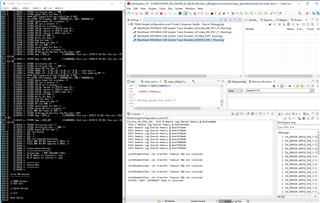

Hi team,
Customers can download the TDA3x firmware on their own development board either by CCS or QSPI. And here are now some questions about the output and configuration selection of the serial port being initiated in two ways:
1. Load From CCS:
Refer to VisionSDK_UserGuide_TDA3xx.pdf, after downloading and running the cores via CCS, the serial port has the output and configuration options for Usecases are shown in the following figure. But the customer cannot to choose these options and cannot to select the use cases or system configuration that needs to be run, the log of the serial output is shown in the diagram, and there is a "src/bsp_deviceI2c.c @ Line 667:
[IPU1-0] 41.161532 s: I2C0: DEV 0x20: ERROR !!!
[IPU1-0] 41.161623 s: src/bsp_deviceI2c.c @ Line 689:
[IPU1-0] 41.161715 s: I2C0: Error timeout 5000 ms!!!
[IPU1-0] 41.161776 s: src/bsp_boardTda3xx.c @ Line 2535:
[IPU1-0] 41.161867 s: I2C write failed!!

The customer would like to confirm if these problems preventing the serial port from being configured for selection, and how to modify it?
?鳾IPU1-0] 19.468187 s: ***** IPU1_0 Firmware build time 13:31:39 Nov 17 2021

[IPU1-0] 52.165558 s: QSPI Init Started
[IPU1-0] 52.165741 s: MID - 0
[IPU1-0] 52.165802 s: DID - 0
[IPU1-0] 52.165832 s: QSPI Init Completed Sucessfully
[IPU1-0] 52.168334 s: UTILS: DMM: API NOT supported in TDA3xx !!!
[IPU1-0] 52.168425 s: UTILS: DMM: API NOT supported in TDA3xx !!!
[IPU1-0] 52.168944 s:
[IPU1-0] 52.169005 s: Current System Settings,
[IPU1-0] 52.169066 s: ========================
[IPU1-0] 52.169096 s: Display Type : HDMI 1920x1080 @ 60fps
[IPU1-0] 52.169188 s: My IP address for interface 1 : none
[IPU1-0] 52.169249 s: My IP address for interface 2 : none
[IPU1-0] 52.169310 s:
[IPU1-0] 52.169340 s: ============
[IPU1-0] 52.169371 s: Usecase Menu
[IPU1-0] 52.169432 s: ============
[IPU1-0] 52.169462 s:
[IPU1-0]
[IPU1-0] Vision SDK Usecases,
[IPU1-0] --------------------
[IPU1-0]
[IPU1-0] 1: RADAR Usecases
[IPU1-0] 2: MISC Tests
[IPU1-0]
[IPU1-0] s: System Settings
[IPU1-0]
[IPU1-0] x: Exit
[IPU1-0]
[IPU1-0] Enter Choice:
[IPU1-0]
