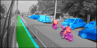

  • Hi Takuma Fujiwara, thank you for ur reply so much.
        Before, we use xxx_net.bin & xxx_io.bin offloaded by python version script onnxrt_ep.py&utils.py as the input of vision_apps/vx_app_tidl_seg.out. But getting so bad segmentation result.
        Later, i directly use tidl importer from PSDK-RTOS and setting the 'mean' and 'std' value like below(must set inDataNorm 1):
    inDataNorm  = 1
    inMean = 128.00 128.00 128.00
    inScale = 0.015625 0.015625 0.015625
        then use the xxx_net.bin & xxx_io.bin as input, then i get similar result compare with PC emulation.
        So, i wonder if onnxrt_ep.py could set the inDataNorm=1 ?
    or i can just use tidl importer if i work on PSDK-Linux + PSDK+RTOS?
        segmentation result with tidl importer:
    Best wishes!
