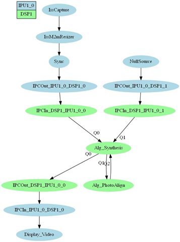

  • Expected execution function: Chains_issMultCaptIspDewarp3dSv_Display
    ucSrvOutMode choose:
        ALGORITHM_LINK_SRV_OUTPUT_2D_LDC
        ALGORITHM_LINK_SRV_OUTPUT_3D_LDC
    And modify the link to directly capture YUV data from the sensor.
    Is it feasible to regenerate the ISS usecase as follows?
    Thanks in advance.
  • Hi Wu BoHan,
    There is existing 2D and 3D SRV usecase in the vision sdk on TDA3xx, using LDC. Could you please refer to them and make similar usecase for your sensor?
    Brijesh
  • Are my chains correct?
    Modify the link to directly capture YUV data from the sensor.
    And ucSrvOutMode choose ALGORITHM_LINK_SRV_OUTPUT_2D_LDC.
    Thanks in advance.
  • It looks to be correct. But not sure what is the usage of NullSource here?
    Rgds,
    Brijesh
  • But not sure what is the usage of NullSource here?
    I have no idea
    I am a reference: usecases\iss_mult_capture_isp_dewarp_3dsv_tda3xx (ALGORITHM_LINK_SRV_OUTPUT_2D_LDC)
    with ISP linkes (+AEWB) removed..
    Could you please give some suggestions here?
    Thanks.
  • The modified chains execution did not see the camera image.
    Print Statistics is as follows:
    [IPU1-0] 231.888854 s: ### CPU [IPU1-0], LinkID [ 81],
    [IPU1-0] 231.888916 s:
    [IPU1-0] 231.889038 s: [ ISSCAPTURE ] Link Statistics,

    [IPU1-0] 231.891783 s: ### CPU [IPU1-0], LinkID [ 96],
    [IPU1-0] 231.891844 s:
    [IPU1-0] 231.891905 s: [ ISS Resizer ] Link Statistics,

    [IPU1-0] 231.895199 s: ### CPU [IPU1-0], LinkID [ 34],
    [IPU1-0] 231.895290 s:
    [IPU1-0] 231.895321 s: [ SYNC_0 ] Link Statistics,

    [IPU1-0] 232.899621 s:
    [IPU1-0] 232.899682 s: ### CPU [IPU1-0], LinkID [ 57],
    [IPU1-0] 232.899743 s:
    [IPU1-0] 232.899774 s: [ NULL_SRC ] Link Statistics,

    Please tell me if the chain is correct?
    Thanks.
    The sync link is dropping all the frames, what are the parameters you are using for the sync link?

    Brijesh
    I checked back and found that my Sync was not configured.
    According to the original Sync_dewarpPrm configuration, the results are as follows:
    Void chains_issMultCaptIspDeWarp3dSv_SetAppPrms
        ChainsCommon_SurroundView_SetSyncPrm(&pUcObj->SyncPrm, pObj->numCh, 1); /* 1: Tight Sync */
        setSyncParams(&pUcObj->SyncPrm, pObj->numCh, 35U);

    Thanks.
  • But now resizer is dropping the frames, what changes did you do? Earlier resizer was working fine, it was just sync link which was dropping the frames.. Can you revert the changes and set the configuration for the sync link correctly?
    Brijesh
  • Only add the sync configuration.
    How can I check?
  • With the same configuration, the chains are changed to the 'Null' test, and the results are as follows:
    Is this method sufficient to prove that link configuration is correct?

    [IPU1-0] 98.287988 s:
    [IPU1-0] 98.288019 s: Input Statistics,
    [IPU1-0] 98.288080 s:
    [IPU1-0] 98.288110 s: CH | In Recv | In Drop | In User Drop | In Process
    [IPU1-0] 98.288202 s: | FPS | FPS | FPS | FPS
    [IPU1-0] 98.288263 s: --------------------------------------------------
    [IPU1-0] 98.288385 s: 0 | 29.98 0. 0 0. 0 29.98
    [IPU1-0] 98.288537 s: 1 | 30. 0 0. 0 0. 0 30. 0
    [IPU1-0] 98.288690 s: 2 | 30. 0 0. 0 0. 0 30. 0
    [IPU1-0] 98.288873 s: 3 | 30. 0 0. 0 0. 0 30. 0
    [IPU1-0] 98.288995 s:
    [IPU1-0] 98.289056 s: Output Statistics,
    [IPU1-0] 98.289086 s:
    [IPU1-0] 98.289117 s: CH | Out | Out | Out Drop | Out User Drop
    [IPU1-0] 98.289208 s: | ID | FPS | FPS | FPS
    [IPU1-0] 98.289269 s: ---------------------------------------------
    [IPU1-0] 98.289361 s: 0 | 0 30. 0 0. 0 0. 0
    [IPU1-0] 98.289483 s: 1 | 0 30. 0 0. 0 0. 0
    [IPU1-0] 98.289605 s: 2 | 0 30. 0 0. 0 0. 0
    [IPU1-0] 98.289727 s: 3 | 0 30. 0 0. 0 0. 0
    [IPU1-0] 98.289849 s:
    [IPU1-0] 98.289879 s: [ ISSCAPTURE ] LATENCY,
    [IPU1-0] 98.289940 s: ********************
    [IPU1-0] 98.290001 s:
    [IPU1-0] 98.290093 s:
    [IPU1-0] 98.290154 s: ### CPU [IPU1-0], LinkID [ 96],
    [IPU1-0] 98.290215 s:
    [IPU1-0] 98.290245 s: [ ISS Resizer ] Link Statistics,
    [IPU1-0] 98.290337 s: ******************************
    [IPU1-0] 98.290398 s:
    [IPU1-0] 98.290428 s: Elapsed time = 48027 msec
    [IPU1-0] 98.290489 s:
    [IPU1-0] 98.290550 s: New data Recv = 120.1 fps
    [IPU1-0] 98.290855 s: Get Full Buf Cb = 150.29 fps
    [IPU1-0] 98.290947 s: Put Empty Buf Cb = 29.98 fps
    [IPU1-0] 98.291008 s: Driver/Notify Cb = 119.99 fps
    [IPU1-0] 98.291099 s:
    [IPU1-0] 98.291130 s: Input Statistics,
    [IPU1-0] 98.291191 s:
    [IPU1-0] 98.291221 s: CH | In Recv | In Drop | In User Drop | In Process
    [IPU1-0] 98.291313 s: | FPS | FPS | FPS | FPS
    [IPU1-0] 98.291374 s: --------------------------------------------------
    [IPU1-0] 98.291465 s: 0 | 30. 0 0. 0 0. 0 29.98
    [IPU1-0] 98.291618 s: 1 | 30. 0 0. 0 0. 0 30. 0
    [IPU1-0] 98.292167 s: 2 | 30. 0 0. 0 0. 0 30. 0
    [IPU1-0] 98.292289 s: 3 | 30. 0 0. 0 0. 0 30. 0
    [IPU1-0] 98.292441 s:
    [IPU1-0] 98.292472 s: Output Statistics,
    [IPU1-0] 98.292502 s:
    [IPU1-0] 98.292563 s: CH | Out | Out | Out Drop | Out User Drop
    [IPU1-0] 98.292655 s: | ID | FPS | FPS | FPS
    [IPU1-0] 98.292746 s: ---------------------------------------------
    [IPU1-0] 98.292807 s: 0 | 0 29.98 0. 0 0. 0
    [IPU1-0] 98.292929 s: 1 | 0 30. 0 0. 0 0. 0
    [IPU1-0] 98.293051 s: 2 | 0 30. 0 0. 0 0. 0
    [IPU1-0] 98.293173 s: 3 | 0 30. 0 0. 0 0. 0
    [IPU1-0] 98.293265 s:
    [IPU1-0] 98.293326 s: [ ISS Resizer ] LATENCY,
    [IPU1-0] 98.293356 s: ********************
    [IPU1-0] 98.293417 s: Local Link Latency : Avg = 5075 us, Min = 5032 us, Max = 5429 us,
    [IPU1-0] 98.294149 s: Source to Link Latency : Avg = 5981 us, Min = 5124 us, Max = 8784 us,
    [IPU1-0] 98.294302 s:
    [IPU1-0] 98.294393 s:
    [IPU1-0] 98.294454 s: ### CPU [IPU1-0], LinkID [ 34],
    [IPU1-0] 98.294515 s:
    [IPU1-0] 98.294607 s: [ SYNC_0 ] Link Statistics,
    [IPU1-0] 98.294668 s: ******************************
    [IPU1-0] 98.294759 s:
    [IPU1-0] 98.294790 s: Elapsed time = 48026 msec
    [IPU1-0] 98.294851 s:
    [IPU1-0] 98.294881 s: New data Recv = 150.31 fps
    [IPU1-0] 98.294973 s: Get Full Buf Cb = 30.0 fps
    [IPU1-0] 98.295034 s: Put Empty Buf Cb = 30.0 fps
    [IPU1-0] 98.295125 s: Driver/Notify Cb = 30.29 fps
    [IPU1-0] 98.295186 s:
    [IPU1-0] 98.295217 s: Input Statistics,
    [IPU1-0] 98.295278 s:
    [IPU1-0] 98.295308 s: CH | In Recv | In Drop | In User Drop | In Process
    [IPU1-0] 98.295400 s: | FPS | FPS | FPS | FPS
    [IPU1-0] 98.295461 s: --------------------------------------------------
    [IPU1-0] 98.295552 s: 0 | 30. 0 0. 0 0. 0 30. 0
    [IPU1-0] 98.295857 s: 1 | 30. 0 0. 0 0. 0 30. 0
    [IPU1-0] 98.296010 s: 2 | 30. 0 0. 0 0. 0 30. 0
    [IPU1-0] 98.296132 s: 3 | 30. 0 0. 0 0. 0 30. 0
    [IPU1-0] 98.296254 s:
    [IPU1-0] 98.296284 s: Output Statistics,
    [IPU1-0] 98.296346 s:
    [IPU1-0] 98.296376 s: CH | Out | Out | Out Drop | Out User Drop
    [IPU1-0] 98.296468 s: | ID | FPS | FPS | FPS
    [IPU1-0] 98.296529 s: ---------------------------------------------
    [IPU1-0] 98.296620 s: 0 | 0 30. 0 0. 0 0. 0
    [IPU1-0] 98.296742 s:
    [IPU1-0] 98.296803 s: [ SYNC_0 ] LATENCY,
    [IPU1-0] 98.296834 s: ********************
    [IPU1-0] 98.296895 s: Local Link Latency : Avg = 10869 us, Min = 30 us, Max = 26505 us,
    [IPU1-0] 98.297017 s: Source to Link Latency : Avg = 16977 us, Min = 16242 us, Max = 17889 us,
    [IPU1-0] 98.297139 s:
    [IPU1-0] 98.297230 s:
    [IPU1-0] 98.297291 s: ### CPU [IPU1-0], LinkID [ 20],
    [IPU1-0] 98.297352 s:
    [IPU1-0] 98.297413 s: [ NULL ] Link Statistics,
    [IPU1-0] 98.297474 s: ******************************
    [IPU1-0] 98.297505 s:
    [IPU1-0] 98.297566 s: Elapsed time = 48004 msec
    [IPU1-0] 98.297657 s:
    [IPU1-0] 98.297688 s: New data Recv = 30.1 fps
    [IPU1-0] 98.297749 s:
    [IPU1-0] 98.297810 s: Input Statistics,
    [IPU1-0] 98.297840 s:
    [IPU1-0] 98.297901 s: CH | In Recv | In Drop | In User Drop | In Process
    [IPU1-0] 98.297962 s: | FPS | FPS | FPS | FPS
    [IPU1-0] 98.298054 s: --------------------------------------------------
    [IPU1-0] 98.298115 s: 0 | 30. 1 0. 0 0. 0 0. 0
    [IPU1-0] 98.298237 s:
    [IPU1-0] 98.298298 s: Output Statistics,
    [IPU1-0] 98.298328 s:
    [IPU1-0] 98.298389 s: CH | Out | Out | Out Drop | Out User Drop
    [IPU1-0] 98.298450 s: | ID | FPS | FPS | FPS
    [IPU1-0] 98.298511 s: ---------------------------------------------
    [IPU1-0] 98.298603 s:
    [IPU1-0] 98.298664 s: [ NULL ] LATENCY,
    [IPU1-0] 98.298725 s: ********************
    [IPU1-0] 98.298755 s:
    [IPU1-0] 98.798633 s: CPU [ IPU1-0], LinkID [ 23], Link Statistics not available !
    [IPU1-0] 98.799060 s:
    [IPU1-0] 98.799091 s: ### CPU [IPU1-0], LinkID [ 72],
    [IPU1-0] 98.799152 s:
    [IPU1-0] 98.799213 s: [ DISPLAY ] Link Statistics,
    [IPU1-0] 98.799274 s: ******************************
    [IPU1-0] 98.799335 s:
    [IPU1-0] 98.799365 s: Elapsed time = 78252 msec
    [IPU1-0] 98.799426 s:
    [IPU1-0] 98.799457 s: Driver/Notify Cb = 30.0 fps
    [IPU1-0] 98.799548 s:
    [IPU1-0] 98.799579 s: Input Statistics,
    [IPU1-0] 98.799670 s:
    [IPU1-0] 98.799701 s: CH | In Recv | In Drop | In User Drop | In Process
    [IPU1-0] 98.799762 s: | FPS | FPS | FPS | FPS
    [IPU1-0] 98.799853 s: --------------------------------------------------
    [IPU1-0] 98.799914 s: 0 | 0. 1 0. 0 0. 0 0. 1
    [IPU1-0] 98.800036 s:
    [IPU1-0] 98.800097 s: [ DISPLAY ] LATENCY,
    [IPU1-0] 98.800128 s: ********************
    [IPU1-0] 98.800189 s: Local Link Latency : Avg = 31 us, Min = 31 us, Max = 31 us,
    [IPU1-0] 98.800311 s: Source to Link Latency : Avg = 13329 us, Min = 13329 us, Max = 13329 us,
    [IPU1-0] 98.800433 s:
    [IPU1-0] 98.800463 s: Display UnderFlow Count = 0
    Thanks.
    No, NULL link gives out the same frames multiples times and all of them are always in sync. Whereas, in multi-channel capture, camera may not be in sync. so there could be a difference at max 33ms (assuming 30fps) amount frames captured from multiple cameras. You would need to set the sync threshold to 40ms when capture is from camera...
    Brijesh
