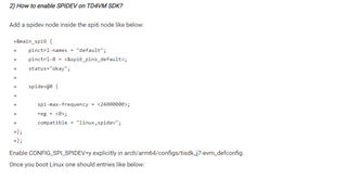

Hi team,
I am referring
https://e2e.ti.com/support/processors-group/processors/f/processors-forum/947437/faq-ccs-tda4vm-how-to-use-spi-spi_dev-on-tda4-j721e
I have made the changes as per the suggestion,successfully crested the instance but couldn't enable the SPIDEV.
root@j7-evm:/sys/class# ls
backlight devfreq gpio iommu misc pci_epc regulator scsi_host tpmrm vc watchdog
bdi dma graphics k3_udma_glue_chan mmc_host phy remoteproc sound tty vfio
block dma_heap hwmon leds mtd power_supply rpmsg spi_master ubi video4linux
bsg drm i2c-adapter mbox mux pps rtc tee udc virtio-ports
chromeos extcon i2c-dev mdio_bus net ptp scsi_device thermal uio vtconsole
devcoredump fpga_manager input mem pci_bus pwm scsi_disk tpm usb_role wakeup
root@j7-evm:/sys/class# ls -l /sys/class/spi*
total 0
lrwxrwxrwx 1 root root 0 Apr 10 00:05 spi6 -> ../../devices/platform/bus@100000/2160000.spi/spi_master/spi6
lrwxrwxrwx 1 root root 0 Apr 10 00:05 spi7 -> ../../devices/platform/bus@100000/bus@100000:bus@28380000/47000000.fss/47040000.spi/spi_master/s7
lrwxrwxrwx 1 root root 0 Apr 10 00:05 spi8 -> ../../devices/platform/bus@100000/bus@100000:bus@28380000/47000000.fss/47050000.spi/spi_master/s8
After trying to run spidev_test I got following error.
/spidev_test -v -D /dev/spidev6.0
can't open device: No such file or directory
[ 111.593732] systemd-coredump[1138]: Failed to get COMM: No such process
Aborted (core dumped)
board-j721e_evm
SDK-ti-processor-sdk-linux-j7-evm-07_03_00_05
can anyone guide me.what I am missing?
  • lrwxrwxrwx 1 root root 0 Apr 10 00:05 spi6 -> ../../devices/platform/bus@100000/2160000.spi/spi_master/spi6
    I do not see spidev entry here.
    One of the below might be missing:
    Double check that.
    Also share the complete boot logs from SPL till you reach Linux command prompt.

  • Hi Keerthy,
    Thanks for your quick reply!!
    I double check addition of SPIDEV, as per my understanding I added the node in "k3-j721e-common-proc-board.dts".
    please correct me if I am wrong.
    I have attached the complete log,please fined the attachment.

  • Hi Tanvi,
    Can you try the below change:
    +&main_spi6 {
    + pinctrl-names = "default";
    + pinctrl-0 = <&spi6_pins_default>;
    + status="okay";
    + spidev@0 {
    + spi-max-frequency = <24000000>;
    + reg = <0>;
    + compatible = "spidev";
    In the FAQ the compatible is linux,spidev.
    Can you please make that one line change and let me know if that works for you?
    If yes please click on verify answer.
    Keerthy
  • Hi Keerthy,
    no luck yet.
    changes are made in "k3-j721e-common-proc-board.dts" as per your suggestion.
    attached is complete log after making changes.

    Tanvi
  • Hi Tanvi,
    I followed the FAQ exactly:

    root@j7-evm:~# cat /sys/class/spi*
    cat: /sys/class/spi_master: Is a directory
    cat: /sys/class/spidev: Is a directory
    root@j7-evm:~# ls /sys/class/spi*
    spi0  spi1  spi2
    /sys/class/spidev:
    spidev0.0
    root@j7-evm:~#
    Just double check on your .config file under $SDK_PATH/board-support/linux* directory.
    Changes in the file arch/arm64/configs/tisdk_j7-evm_defconfig
    #CONFIG_SPI_SPIDEV is not set
    should be changed to
    CONFIG_SPI_SPIDEV=y
    Please double check at your end. This should be straight forward.
