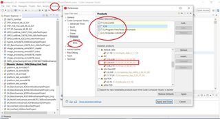

    Step 1: Download this ipcdev-3.50.04.07.zip  from the link I have provided.
    Step 2: Install in c:\ti - folder
    Step 3: In CCS, go to window option--> preferences --> code compoer --> RTSC--> products on the right--> products discovery path -- > add .07 IPC
    Step 4 : close.
    ----> Now Go to project properties-->general-->products (next-to-project) and select the IPC version IPC-3.50.4.07.
    Shankari G

  • Hi
    Step3:
    In the product discovery path use "add option" and locate the path, where you installed,  IPC version 3.50.4.07 .
    -Shankari G

  • Dear Shankari G
    sorry for letting you know so late.
    I tried the solution you provided for few times however I am afraid to say it didn't work.
    so what I did was to just download older version of PDK that contains IPC version 3.50.4.07 and install it.
    I hope that it would be helpful if you receive similar question from someone else.
    ysshim
