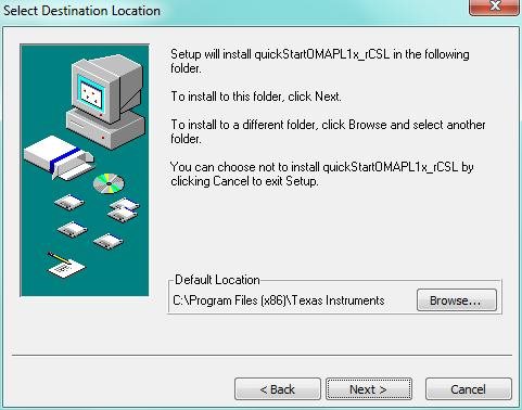

    Upon install, here is what the install wizard says.
    Perfect! This is exactly where I want it! So continue installing........ then compile....ARRRGGGHHHH!

    As you pointed out, once you changed the project path to include the (x86), which is another way (and yes, one could argue that it is simpler) to solve the path issue, you were able to rebuild the project successfully. The wizard does suggest a default install directory, (C:\Program Files\Texas Instruments\) and it tested to be correct on two different machines I have.
    Can I explain why the (x86) showed up in the wizard path on your computer? - no I can not -nor am I suggesting that you did anything wrong. I can only show you what it looks like on both of my machines today, one of which I have included below in the screen capture.
