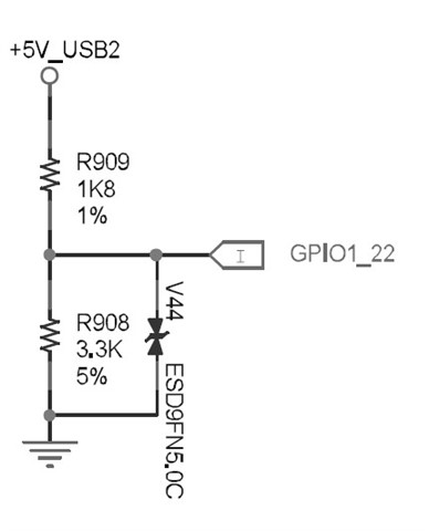

Hello Champs,
Customer designed his own am5708 board. The USB dongle can't work with USB3.0. But it can work on USB2.0
If am5708 connected to USB hub with extra power, the USB dongle can work. Besides, am3352 can work with USB dongle without connecting to extra USB hub.
He modified the HW as follows, but it doesn't help.
1. Remove USB resistor
2. Remove USB resistor + power swich
  • am5708 Linux Kernel 4.14.79 TI SDK-05.03.00.07
  • am3352 Linux Kernel 3.2.0 TI am335x-evm-sdk-src-06.00.00.00
Below is the log.

  • It looks like there are 2 USB instances being used.  Which one is experiencing the problem?  Also, can I see a schematic for the working and non-working instances?  From your description alone, it's hard to know what changes were made to the board.
  • Hi Brown
    Am5708 usb interface is not working
    Attached file is am5708 usb interface schematic.
    schematic.zip
    Daniel
  • Hi Expert,
    Could you help this issue?
    Daniel
  • Daniel,
    I'm not sure I understand the problem statement.  Can you explain this line:
    "The USB dongle can't work with USB3.0. But it can work on USB2.0"
    I don't see any superspeed data lines so I'm not sure what you mean by "can't work with USB3.0."  Do you mean it can't work with the USB Type C connector?
    Which instance is failing, USB1 or USB2?
    Does anything you plug into the bad USB instance work?
    What fails you plug it into the bad USB instance?
    What is the USB dongle? (When does the USB dongle work, and when doesn't it work?).
    What is the USB hub?
    I don't see a USB_ID detect circuit for either USB instance.  Are you implementing USB_ID detection?  Generally our customers use dedicated USBC management ICs which handle cable detection and orientation.  And speaking of orientation, what are you connecting to the USBC receptacle?  Is it a device with a cable?  Or is it a device with a USBC male plug?
  • Hi Brown
    Device USB2 can not detect some USB 3.0 dongle when USB 3.0 dongle is plug-in.
    But Device USB2 can not detect all USB 2.0 dongle when USB 2.0 dongle is plug-in.
    USB_ID pin is GPIO1_22
    Daniel
  • Hi Zack
    Could you understand the problem statement?
    Do I have to provide the other data?
    Daniel
