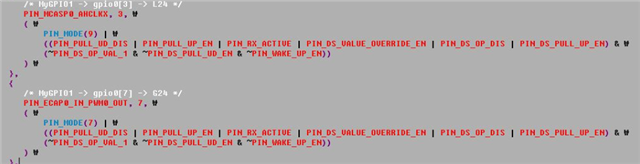

My customer set L24 pin(McASP0_AHCLKX) to GPIO0_3(EINT1), but found EINT1 was not worked when it was set as input.
When they set it as input, they found this pin was always high even at low signal input.
There was no issue and found high_log_toggle when they set it as output.
Could you please check their pin mux setting in below?
Their HW schematic is as below.
Their pinmux configuration code is as below.
