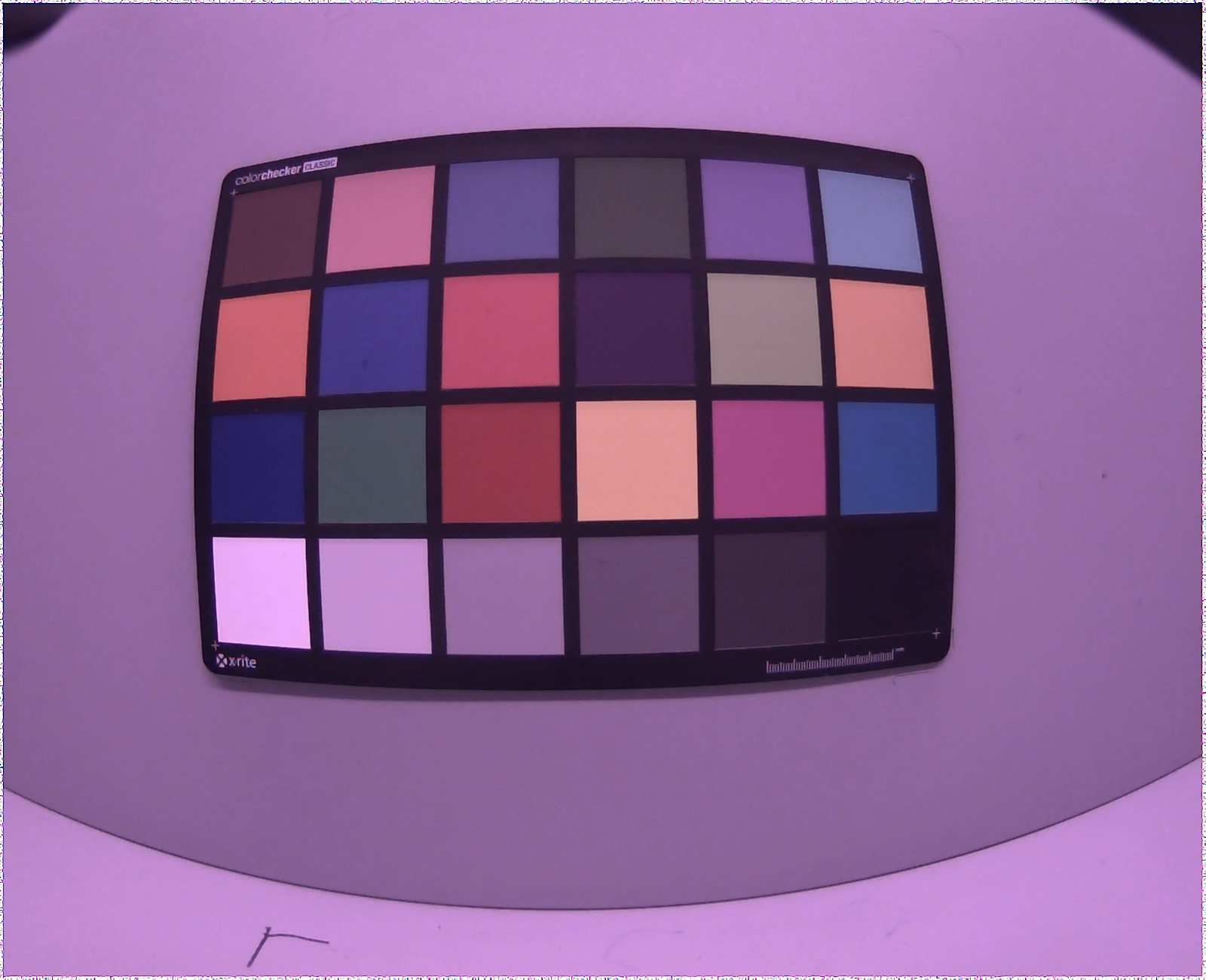

PROCESSOR-SDK-J721E: TDA4VM AWB gains applied to NSF4 WB gains causes pinkish tints in the VISS out image.
Part Number: PROCESSOR-SDK-J721E
This is with regard to the TDA4x VPAC VISS block. Build: 7.1.0 (20 Nov 2020) .
After AWB tuning, pinkish tints are visible over the entire image, as shown.
On bypassing the NSF4 block, the white balance is restored.
Above are the respective VISS out images, with NSF4 enabled and bypassed.
Any help to restore WB with NSF4 enabled is appreciated.
