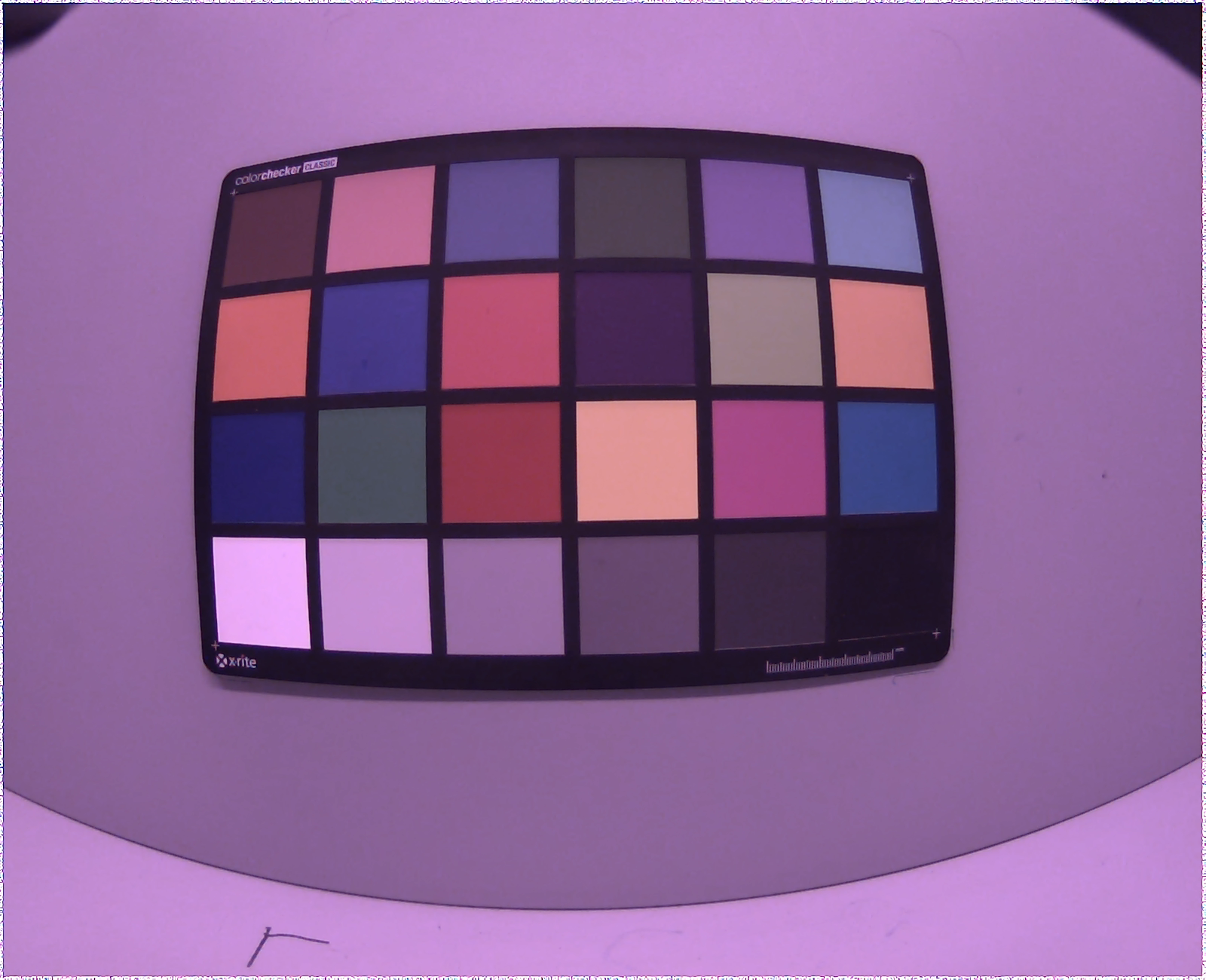

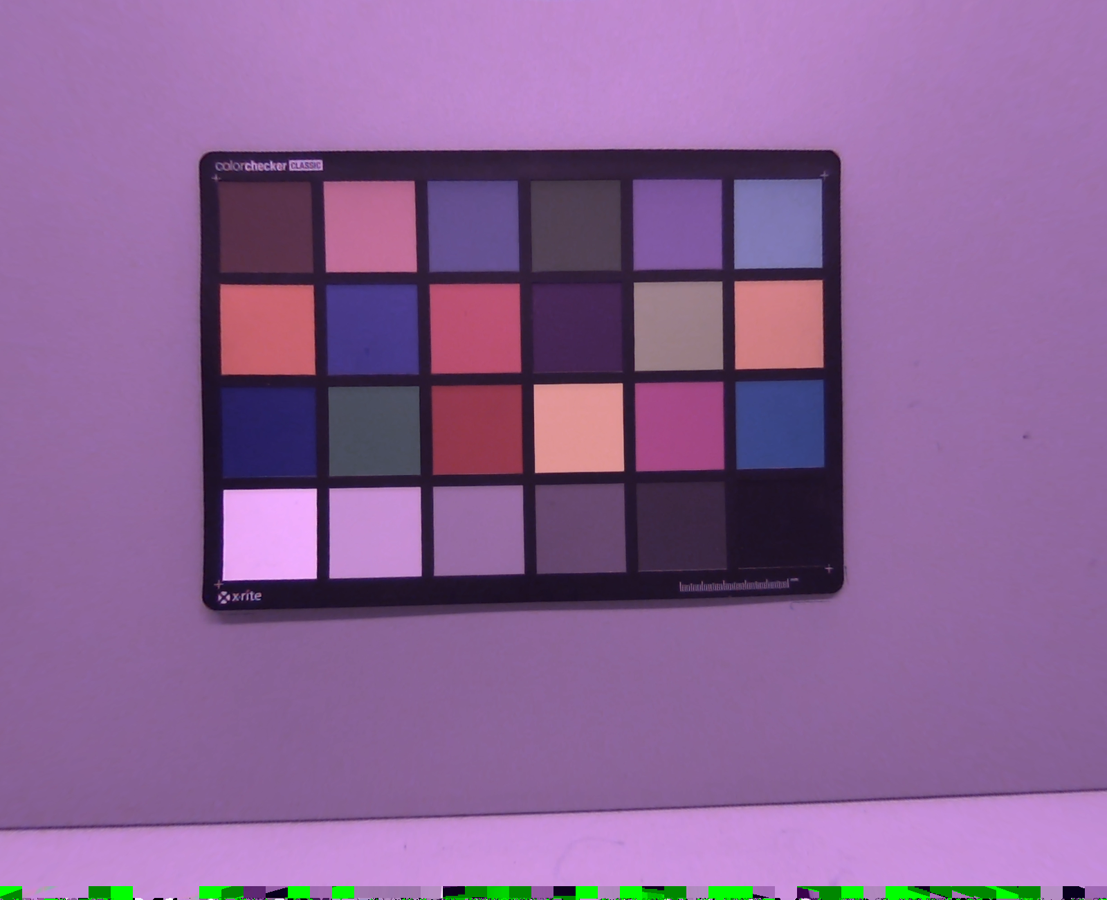

On a typical single camera pipeline, consisting of capture, VISS, LSC, MSC nodes, after tuning the LDC block, green block-like artefacts are visible on the bottom of the image.
The image size is 1600x1300.
VISS output image does not have the block artefacts.
Below are the Mesh LDC configs:

  • Hi Apeksha,
    Do you have the issue on TDA4 EVM with these output block parameters?
       32     # LDC_BLOCK_SIZE        OBW                  Output block width (0-255)
       32     # LDC_BLOCK_SIZE        OBH                  Output block height (0-255)
        0     # LDC_BLOCK_SIZE        PIXPAD               Pixel pad (0-15)
    Typically, you may use TDA4 ISP tuning tool to verify your LDC LUT and block parameters.
    Most likely, there is something wrong in your LDC LUT at the bottom row or the 32x32 block size is too large.
