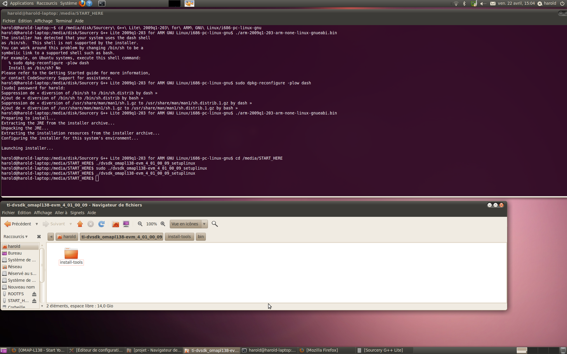

I am completely new to TI OMAP space. I install CodeSourcery and DVSDK with the "dvsdk_omapl138-evm_4_XX_XX_XX_setuplinux" as said in the notice.
Now I'm following the "OMAPL138 Software Developers Guide" where they ask me to upgrade my Ubuntu  using the line"host $ ${DVSDK}/setup.sh" in my terminal.
Then an error message appear explaining that the file "setup.sh" doesn't exist.
One of my friend make the same installation than me and don't get any problem...
Then, I uninstall and install few times CodeSourcery and dvsdk getting always the same problem.
I can't understand why many files are missing from my folder "ti-dvsdk_omapl138-evm_4_XX_XX_XX"  (2MO) compare to my friend's folder(2.6GO).
Many thanks for support.
Regards.
Harold Richemond
  • This is a screen shot of my terminal to show what happens.
    Regards.
    Harold Richemond
  • Are there any error message dialog boxes that pop up during the execution of the dvsdk_* installation?
  • There were no error message during the dvsdk installation. It seem that the installation is well and goes at the end with the pop up of en window telling that the installation is complete.

  • I had the same problem.  No error messages up to that point.
    I was able to navigate to the ti-dvsdk_omapl138-evm_4_01_00_09 directory, and run setup.sh directly from there.
    However, it only successfully went about halfway through before saying it couldn't find something, and failed.
    Why is it failing?
