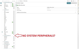

Using CCS 11.0 with SysConfig 1.10.0 for AM6442 with MCU+SDK v8.01. SysConfig seems to be missing support for setting up pinmux on "System" peripherals like EXT_CLK1 or CLKOUT0.

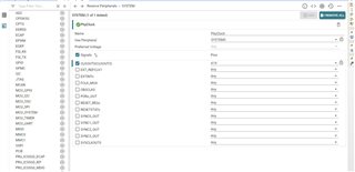

Under the Reserve Peripherals tab of SysConfig I can see, select, and choose pins for system peripherals. See screenshot below:
But Reserve Peripherals doesn't actually change the generated files (I've read it's for planning only). That's fine, but I can't seem to find any system peripherals like CLKOUT0 on the Software tab of SysConfig that is actually used to generate ti_pinmux_cfg.c.
Is there any way to set up the pinmux for pins like CLKOUT0 using SysConfig?

    This can be done using the "PinMux-Only" View of the SysConfig Tool. The layout is similar to the original PinMux Tool and exposes all device modules including MCU_SYSTEM and SYSTEM signals. This can be found by directly selecting the device from the SysConfig Tool start screen instead of selecting a Software Product.
    We are working on updating the "Reserved Peripherals" pane of the Software Product to enable this functionality without the need to switch between the two tool "Views" (SysConfig-SW+Reserved Peripherals and SysConfig-PinMux). In the mean time, you can copy and paste the content from the SysConfig-PinMux generated output to the SysConfig-SW files.
