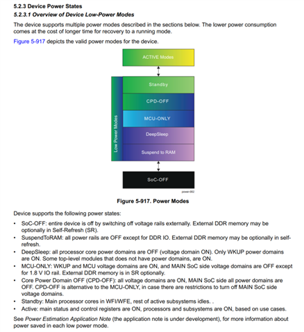

Hi ;
Please help me confirm some problems about TDA4VM。
1:What is the boot-up time of the TDA4 MCU domain? and MAIN domain boot time?
2:When TDA4VM in MCU Only mode,Can  enter STBY mode? What is the power consumption at this time? How long is the time from STBY mode to startup?
3: What is the power consumption  for each mode?(As shown in the figure below,)  What is the time from DeepSleep to MCU-ONLY? from DeepSleep to Active Mode?from MCU-ONLY to standby?
4:When TDA4VM in  STBY mode(MCU Only mode ), can   GPIO remain  high level output?
5:What is the maximum power consumption of TDA4?(worse  case)
