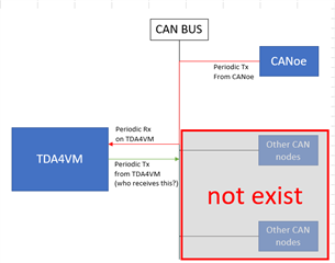

    Follow the steps below and have a similar problem.
    The operation steps are as follows:
    1. Connect CANoe and Device, and start CANoe and Device;
    2. Send NM Frame through CANoe, Device will periodically send messages to CAN bus;
    3. Without stopping sending NM Frame, click the Stop button directly to disconnected CANoe;
    4. Click the Start button again, CANoe Start, and continue to send NM Frame to the CAN bus;
    5. The problem occurs: At this time, the Device no longer sends messages to the CAN bus;
    After debugging, it is the same as the cause of this problem: the function Can_writeGetFreeMsgObj() always returns CAN_BUSY.
    Question:
    If the Device does not generate a BusOff event, the status 'canTxStatus' cannot be cleared;
    If the state 'canTxStatus' is not cleared, after CANoe Restart, the Device is in the CAN_BUSY state and cannot send messages.
    When should I go to clear the 'canTxStatus' state?
    How to deal with the above problems, please give guidance.
    Best Regards.

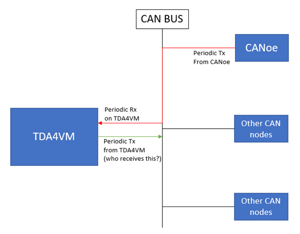

    1. I'm trying to understand the system. In the below diagram, the periodic Tx from TDA4VM (device) - who receives this message i.e. which node has filters setup to accept this message?
    Assuming that your CAN messages from TDA4VM were intended for CANoe, what I understand is that when you disconnect the CANoe - you start getting an AckError (PSR register LEC and DLEC) as message is transmitted but not received correctly on the intended CANoe node.
    In this system is Auto re-transmission enabled in your system (DAR bit unset)?
    2. When the MCAN controller on the TDA4VM is not generating a BusOff event, are you checking this in the ISR if that flag is set or not?
    What is the configuration of your Tx buffers? Also, are you using buffers or FIFO and what is the length?
    Karan
  • Hi, Karan
    As shown in the figure below, only CANoe and TDA4VM are connected to the CAN BUS (if there is a third device on the CAN BUS, the above problems will not occur)

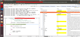

    When CANoe is disconnected, an AckError should be received, but referring to the following code, no control logic processing for the registers (PSR register LEC and DLEC) is found.
    \ti-processor-sdk-rtos-j721e-evm-08_00_00_12\mcusw\mcal_drv\mcal\Can\src\Can_Mcan.c
    The processing of reading errStatus.lastErrCode and errStatus.dlec is not found in the above code.
    The current setting is the same as the sdk8.0, DAR bit unset.
    I'm not sure if the above Case should generate a BusOff event, I'll check later if the ISR flag is set. contact later.

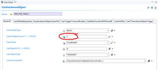

    Whether it refers to the setting of CanHwObjectCount, the settings for TX are as follows:

    When CANoe is disconnected, the program will stop at the following breakpoint(Can_Mcan.c line721).
    At this time, the PSR register is as follows (LEC=0h, DLEC=3h)
    In the above case does not generate a BusOff event, and I don't think it should generate a BusOff.
    Can you tell me how to confirm the above information? Which configuration parameters need to be checked?
    Can you give me some guidance, thanks.
