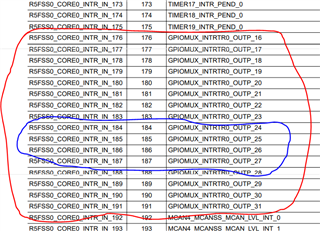

I use GPIO0 many PIN as input interrupt in mcu2_0, if 16PIn as a bank, these IO are in bank0 to bank 4;
I set Bank0  to Bank3 interrupt is success from 184 to 187, but bank4 set to others , it is NG
( 176~183 no matter which bank set, always NG, just can set from 184, I also try to release 188, then set bank4 again, NG)
Please help me  how can i do for the bank4 interrupt?
Below is MCU2_0 for GPIO interrupt Numbers, in blue these can  set OK, then  for bank4 interrupt , i try to set from 0~512, all Nums is NG
