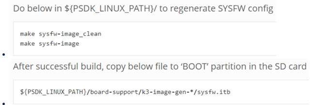

  • For ES1_1, we would need to change the sysfw.itb file. Can you please try attached sysfw binary?
    /cfs-file/__key/communityserver-discussions-components-files/791/sysfw.zip

    ok, can you please first try copying attached files on Boot partition and lets see if it boots file and if you are able to reach to uboot prompt?
    /cfs-file/__key/communityserver-discussions-components-files/791/hs.zip
    Brijesh

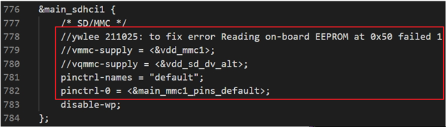

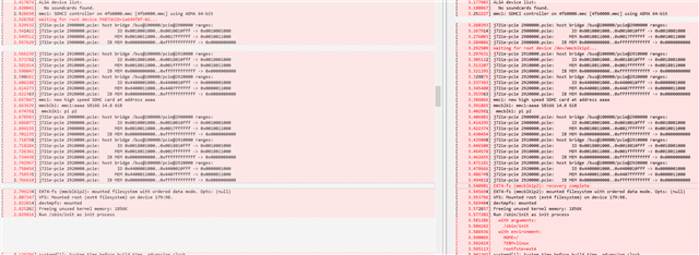

  • Hi
    first, result of using attached files
    second, add fitImage with command "sudo install {PSDKLR}/board-support/prebuilt-images/fitImage /media/yw/rootfs/boot/"
    MobaXterm_COM3ProlificUSB-to-SerialCommPortCOM3_20220111_090938.rtf
    Before I had same error message, I resolved refer to https://e2e.ti.com/support/processors-group/processors/f/processors-forum/1047047/tda4vm-booting-error-for-linux-rtos-example.
    but now I can't resolve this problem on the same way.
    {psdkla}/board-support/linux-5.4.74~/arch/arm64/boot/dts/ti/k3-j721e-common-proc-board.dts
    {psdkla}/board-support/linux-5.4.74~/arch/arm64/boot/dts/ti/k3-j721e-main.dtsi
    $> make linux-dtbs
    $> sudo make linux-dtbs_install
    Q1. What is fitImage? Does it need fitImage necessarily?
    Q2. How do you make attached files(tiboot3.bin, tispl.bin, sysfw.itb, u-boot.img)?
    Thank you.

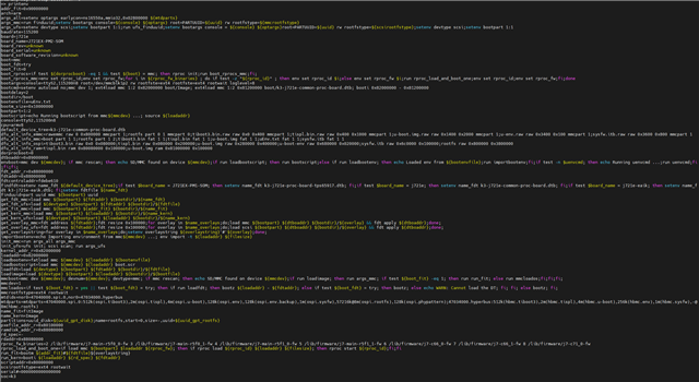

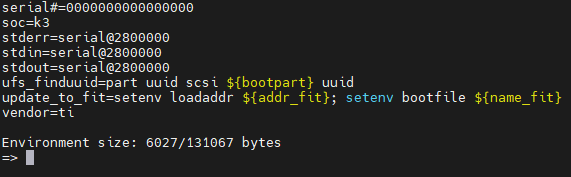

    fitimage is really not required. When you reach to uboot prompt, can you please change bootargs as shown below? This should boot Linux.
    setenv bootargs console=ttyS2,115200n8 root=/dev/mmcblk1p2 rw rootfste=ext4 rootfste=ext4 rootwait loglevel=8
    setenv bootcmd "setenv autoload no;mmc dev 1; ext4load mmc 1:2 0x82000000 boot/Image; ext4load mmc 1:2 0x81200000 boot/k3-j721e-common-proc-board.dtb; booti 0x82000000 - 0x81200000"
    saveenv
    boot
    Brijesh
    Result is shown below.
    printenv
    Thank you

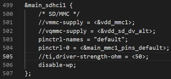

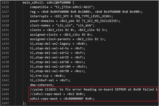

  • Hi
    I saw linux root prompt.
    I just copy images that you attached and modify {psdkla}/board-support/linux-5.4.74~/arch/arm64/boot/dts/ti/k3-j721e-common-proc-board.dts.
    Could you guide how to build HS mode? I wonder how you make attached files.
    My final goal is booting on SDK7_3.
    Thank you.

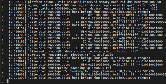

  •  Prompt is sometimes hanged.
    Please check log.

    Starting kernel ...
    [    0.000000] Booting Linux on physical CPU 0x0000000000 [0x411fd080]

    [    0.224681] ti-sci-intr bus@100000:main-navss:interrupt-controller1: Interrupt Router 213 domain created
    [    0.224798] ti-sci-inta 33d00000.interrupt-controller: Interrupt Aggregator domain 209 created
    [    0.235769] cdns-torrent-phy 5050000.serdes: 4 lanes, max bit rate 5.400 Gbps
    [    0.236128] j721e-pcie 2900000.pcie: host bridge /bus@100000/pcie@2900000 ranges:
    [    0.236144] j721e-pcie 2900000.pcie:       IO 0x0010001000..0x0010010fff -> 0x0010001000
    [    0.236155] j721e-pcie 2900000.pcie:      MEM 0x0010011000..0x0017ffffff -> 0x0010011000
    [    0.236165] j721e-pcie 2900000.pcie:   IB MEM 0x0000000000..0xffffffffffff -> 0x0000000000
    [    0.236537] j721e-pcie 2910000.pcie: host bridge /bus@100000/pcie@2910000 ranges:
    [    0.236553] j721e-pcie 2910000.pcie:       IO 0x0018001000..0x0018010fff -> 0x0018001000
    [    0.236561] j721e-pcie 2910000.pcie:      MEM 0x0018011000..0x001fffffff -> 0x0018011000
    [    0.236571] j721e-pcie 2910000.pcie:   IB MEM 0x0000000000..0xffffffffffff -> 0x0000000000
    [    0.236875] j721e-pcie 2920000.pcie: host bridge /bus@100000/pcie@2920000 ranges:
    [    0.236890] j721e-pcie 2920000.pcie:       IO 0x4400001000..0x4400010fff -> 0x0000001000
    [    0.236899] j721e-pcie 2920000.pcie:      MEM 0x4400011000..0x4407ffffff -> 0x0000011000
    [    0.236908] j721e-pcie 2920000.pcie:   IB MEM 0x0000000000..0xffffffffffff -> 0x0000000000
    [    0.237605] k3-ringacc 2b800000.ringacc: Ring Accelerator probed rings:286, gp-rings[96,20] sci-dev-id:235
    [    0.237610] k3-ringacc 2b800000.ringacc: dma-ring-reset-quirk: disabled
    [    0.237614] k3-ringacc 2b800000.ringacc: RA Proxy rev. 66346100, num_proxies:64
    [    0.239150] k3-ringacc 3c000000.ringacc: Ring Accelerator probed rings:1024, gp-rings[440,150] sci-dev-id:211
    [    0.239156] k3-ringacc 3c000000.ringacc: dma-ring-reset-quirk: disabled
    [    0.239159] k3-ringacc 3c000000.ringacc: RA Proxy rev. 66346100, num_proxies:64
    [    0.239650] 40a00000.serial: ttyS1 at MMIO 0x40a00000 (irq = 15, base_baud = 6000000) is a 8250
    [    0.240105] 2800000.serial: ttyS2 at MMIO 0x2800000 (irq = 33, base_baud = 3000000) is a 8250
    [    2.029831] printk: console [ttyS2] enabled
    [    2.034710] 2810000.serial: ttyS3 at MMIO 0x2810000 (irq = 34, base_baud = 3000000) is a 8250
    [    2.043658] 2840000.serial: ttyS6 at MMIO 0x2840000 (irq = 35, base_baud = 3000000) is a 8250
    [    2.053974] cdns-ufshcd 4e84000.ufs: ufshcd_populate_vreg: Unable to find vdd-hba-supply regulator, assuming enabled
    [    2.064484] cdns-ufshcd 4e84000.ufs: ufshcd_populate_vreg: Unable to find vcc-supply regulator, assuming enabled
    [    2.074635] cdns-ufshcd 4e84000.ufs: ufshcd_populate_vreg: Unable to find vccq-supply regulator, assuming enabled
    [    2.084872] cdns-ufshcd 4e84000.ufs: ufshcd_populate_vreg: Unable to find vccq2-supply regulator, assuming enabled
    [    2.095640] scsi host0: ufshcd
    [    2.139594] davinci_mdio 46000f00.mdio: davinci mdio revision 9.7, bus freq 1000000
    [    2.147242] libphy: 46000f00.mdio: probed
    [    2.151456] mdio_bus 46000f00.mdio: MDIO device at address 0 is missing.
    [    2.158182] am65-cpsw-nuss 46000000.ethernet: initializing am65 cpsw nuss version 0x6BA00101, cpsw version 0x6BA80100 Ports: 2 quirks:00000000
    [    2.171906] am65-cpts 310d0000.cpts: CPTS ver 0x4e8a010a, freq:200000000, add_val:4 pps:0
    [    2.180747] davinci-mcasp 2ba0000.mcasp: IRQ common not found
    [    2.180854] mmc0: CQHCI version 5.10
    [    2.190237] mmc1: CQHCI version 5.10
    [    2.199872] pca953x 4-0020: supply vcc not found, using dummy regulator
    [    2.206536] pca953x 4-0020: using no AI
    [    2.227597] mmc0: SDHCI controller on 4f80000.mmc [4f80000.mmc] using ADMA 64-bit
    [    2.235089] pca953x 4-0020: failed writing register
    [    2.240018] pca953x: probe of 4-0020 failed with error -121
    [    2.245957] omap-mailbox 31f80000.mailbox: omap mailbox rev 0x66fc7100
    [    2.252779] omap-mailbox 31f81000.mailbox: omap mailbox rev 0x66fc7100
    [    2.259614] omap-mailbox 31f82000.mailbox: omap mailbox rev 0x66fc7100
    [    2.266418] omap-mailbox 31f83000.mailbox: omap mailbox rev 0x66fc7100
    [    2.273208] omap-mailbox 31f84000.mailbox: omap mailbox rev 0x66fc7100
    [    2.282610] j721e-pcie 2900000.pcie: host bridge /bus@100000/pcie@2900000 ranges:
    [    2.290107] j721e-pcie 2900000.pcie:       IO 0x0010001000..0x0010010fff -> 0x0010001000
    [    2.298187] j721e-pcie 2900000.pcie:      MEM 0x0010011000..0x0017ffffff -> 0x0010011000
    [    2.306271] j721e-pcie 2900000.pcie:   IB MEM 0x0000000000..0xffffffffffff -> 0x0000000000
    [    2.314904] j721e-pcie 2910000.pcie: host bridge /bus@100000/pcie@2910000 ranges:
    [    2.318880] mmc0: Command Queue Engine enabled
    [    2.322396] j721e-pcie 2910000.pcie:       IO 0x0018001000..0x0018010fff -> 0x0018001000
    [    2.326820] mmc0: new HS200 MMC card at address 0001
    [    2.334884] j721e-pcie 2910000.pcie:      MEM 0x0018011000..0x001fffffff -> 0x0018011000
    [    2.340100] mmcblk0: mmc0:0001 S0J56X 14.8 GiB
    [    2.347903] j721e-pcie 2910000.pcie:   IB MEM 0x0000000000..0xffffffffffff -> 0x0000000000
    [    2.352506] j721e-pcie 2920000.pcie: host bridge /bus@100000/pcie@2920000 ranges:
    [    2.360807] mmcblk0boot0: mmc0:0001 S0J56X partition 1 31.5 MiB
    [    2.368159] j721e-pcie 2920000.pcie:       IO 0x4400001000..0x4400010fff -> 0x0000001000
    [    2.374147] mmcblk0boot1: mmc0:0001 S0J56X partition 2 31.5 MiB
    [    2.382127] j721e-pcie 2920000.pcie:      MEM 0x4400011000..0x4407ffffff -> 0x0000011000
    [    2.388100] mmcblk0rpmb: mmc0:0001 S0J56X partition 3 4.00 MiB, chardev (237:0)
    [    2.396093] j721e-pcie 2920000.pcie:   IB MEM 0x0000000000..0xffffffffffff -> 0x0000000000
    [    2.412544] ti-udma 285c0000.dma-controller: Channels: 26 (tchan: 13, rchan: 13, gp-rflow: 8)
    [    2.414130]  mmcblk0: p1 p2 p3 p4
    [    2.425409] ti-udma 31150000.dma-controller: Channels: 84 (tchan: 42, rchan: 42, gp-rflow: 16)
    [    2.438590] spi-nor spi0.0: unrecognized JEDEC id bytes: 2c 5b 1b 10 41 00
    [    2.445472] spi-nor: probe of spi0.0 failed with error -2
    [    2.452760] spi-nor spi1.0: unrecognized JEDEC id bytes: ff ff ff ff ff ff
    [    2.459631] spi-nor: probe of spi1.0 failed with error -2
    [    2.503597] davinci_mdio 46000f00.mdio: davinci mdio revision 9.7, bus freq 1000000
    [    2.506657] cdns-ufshcd 4e84000.ufs: link startup failed 1
    [    2.511239] libphy: 46000f00.mdio: probed
    [    2.516711] cdns-ufshcd 4e84000.ufs: UFS Host state=0
    [    2.520917] mdio_bus 46000f00.mdio: MDIO device at address 0 is missing.
    [    2.525743] cdns-ufshcd 4e84000.ufs: outstanding reqs=0x0 tasks=0x0
    [    2.532456] am65-cpsw-nuss 46000000.ethernet: initializing am65 cpsw nuss version 0x6BA00101, cpsw version 0x6BA80100 Ports: 2 quirks:00000000
    [    2.538676] cdns-ufshcd 4e84000.ufs: saved_err=0x0, saved_uic_err=0x0
    [    2.557854] cdns-ufshcd 4e84000.ufs: Device power mode=1, UIC link state=0
    [    2.564718] cdns-ufshcd 4e84000.ufs: PM in progress=0, sys. suspended=0
    [    2.571320] cdns-ufshcd 4e84000.ufs: Auto BKOPS=0, Host self-block=0
    [    2.577665] cdns-ufshcd 4e84000.ufs: Clk gate=1
    [    2.577686] am65-cpsw-nuss 46000000.ethernet: set new flow-id-base 48
    [    2.582183] cdns-ufshcd 4e84000.ufs: last_hibern8_exit_tstamp at 0 us, hibern8_exit_cnt=0
    [    2.582186] cdns-ufshcd 4e84000.ufs: last intr at 2501955 us, last intr status=0x404
    [    2.582188] cdns-ufshcd 4e84000.ufs: error handling flags=0x0, req. abort count=0
    [    2.582192] cdns-ufshcd 4e84000.ufs: hba->ufs_version=0x210, Host capabilities=0x1587031f, caps=0x0
    [    2.612056] am65-cpsw-nuss 46000000.ethernet: initialized cpsw ale version 1.4
    [    2.620994] cdns-ufshcd 4e84000.ufs: quirks=0x0, dev. quirks=0x0
    [    2.620996] cdns-ufshcd 4e84000.ufs: clk: core_clk, rate: 250000000
    [    2.621000] cdns-ufshcd 4e84000.ufs: clk: phy_clk, rate: 19200000
    [    2.628206] am65-cpsw-nuss 46000000.ethernet: ALE Table size 64
    [    2.634190] cdns-ufshcd 4e84000.ufs: clk: ref_clk, rate: 19200000
    [    2.652679] am65-cpsw-nuss 46000000.ethernet: CPTS ver 0x4e8a010a, freq:500000000, add_val:1 pps:0
    [    2.658511] cdns-ufshcd 4e84000.ufs: ufshcd_print_pwr_info:[RX, TX]: gear=[0, 0], lane[0, 0], pwr[INVALID MODE, INVALID MODE], rate = 0
    [    2.679602] host_regs: 00000000: 1587031f 00000000 00000210 00000000
    [    2.685947] host_regs: 00000010: 00000000 00000000 00000000 00000000
    [    2.692296] host_regs: 00000020: 00000000 00000470 00000000 00000000
    [    2.692324] davinci-mcasp 2ba0000.mcasp: IRQ common not found
    [    2.698634] host_regs: 00000030: 00000008 00000001 00000000 00000000
    [    2.698637] host_regs: 00000040: 00000000 00000000 00000000 00000000
    [    2.698639] host_regs: 00000050: 00000000 00000000 00000000 00000000
    [    2.698642] host_regs: 00000060: 00000000 00000000 00000000 00000000
    [    2.729741] host_regs: 00000070: 00000000 00000000 00000000 00000000
    [    2.736084] host_regs: 00000080: 00000000 00000000 00000000 00000000
    [    2.742426] host_regs: 00000090: 00000000 00000000 00000000 00000000
    [    2.748770] cdns-ufshcd 4e84000.ufs: No record of pa_err
    [    2.754074] cdns-ufshcd 4e84000.ufs: No record of dl_err
    [    2.759376] cdns-ufshcd 4e84000.ufs: No record of nl_err
    [    2.764678] cdns-ufshcd 4e84000.ufs: No record of tl_err
    [    2.769980] cdns-ufshcd 4e84000.ufs: No record of dme_err
    [    2.775368] cdns-ufshcd 4e84000.ufs: No record of auto_hibern8_err
    [    2.781540] cdns-ufshcd 4e84000.ufs: No record of fatal_err
    [    2.787103] cdns-ufshcd 4e84000.ufs: link_startup_fail[0] = 0x1 at 2503073 us
    [    2.794226] cdns-ufshcd 4e84000.ufs: No record of resume_fail
    [    2.799962] cdns-ufshcd 4e84000.ufs: No record of suspend_fail
    [    2.805786] cdns-ufshcd 4e84000.ufs: No record of dev_reset
    [    2.811350] cdns-ufshcd 4e84000.ufs: No record of host_reset
    [    2.816998] cdns-ufshcd 4e84000.ufs: No record of task_abort
    [    2.825429] j721e-pcie 2900000.pcie: host bridge /bus@100000/pcie@2900000 ranges:
    [    2.832930] j721e-pcie 2900000.pcie:       IO 0x0010001000..0x0010010fff -> 0x0010001000
    [    2.841015] j721e-pcie 2900000.pcie:      MEM 0x0010011000..0x0017ffffff -> 0x0010011000
    [    2.849099] j721e-pcie 2900000.pcie:   IB MEM 0x0000000000..0xffffffffffff -> 0x0000000000
    [    2.857662] j721e-pcie 2910000.pcie: host bridge /bus@100000/pcie@2910000 ranges:
    [    2.865152] j721e-pcie 2910000.pcie:       IO 0x0018001000..0x0018010fff -> 0x0018001000
    [    2.873229] j721e-pcie 2910000.pcie:      MEM 0x0018011000..0x001fffffff -> 0x0018011000
    [    2.881308] j721e-pcie 2910000.pcie:   IB MEM 0x0000000000..0xffffffffffff -> 0x0000000000
    [    2.889842] j721e-pcie 2920000.pcie: host bridge /bus@100000/pcie@2920000 ranges:
    [    2.897328] j721e-pcie 2920000.pcie:       IO 0x4400001000..0x4400010fff -> 0x0000001000
    [    2.905404] j721e-pcie 2920000.pcie:      MEM 0x4400011000..0x4407ffffff -> 0x0000011000
    [    2.913481] j721e-pcie 2920000.pcie:   IB MEM 0x0000000000..0xffffffffffff -> 0x0000000000
    [    2.922892] j721e-pcie 2900000.pcie: host bridge /bus@100000/pcie@2900000 ranges:
    [    2.930385] j721e-pcie 2900000.pcie:       IO 0x0010001000..0x0010010fff -> 0x0010001000
    [    2.938467] j721e-pcie 2900000.pcie:      MEM 0x0010011000..0x0017ffffff -> 0x0010011000
    [    2.946552] j721e-pcie 2900000.pcie:   IB MEM 0x0000000000..0xffffffffffff -> 0x0000000000
    [    2.955096] j721e-pcie 2910000.pcie: host bridge /bus@100000/pcie@2910000 ranges:
    [    2.962593] j721e-pcie 2910000.pcie:       IO 0x0018001000..0x0018010fff -> 0x0018001000
    [    2.970672] j721e-pcie 2910000.pcie:      MEM 0x0018011000..0x001fffffff -> 0x0018011000
    [    2.978749] j721e-pcie 2910000.pcie:   IB MEM 0x0000000000..0xffffffffffff -> 0x0000000000
    [    2.987268] j721e-pcie 2920000.pcie: host bridge /bus@100000/pcie@2920000 ranges:
    [    2.994757] j721e-pcie 2920000.pcie:       IO 0x4400001000..0x4400010fff -> 0x0000001000
    [    3.002834] j721e-pcie 2920000.pcie:      MEM 0x4400011000..0x4407ffffff -> 0x0000011000
    [    3.010913] j721e-pcie 2920000.pcie:   IB MEM 0x0000000000..0xffffffffffff -> 0x0000000000
    [    3.019953] debugfs: Directory 'pd:27' with parent 'pm_genpd' already present!
    [    3.027247] debugfs: Directory 'pd:26' with parent 'pm_genpd' already present!
    [    3.035396] debugfs: Directory 'pd:242' with parent 'pm_genpd' already present!
    [    3.042709] debugfs: Directory 'pd:241' with parent 'pm_genpd' already present!
    [    3.050032] debugfs: Directory 'pd:240' with parent 'pm_genpd' already present!
    [    3.057387] debugfs: Directory 'pd:239' with parent 'pm_genpd' already present!
    [    3.065413] input: gpio-keys as /devices/platform/gpio-keys/input/input0
    [    3.072852] j721e-pcie 2900000.pcie: host bridge /bus@100000/pcie@2900000 ranges:
    [    3.080350] j721e-pcie 2900000.pcie:       IO 0x0010001000..0x0010010fff -> 0x0010001000
    [    3.088438] j721e-pcie 2900000.pcie:      MEM 0x0010011000..0x0017ffffff -> 0x0010011000
    [    3.096524] j721e-pcie 2900000.pcie:   IB MEM 0x0000000000..0xffffffffffff -> 0x0000000000
    [    3.105208] j721e-pcie 2910000.pcie: host bridge /bus@100000/pcie@2910000 ranges:
    [    3.112706] j721e-pcie 2910000.pcie:       IO 0x0018001000..0x0018010fff -> 0x0018001000
    [    3.120789] j721e-pcie 2910000.pcie:      MEM 0x0018011000..0x001fffffff -> 0x0018011000
    [    3.128873] j721e-pcie 2910000.pcie:   IB MEM 0x0000000000..0xffffffffffff -> 0x0000000000
    [    3.137459] j721e-pcie 2920000.pcie: host bridge /bus@100000/pcie@2920000 ranges:
    [    3.144953] j721e-pcie 2920000.pcie:       IO 0x4400001000..0x4400010fff -> 0x0000001000
    [    3.153039] j721e-pcie 2920000.pcie:      MEM 0x4400011000..0x4407ffffff -> 0x0000011000
    [    3.161122] j721e-pcie 2920000.pcie:   IB MEM 0x0000000000..0xffffffffffff -> 0x0000000000
    [    3.177903] ALSA device list:
    [    3.180867]   No soundcards found.
    [    3.252227] mmc1: SDHCI controller on 4fb0000.mmc [4fb0000.mmc] using ADMA 64-bit
    [    3.260393] j721e-pcie 2900000.pcie: host bridge /bus@100000/pcie@2900000 ranges:

    [    6.457267] j721e-pcie 2920000.pcie:       IO 0x4400001000..0x4400010fff -> 0x0000001000
    [    6.466972] j721e-pcie 2920000.pcie:      MEM 0x4400011000..0x4407ffffff -> 0x0000011000
    [    6.475132] j721e-pcie 2920000.pcie:   IB MEM 0x0000000000..0xffffffffffff -> 0x0000000000
    [    6.489213] j721e-pcie 2900000.pcie: host bridge /bus@100000/pcie@2900000 ranges:
    [    6.497185] j721e-pcie 2900000.pcie:       IO 0x0010001000..0x0010010fff -> 0x0010001000
    [    6.505330] j721e-pcie 2900000.pcie:      MEM 0x0010011000..0x0017ffffff -> 0x0010011000
    [    6.513508] j721e-pcie 2900000.pcie:   IB MEM 0x0000000000..0xffffffffffff -> 0x0000000000
    [    6.524748] j721e-pcie 2910000.pcie: host bridge /bus@100000/pcie@2910000 ranges:
    [    6.533659] j721e-pcie 2910000.pcie:       IO 0x0018001000..0x0018010fff -> 0x0018001000
    [    6.543630] j721e-pcie 2910000.pcie:      MEM 0x0018011000..0x001fffffff -> 0x0018011000
    [    6.555622] j721e-pcie 2910000.pcie:   IB MEM 0x0000000000..0xffffffffffff -> 0x0000000000
    [    6.563772] img_dec 4300000.video-decoder: decoder registered as /dev/video0
    [    6.564942] j721e-pcie 2920000.pcie: host bridge /bus@100000/pcie@2920000 ranges:
    [    6.581352] j721e-pcie 2920000.pcie:       IO 0x4400001000..0x4400010fff -> 0x0000001000
    [    6.591721] j721e-pcie 2920000.pcie:      MEM 0x4400011000..0x4407ffffff -> 0x0000011000
    [    6.601787] j721e-pcie 2920000.pcie:   IB MEM 0x0000000000..0xffffffffffff -> 0x0000000000
    [    6.619065] j721e-pcie 2900000.pcie: host bridge /bus@100000/pcie@2900000 ranges:
    [    6.627673] j721e-pcie 2900000.pcie:       IO 0x0010001000..0x0010010fff -> 0x0010001000
    [    6.636546] j721e-pcie 2900000.pcie:      MEM 0x0010011000..0x0017ffffff -> 0x0010011000
    [    6.646022] img_enc 4200000.video-encoder: vxe_enc_probe: using heap 1 for internal alloc
    [    6.647636] j721e-pcie 2900000.pcie:   IB MEM 0x0000000000..0xffffffffffff -> 0x0000000000
    [    6.676438] j721e-pcie 2910000.pcie: host bridge /bus@100000/pcie@2910000 ranges:
    [    6.689583] j721e-pcie 2910000.pcie:       IO 0x0018001000..0x0018010fff -> 0x0018001000
    [    6.703739] j721e-pcie 2910000.pcie:      MEM 0x0018011000..0x001fffffff -> 0x0018011000
    [    6.716017] k3-dsp-rproc 4d80800000.dsp: assigned reserved memory node c66-dma-memory@a7000000
    [    6.724675] j721e-pcie 2910000.pcie:   IB MEM 0x0000000000..0xffffffffffff -> 0x0000000000
    [    6.735264] j721e-pcie 2920000.pcie: host bridge /bus@100000/pcie@2920000 ranges:
    [    6.749918] j721e-pcie 2920000.pcie:       IO 0x4400001000..0x4400010fff -> 0x0000001000
    [    6.765865] j721e-pcie 2920000.pcie:      MEM 0x4400011000..0x4407ffffff -> 0x0000011000
    [    6.781810] j721e-pcie 2920000.pcie:   IB MEM 0x0000000000..0xffffffffffff -> 0x0000000000
    [    6.808455] j721e-pcie 2900000.pcie: host bridge /bus@100000/pcie@2900000 ranges:
    [    6.817402] j721e-pcie 2900000.pcie:       IO 0x0010001000..0x0010010fff -> 0x0010001000
    [    6.831864] j721e-pcie 2900000.pcie:      MEM 0x0010011000..0x0017ffffff -> 0x0010011000
    [    6.847719] j721e-pcie 2900000.pcie:   IB MEM 0x0000000000..0xffffffffffff -> 0x0000000000
    [    6.865405] j721e-pcie 2910000.pcie: host bridge /bus@100000/pcie@2910000 ranges:
    [    6.883638] j721e-pcie 2910000.pcie:       IO 0x0018001000..0x0018010fff -> 0x0018001000
    [    6.895626] j721e-pcie 2910000.pcie:      MEM 0x0018011000..0x001fffffff -> 0x0018011000
    [    6.903774] j721e-pcie 2910000.pcie:   IB MEM 0x0000000000..0xffffffffffff -> 0x0000000000
    [    6.919326] PVR_K:  206: Read BVNC 22.104.208.318 from HW device registers
    [    6.928674] j721e-pcie 2920000.pcie: host bridge /bus@100000/pcie@2920000 ranges:
    [    6.943658] j721e-pcie 2920000.pcie:       IO 0x4400001000..0x4400010fff -> 0x0000001000
    [    6.959635] j721e-pcie 2920000.pcie:      MEM 0x4400011000..0x4407ffffff -> 0x0000011000
    [    6.975271] j721e-pcie 2920000.pcie:   IB MEM 0x0000000000..0xffffffffffff -> 0x0000000000
    [    7.072518] k3-dsp-rproc 4d80800000.dsp: configured DSP for remoteproc mode
    [    7.098552] PVR_K:  206: RGX Device registered with BVNC 22.104.208.318
    [    7.098607] img_enc 4200000.video-encoder: encoder registered as /dev/video1
    [    7.136515] [drm] Initialized tidss 1.0.0 20180215 for 4a00000.dss on minor 1
    [    7.143690] tidss 4a00000.dss: [drm] Cannot find any crtc or sizes
    [    7.159011] j721e-pcie 2900000.pcie: host bridge /bus@100000/pcie@2900000 ranges:
    [    7.170711] j721e-pcie 2900000.pcie:       IO 0x0010001000..0x0010010fff -> 0x0010001000
    [    7.182855] j721e-pcie 2900000.pcie:      MEM 0x0010011000..0x0017ffffff -> 0x0010011000
    [    7.194996] j721e-pcie 2900000.pcie:   IB MEM 0x0000000000..0xffffffffffff -> 0x0000000000
    [    7.208469] j721e-pcie 2910000.pcie: host bridge /bus@100000/pcie@2910000 ranges:
    [    7.215998] j721e-pcie 2910000.pcie:       IO 0x0018001000..0x0018010fff -> 0x0018001000
    [    7.231673] j721e-pcie 2910000.pcie:      MEM 0x0018011000..0x001fffffff -> 0x0018011000
    [    7.243756] j721e-pcie 2910000.pcie:   IB MEM 0x0000000000..0xffffffffffff -> 0x0000000000
    [    7.259656] k3-dsp-rproc 4d80800000.dsp: local reset is deasserted for device
    [    7.259836] j721e-pcie 2920000.pcie: host bridge /bus@100000/pcie@2920000 ranges:
    [    7.278525] j721e-pcie 2920000.pcie:       IO 0x4400001000..0x4400010fff -> 0x0000001000
    [    7.290633] j721e-pcie 2920000.pcie:      MEM 0x4400011000..0x4407ffffff -> 0x0000011000
    [    7.302863] j721e-pcie 2920000.pcie:   IB MEM 0x0000000000..0xffffffffffff -> 0x0000000000
    [    7.315161] [drm] Initialized pvr 1.13.5776728 20170530 for 4e20000000.gpu on minor 0
    [    7.317980] j721e-pcie 2900000.pcie: host bridge /bus@100000/pcie@2900000 ranges:
    [    7.336358] j721e-pcie 2900000.pcie:       IO 0x0010001000..0x0010010fff -> 0x0010001000
    [    7.348399] j721e-pcie 2900000.pcie:      MEM 0x0010011000..0x0017ffffff -> 0x0010011000
    [    7.359383] remoteproc remoteproc0: 4d80800000.dsp is available
    [    7.360525] j721e-pcie 2900000.pcie:   IB MEM 0x0000000000..0xffffffffffff -> 0x0000000000
    [    7.381206] j721e-pcie 2910000.pcie: host bridge /bus@100000/pcie@2910000 ranges:
    [    7.392425] j721e-pcie 2910000.pcie:       IO 0x0018001000..0x0018010fff -> 0x0018001000
    [    7.403646] j721e-pcie 2910000.pcie:      MEM 0x0018011000..0x001fffffff -> 0x0018011000
    [    7.411747] j721e-pcie 2910000.pcie:   IB MEM 0x0000000000..0xffffffffffff -> 0x0000000000
    [    7.422893] j721e-pcie 2920000.pcie: host bridge /bus@100000/pcie@2920000 ranges:
    [    7.431391] j721e-pcie 2920000.pcie:       IO 0x4400001000..0x4400010fff -> 0x0000001000
    [    7.439933] j721e-pcie 2920000.pcie:      MEM 0x4400011000..0x4407ffffff -> 0x0000011000
    [    7.448236] k3-dsp-rproc 4d81800000.dsp: assigned reserved memory node c66-dma-memory@a6000000
    [    7.456943] j721e-pcie 2920000.pcie:   IB MEM 0x0000000000..0xffffffffffff -> 0x0000000000
    [    7.467820] j721e-pcie 2900000.pcie: host bridge /bus@100000/pcie@2900000 ranges:
    [    7.476004] j721e-pcie 2900000.pcie:       IO 0x0010001000..0x0010010fff -> 0x0010001000
    [    7.484228] j721e-pcie 2900000.pcie:      MEM 0x0010011000..0x0017ffffff -> 0x0010011000
    [    7.492396] j721e-pcie 2900000.pcie:   IB MEM 0x0000000000..0xffffffffffff -> 0x0000000000
    [    7.503154] j721e-pcie 2910000.pcie: host bridge /bus@100000/pcie@2910000 ranges:
    [    7.511152] j721e-pcie 2910000.pcie:       IO 0x0018001000..0x0018010fff -> 0x0018001000
    [    7.519333] j721e-pcie 2910000.pcie:      MEM 0x0018011000..0x001fffffff -> 0x0018011000
    [    7.529286] j721e-pcie 2910000.pcie:   IB MEM 0x0000000000..0xffffffffffff -> 0x0000000000
    [    7.566134] remoteproc remoteproc0: powering up 4d80800000.dsp
    [    7.572334] remoteproc remoteproc0: Booting fw image j7-c66_0-fw, size 1436436
    [    7.628544] j721e-pcie 2920000.pcie: host bridge /bus@100000/pcie@2920000 ranges:
    [    7.636156] k3-dsp-rproc 4d81800000.dsp: configured DSP for remoteproc mode
    [    7.643281] remoteproc remoteproc0: bad phdr da 0xa8100000 mem 0x8c
    [    7.649593] platform 41000000.r5f: R5F core may have been powered on by a different host, programmed state (0) != actual state (1)
    [    7.649643] j721e-pcie 2920000.pcie:       IO 0x4400001000..0x4400010fff -> 0x0000001000
    [    7.669453] remoteproc remoteproc0: Failed to load program segments: -22
    [    7.676236] j721e-pcie 2920000.pcie:      MEM 0x4400011000..0x4407ffffff -> 0x0000011000
    [    7.684380] j721e-pcie 2920000.pcie:   IB MEM 0x0000000000..0xffffffffffff -> 0x0000000000
    [    7.693836] k3-dsp-rproc 4d81800000.dsp: local reset is deasserted for device
    [    7.713331] platform 41000000.r5f: configured R5F for IPC-only mode
    [    7.726066] platform 41000000.r5f: assigned reserved memory node r5f-dma-memory@a0000000
    [    7.752116] remoteproc remoteproc2: 41000000.r5f is available
    [    7.768118] remoteproc remoteproc2: attaching to 41000000.r5f
    [    7.780823] platform 41000000.r5f: R5F core initialized in IPC-only mode
    [    7.816519] remoteproc remoteproc1: 4d81800000.dsp is available
    [    7.827367]  remoteproc2#vdev0buffer: assigned reserved memory node r5f-dma-memory@a0000000
    [    7.852394] j721e-pcie 2900000.pcie: host bridge /bus@100000/pcie@2900000 ranges:
    [    7.861514] k3-dsp-rproc 64800000.dsp: assigned reserved memory node c71-dma-memory@a8000000
    [    7.869985] j721e-pcie 2900000.pcie:       IO 0x0010001000..0x0010010fff -> 0x0010001000
    [    7.878101] j721e-pcie 2900000.pcie:      MEM 0x0010011000..0x0017ffffff -> 0x0010011000
    [    7.881322] virtio_rpmsg_bus virtio0: rpmsg host is online
    [    7.886650] j721e-pcie 2900000.pcie:   IB MEM 0x0000000000..0xffffffffffff -> 0x0000000000
    [    7.902260] virtio_rpmsg_bus virtio0: creating channel ti.ipc4.ping-pong addr 0xd
    [    7.910403] j721e-pcie 2910000.pcie: host bridge /bus@100000/pcie@2910000 ranges:
    [    7.917960] virtio_rpmsg_bus virtio0: creating channel rpmsg_chrdev addr 0xe
    [    7.926421] remoteproc remoteproc1: powering up 4d81800000.dsp
    [    7.932332] j721e-pcie 2910000.pcie:       IO 0x0018001000..0x0018010fff -> 0x0018001000
    [    7.933863]  remoteproc2#vdev0buffer: registered virtio0 (type 7)
    [    7.940491] remoteproc remoteproc1: Booting fw image j7-c66_1-fw, size 1436436
    [    7.955697] j721e-pcie 2910000.pcie:      MEM 0x0018011000..0x001fffffff -> 0x0018011000
    [    7.963971] remoteproc remoteproc1: bad phdr da 0xa9100000 mem 0x8c
    [    7.970290] j721e-pcie 2910000.pcie:   IB MEM 0x0000000000..0xffffffffffff -> 0x0000000000
    [    7.980791] k3-dsp-rproc 64800000.dsp: configured DSP for remoteproc mode
    [    7.981797] remoteproc remoteproc1: Failed to load program segments: -22
    [    7.994815] j721e-pcie 2920000.pcie: host bridge /bus@100000/pcie@2920000 ranges:
    [    8.002397] j721e-pcie 2920000.pcie:       IO 0x4400001000..0x4400010fff -> 0x0000001000
    [    8.010543] j721e-pcie 2920000.pcie:      MEM 0x4400011000..0x4407ffffff -> 0x0000011000
    [    8.018708] j721e-pcie 2920000.pcie:   IB MEM 0x0000000000..0xffffffffffff -> 0x0000000000
    [    8.029520] j721e-pcie 2900000.pcie: host bridge /bus@100000/pcie@2900000 ranges:
    [    8.038589] j721e-pcie 2900000.pcie:       IO 0x0010001000..0x0010010fff -> 0x0010001000
    [    8.045765] remoteproc remoteproc2: remote processor 41000000.r5f is now attached
    [    8.046712] j721e-pcie 2900000.pcie:      MEM 0x0010011000..0x0017ffffff -> 0x0010011000
    [    8.062218] j721e-pcie 2900000.pcie:   IB MEM 0x0000000000..0xffffffffffff -> 0x0000000000
    [    8.068696] remoteproc remoteproc3: 64800000.dsp is available
    [    8.072130] j721e-pcie 2910000.pcie: host bridge /bus@100000/pcie@2910000 ranges:
    [    8.084690] j721e-pcie 2910000.pcie:       IO 0x0018001000..0x0018010fff -> 0x0018001000
    [    8.092857] j721e-pcie 2910000.pcie:      MEM 0x0018011000..0x001fffffff -> 0x0018011000
    [    8.101028] j721e-pcie 2910000.pcie:   IB MEM 0x0000000000..0xffffffffffff -> 0x0000000000
    [    8.116585] j721e-pcie 2920000.pcie: host bridge /bus@100000/pcie@2920000 ranges:
    [    8.124098] j721e-pcie 2920000.pcie:       IO 0x4400001000..0x4400010fff -> 0x0000001000
    [    8.132409] j721e-pcie 2920000.pcie:      MEM 0x4400011000..0x4407ffffff -> 0x0000011000
    [    8.140608] j721e-pcie 2920000.pcie:   IB MEM 0x0000000000..0xffffffffffff -> 0x0000000000
    [    8.155344] platform 5c00000.r5f: configured R5F for remoteproc mode
    [    8.163872] j721e-pcie 2900000.pcie: host bridge /bus@100000/pcie@2900000 ranges:
    [    8.176908] j721e-pcie 2900000.pcie:       IO 0x0010001000..0x0010010fff -> 0x0010001000
    [    8.191736] j721e-pcie 2900000.pcie:      MEM 0x0010011000..0x0017ffffff -> 0x0010011000
    [    8.207130] j721e-pcie 2900000.pcie:   IB MEM 0x0000000000..0xffffffffffff -> 0x0000000000
    [    8.225679] j721e-pcie 2910000.pcie: host bridge /bus@100000/pcie@2910000 ranges:
    [    8.233341] platform 5c00000.r5f: assigned reserved memory node r5f-dma-memory@a2000000
    [    8.237915] j721e-pcie 2910000.pcie:       IO 0x0018001000..0x0018010fff -> 0x0018001000
    [    8.249493] j721e-pcie 2910000.pcie:      MEM 0x0018011000..0x001fffffff -> 0x0018011000
    [    8.258644] j721e-pcie 2910000.pcie:   IB MEM 0x0000000000..0xffffffffffff -> 0x0000000000
    [    8.259617] random: crng init done
    [    8.267639] remoteproc remoteproc4: 5c00000.r5f is available
    [    8.270286] random: 7 urandom warning(s) missed due to ratelimiting
    [    8.276043] j721e-pcie 2920000.pcie: host bridge /bus@100000/pcie@2920000 ranges:
    [    8.289909] platform 5d00000.r5f: configured R5F for remoteproc mode
    [    8.290184] j721e-pcie 2920000.pcie:       IO 0x4400001000..0x4400010fff -> 0x0000001000
    [    8.304506] j721e-pcie 2920000.pcie:      MEM 0x4400011000..0x4407ffffff -> 0x0000011000
    [    8.312790] j721e-pcie 2920000.pcie:   IB MEM 0x0000000000..0xffffffffffff -> 0x0000000000
    [    8.330474] platform 5d00000.r5f: assigned reserved memory node r5f-dma-memory@a3000000
    [    8.370435] remoteproc remoteproc5: 5d00000.r5f is available
    [    8.377985] j721e-pcie 2900000.pcie: host bridge /bus@100000/pcie@2900000 ranges:
    [    8.385947] j721e-pcie 2900000.pcie:       IO 0x0010001000..0x0010010fff -> 0x0010001000
    [    8.394251] j721e-pcie 2900000.pcie:      MEM 0x0010011000..0x0017ffffff -> 0x0010011000
    [    8.403789] j721e-pcie 2900000.pcie:   IB MEM 0x0000000000..0xffffffffffff -> 0x0000000000
    [    8.412268] remoteproc remoteproc5: powering up 5d00000.r5f
    [    8.417852] remoteproc remoteproc5: Booting fw image j7-main-r5f0_1-fw, size 301996
    [    8.423575] platform 5e00000.r5f: configured R5F for remoteproc mode
    [    8.432191] j721e-pcie 2910000.pcie: host bridge /bus@100000/pcie@2910000 ranges:
    Thank you.

    [    2.417074] ALSA device list:
    [    2.420041]   No soundcards found.
    [    2.520650] mmc1: SDHCI controller on 4fb0000.mmc [4fb0000.mmc] using ADMA 64-bit
    [    2.528358] Waiting for root device PARTUUID=1a649f0f-02...
    [    2.529532] j721e-pcie 2900000.pcie: host bridge /bus@100000/pcie@2900000 ranges:
    [    2.541422] j721e-pcie 2900000.pcie:       IO 0x0010001000..0x0010010fff -> 0x0010001000
    [    2.549512] j721e-pcie 2900000.pcie:      MEM 0x0010011000..0x0017ffffff -> 0x0010011000
    [    2.557629] j721e-pcie 2900000.pcie:   IB MEM 0x0000000000..0xffffffffffff -> 0x0000000000
    [    2.566239] j721e-pcie 2910000.pcie: host bridge /bus@100000/pcie@2910000 ranges:
    [    2.573782] j721e-pcie 2910000.pcie:       IO 0x0018001000..0x0018010fff -> 0x0018001000
    [    2.581914] j721e-pcie 2910000.pcie:      MEM 0x0018011000..0x001fffffff -> 0x0018011000
    [    2.590047] j721e-pcie 2910000.pcie:   IB MEM 0x0000000000..0xffffffffffff -> 0x0000000000
    [    2.598661] j721e-pcie 2920000.pcie: host bridge /bus@100000/pcie@2920000 ranges:
    [    2.606188] j721e-pcie 2920000.pcie:       IO 0x4400001000..0x4400010fff -> 0x0000001000
    [    2.614273] j721e-pcie 2920000.pcie:      MEM 0x4400011000..0x4407ffffff -> 0x0000011000
    [    2.622363] j721e-pcie 2920000.pcie:   IB MEM 0x0000000000..0xffffffffffff -> 0x0000000000
    [    2.657847] mmc1: new high speed SDHC card at address aaaa
    [    2.663639] mmcblk1: mmc1:aaaa SB16G 14.8 GiB
    [    2.674761]  mmcblk1: p1 p2
    [    2.678583] j721e-pcie 2900000.pcie: host bridge /bus@100000/pcie@2900000 ranges:
    [    2.686077] j721e-pcie 2900000.pcie:       IO 0x0010001000..0x0010010fff -> 0x0010001000
    [    2.694155] j721e-pcie 2900000.pcie:      MEM 0x0010011000..0x0017ffffff -> 0x0010011000
    [    2.702235] j721e-pcie 2900000.pcie:   IB MEM 0x0000000000..0xffffffffffff -> 0x0000000000
    [    2.710788] j721e-pcie 2910000.pcie: host bridge /bus@100000/pcie@2910000 ranges:
    [    2.718284] j721e-pcie 2910000.pcie:       IO 0x0018001000..0x0018010fff -> 0x0018001000
    [    2.726361] j721e-pcie 2910000.pcie:      MEM 0x0018011000..0x001fffffff -> 0x0018011000
    [    2.734438] j721e-pcie 2910000.pcie:   IB MEM 0x0000000000..0xffffffffffff -> 0x0000000000
    [    2.742967] j721e-pcie 2920000.pcie: host bridge /bus@100000/pcie@2920000 ranges:
    [    2.750458] j721e-pcie 2920000.pcie:       IO 0x4400001000..0x4400010fff -> 0x0000001000
    [    2.758535] j721e-pcie 2920000.pcie:      MEM 0x4400011000..0x4407ffffff -> 0x0000011000
    [    2.766610] j721e-pcie 2920000.pcie:   IB MEM 0x0000000000..0xffffffffffff -> 0x0000000000
    [    2.799234] EXT4-fs (mmcblk1p2): mounted filesystem with ordered data mode. Opts: (null)
    [    2.807347] VFS: Mounted root (ext4 filesystem) on device 179:98.
    [    2.822014] devtmpfs: mounted
    [    2.825262] Freeing unused kernel memory: 1856K
    [    2.829816] Run /sbin/init as init process

    [    5.161857] CAN device driver interface
    [    5.171341] j721e-pcie 2900000.pcie: host bridge /bus@100000/pcie@2900000 ranges:
    [    5.181449] j721e-pcie 2900000.pcie:       IO 0x0010001000..0x0010010fff -> 0x0010001000
    [    5.194300] j721e-pcie 2900000.pcie:      MEM 0x0010011000..0x0017ffffff -> 0x0010011000
    [    5.205443] j721e-pcie 2900000.pcie:   IB MEM 0x0000000000..0xffffffffffff -> 0x0000000000
    [    5.218013] j721e-pcie 2910000.pcie: host bridge /bus@100000/pcie@2910000 ranges:
    [    5.229490] j721e-pcie 2910000.pcie:       IO 0x0018001000..0x0018010fff -> 0x0018001000
    [    5.239083] j721e-pcie 2910000.pcie:      MEM 0x0018011000..0x001fffffff -> 0x0018011000
    [    5.247982] j721e-pcie 2910000.pcie:   IB MEM 0x0000000000..0xffffffffffff -> 0x0000000000
    [    5.261985] j721e-pcie 2920000.pcie: host bridge /bus@100000/pcie@2920000 ranges:
    [    5.273448] j721e-pcie 2920000.pcie:       IO 0x4400001000..0x4400010fff -> 0x0000001000
    [    5.281571] j721e-pcie 2920000.pcie:      MEM 0x4400011000..0x4407ffffff -> 0x0000011000
    [    5.289673] j721e-pcie 2920000.pcie:   IB MEM 0x0000000000..0xffffffffffff -> 0x0000000000
    [    5.300440] j721e-pcie 2900000.pcie: host bridge /bus@100000/pcie@2900000 ranges:
    [    5.307946] j721e-pcie 2900000.pcie:       IO 0x0010001000..0x0010010fff -> 0x0010001000
    [    5.316044] j721e-pcie 2900000.pcie:      MEM 0x0010011000..0x0017ffffff -> 0x0010011000
    [    5.324132] j721e-pcie 2900000.pcie:   IB MEM 0x0000000000..0xffffffffffff -> 0x0000000000
    [    5.359602] j721e-pcie 2910000.pcie: host bridge /bus@100000/pcie@2910000 ranges:
    [    5.367108] j721e-pcie 2910000.pcie:       IO 0x0018001000..0x0018010fff -> 0x0018001000
    [    5.383808] j721e-pcie 2910000.pcie:      MEM 0x0018011000..0x001fffffff -> 0x0018011000
    [    5.393486] j721e-pcie 2910000.pcie:   IB MEM 0x0000000000..0xffffffffffff -> 0x0000000000
    [    5.404514] j721e-pcie 2920000.pcie: host bridge /bus@100000/pcie@2920000 ranges:
    [    5.412111] j721e-pcie 2920000.pcie:       IO 0x4400001000..0x4400010fff -> 0x0000001000
    [    5.421827] j721e-pcie 2920000.pcie:      MEM 0x4400011000..0x4407ffffff -> 0x0000011000
    [    5.429964] j721e-pcie 2920000.pcie:   IB MEM 0x0000000000..0xffffffffffff -> 0x0000000000
    [    5.442275] j721e-pcie 2900000.pcie: host bridge /bus@100000/pcie@2900000 ranges:
    [    5.449800] j721e-pcie 2900000.pcie:       IO 0x0010001000..0x0010010fff -> 0x0010001000
    [    5.457903] j721e-pcie 2900000.pcie:      MEM 0x0010011000..0x0017ffffff -> 0x0010011000
    [    5.466016] j721e-pcie 2900000.pcie:   IB MEM 0x0000000000..0xffffffffffff -> 0x0000000000
    [    5.476561] j721e-pcie 2910000.pcie: host bridge /bus@100000/pcie@2910000 ranges:
    [    5.484120] j721e-pcie 2910000.pcie:       IO 0x0018001000..0x0018010fff -> 0x0018001000
    [    5.492289] j721e-pcie 2910000.pcie:      MEM 0x0018011000..0x001fffffff -> 0x0018011000
    [    5.500405] j721e-pcie 2910000.pcie:   IB MEM 0x0000000000..0xffffffffffff -> 0x0000000000
    [    5.512069] ina2xx 5-0040: error configuring the device: -121
    [    5.520650] ina2xx 5-0041: error configuring the device: -121
    [    5.544761] ina2xx 5-0042: error configuring the device: -121
    [    5.552029] ina2xx 5-0043: error configuring the device: -121
    [    5.561348] img_enc 4200000.video-encoder: vxe_enc_probe: using heap 1 for internal alloc
    [    5.570715] ina2xx 5-0044: error configuring the device: -121
    [    5.588401] ina2xx 5-0045: error configuring the device: -121
    [    5.594214] img_enc 4200000.video-encoder: encoder registered as /dev/video0
    [    5.594663] ina2xx 5-0046: error configuring the device: -121
    [    5.602206] img_dec 4300000.video-decoder: decoder registered as /dev/video1
    [    5.607787] ina2xx 5-0047: error configuring the device: -121
    [    5.620320] j721e-pcie 2920000.pcie: host bridge /bus@100000/pcie@2920000 ranges:
    [    5.627875] j721e-pcie 2920000.pcie:       IO 0x4400001000..0x4400010fff -> 0x0000001000
    [    5.636245] ina2xx 5-0048: error configuring the device: -121
    [    5.642040] j721e-pcie 2920000.pcie:      MEM 0x4400011000..0x4407ffffff -> 0x0000011000
    [    5.650157] j721e-pcie 2920000.pcie:   IB MEM 0x0000000000..0xffffffffffff -> 0x0000000000
    [    5.658478] ina2xx 5-0049: error configuring the device: -121
    [    5.667749] ina2xx 5-004a: error configuring the device: -121
    [    5.674226] j721e-pcie 2900000.pcie: host bridge /bus@100000/pcie@2900000 ranges:
    [    5.681759] ina2xx 5-004b: error configuring the device: -121
    [    5.681966] j721e-pcie 2900000.pcie:       IO 0x0010001000..0x0010010fff -> 0x0010001000
    [    5.695657] ina2xx 5-004c: error configuring the device: -121
    [    5.701423] j721e-pcie 2900000.pcie:      MEM 0x0010011000..0x0017ffffff -> 0x0010011000
    [    5.709551] ina2xx 5-004d: error configuring the device: -121
    [    5.709563] j721e-pcie 2900000.pcie:   IB MEM 0x0000000000..0xffffffffffff -> 0x0000000000
    [    5.723588] ina2xx 5-004e: error configuring the device: -121
    [    5.730110] ina2xx 5-004f: error configuring the device: -121
    [    5.730171] j721e-pcie 2910000.pcie: host bridge /bus@100000/pcie@2910000 ranges:
    [    5.747409] j721e-pcie 2910000.pcie:       IO 0x0018001000..0x0018010fff -> 0x0018001000
    [    5.755571] j721e-pcie 2910000.pcie:      MEM 0x0018011000..0x001fffffff -> 0x0018011000
    [    5.765475] j721e-pcie 2910000.pcie:   IB MEM 0x0000000000..0xffffffffffff -> 0x0000000000
    [    5.778748] j721e-pcie 2920000.pcie: host bridge /bus@100000/pcie@2920000 ranges:
    [    5.789436] j721e-pcie 2920000.pcie:       IO 0x4400001000..0x4400010fff -> 0x0000001000
    [    5.797568] j721e-pcie 2920000.pcie:      MEM 0x4400011000..0x4407ffffff -> 0x0000011000
    [    5.805687] j721e-pcie 2920000.pcie:   IB MEM 0x0000000000..0xffffffffffff -> 0x0000000000
    [    5.817810] j721e-pcie 2900000.pcie: host bridge /bus@100000/pcie@2900000 ranges:
    [    5.827389] j721e-pcie 2900000.pcie:       IO 0x0010001000..0x0010010fff -> 0x0010001000
    [    5.835519] j721e-pcie 2900000.pcie:      MEM 0x0010011000..0x0017ffffff -> 0x0010011000
    [    5.843636] j721e-pcie 2900000.pcie:   IB MEM 0x0000000000..0xffffffffffff -> 0x0000000000
    [    5.852449] j721e-pcie 2910000.pcie: host bridge /bus@100000/pcie@2910000 ranges:
    [    5.861765] j721e-pcie 2910000.pcie:       IO 0x0018001000..0x0018010fff -> 0x0018001000
    [    5.870035] j721e-pcie 2910000.pcie:      MEM 0x0018011000..0x001fffffff -> 0x0018011000
    [    5.878166] j721e-pcie 2910000.pcie:   IB MEM 0x0000000000..0xffffffffffff -> 0x0000000000
    [    5.887694] j721e-pcie 2920000.pcie: host bridge /bus@100000/pcie@2920000 ranges:
    [    5.895233] j721e-pcie 2920000.pcie:       IO 0x4400001000..0x4400010fff -> 0x0000001000
    [    5.909935] j721e-pcie 2920000.pcie:      MEM 0x4400011000..0x4407ffffff -> 0x0000011000
    [    5.922286] j721e-pcie 2920000.pcie:   IB MEM 0x0000000000..0xffffffffffff -> 0x0000000000
    [    5.940607] j721e-pcie 2900000.pcie: host bridge /bus@100000/pcie@2900000 ranges:
    [    5.948167] j721e-pcie 2900000.pcie:       IO 0x0010001000..0x0010010fff -> 0x0010001000
    [    5.962907] j721e-pcie 2900000.pcie:      MEM 0x0010011000..0x0017ffffff -> 0x0010011000
    [    5.972790] k3-dsp-rproc 4d80800000.dsp: assigned reserved memory node c66-dma-memory@a7000000
    [    5.975275] j721e-pcie 2900000.pcie:   IB MEM 0x0000000000..0xffffffffffff -> 0x0000000000
    [    5.990533] j721e-pcie 2910000.pcie: host bridge /bus@100000/pcie@2910000 ranges:
    [    5.998245] j721e-pcie 2910000.pcie:       IO 0x0018001000..0x0018010fff -> 0x0018001000
    [    6.006372] j721e-pcie 2910000.pcie:      MEM 0x0018011000..0x001fffffff -> 0x0018011000
    [    6.022651] j721e-pcie 2910000.pcie:   IB MEM 0x0000000000..0xffffffffffff -> 0x0000000000
    [    6.034979] j721e-pcie 2920000.pcie: host bridge /bus@100000/pcie@2920000 ranges:
    [    6.044970] j721e-pcie 2920000.pcie:       IO 0x4400001000..0x4400010fff -> 0x0000001000

    [  OK  ] Started Print notice about GPLv3 packages.
    [  OK  ] Started startwlan.
    [   15.618235] startwlan.sh[1182]: iperf3: error - unable to start listener for connections: Cannot assign requested address
    [   15.632158] startwlan.sh[1182]: iperf3: exiting
     _____                    _____           _         _
    |  _  |___ ___ ___ ___   |  _  |___ ___  |_|___ ___| |_
    |     |  _| .'| . | . |  |   __|  _| . | | | -_|  _|  _|
    |__|__|_| |__,|_  |___|  |__|  |_| |___|_| |___|___|_|
                  |___|                    |___|
    Arago Project http://arago-project.org j7-evm ttyS2
    Arago 2021.09 j7-evm ttyS2
    j7-evm login: [   33.865418] tlv71033: disabling
    j7-evm login:
    j7-evm login:
    j7-evm login:
    j7-evm login:
    left is success, right is fail
    Root device is different.
    Thank you
  • Can you please check if bootargs is set to "setenv bootargs console=ttyS2,115200n8 root=/dev/mmcblk1p2 rw rootfste=ext4 rootfste=ext4 rootwait loglevel=8"?
    Brijesh
  • Hi
    I confirmed u-boot cmd is set.
    Thank you.
  • Hi Lee,
    ok can you run the commands "env default -a -f", "saveenv"? and then set again just bootargs from the above post?
    This will try to load fitImage from the rootfs/boot/ folder. Please copy fitImage from PSDKLA\board-support\prebuilt-images folder and try it.

    • Copy attached make file in PSDKLA top level folder. I have changed platform and defconfig for A72 and R5F
    • Go to top level PSDKLA directory and run below commands. This will generate required images to boot uboot on HS EVM.
      • make u-boot
      • make sysfw-image (this is for ES1.0 silicon).
    • Now copy below images to BOOT partition of the SD card
      • cp board-support/u-boot_hs_build/a72/tispl.bin_HS /media/$USER/BOOT/tispl.bin
      • cp board-support/u-boot_hs_build/a72/u-boot.img_HS /media/$USER /BOOT/u-boot.img
      • cp board-support/u-boot_hs_build/r5/tiboot3.bin /media/$USER /BOOT/
      • cp board-support/k3-image-gen-2021.05/sysfw.itb /media/$USER /BOOT/
