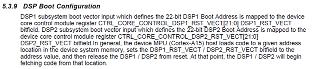

  • Hi Sasaki-san,
    Apologies for delay in response.
    I have checked, there is no restriction in booting the core in a particular sequence.
    Looking at the TRM section 5.3.9
    It shows that both the DSPs can be loaded independently. I am looking for some example that loads DSP2 and then DSP1.
    Can you please share what example are you trying to load to the DSPs?
    They are wondering if it would be possible to reduce the boot time by booting two DSP cores from the two tasks of ARM0.
    You can load both the cores using two tasks, but I don't think that would reduce boot time much, unless both the tasks are running on different cores, because a single core can handle only one task at any given point of time.
