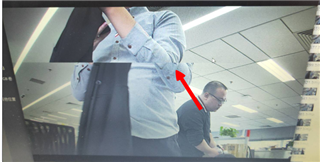

I run the following TIDL model witch model contains a Concat layer, the layer output size is 1x512x45x80,at the same time, run 8-channel camera capture,
Will most likely cause the view capture error。

Hi Praveen
The case implementation is roughly as follows :
When I collected an 8-channel image and ran a backbone model with tidl, I found that the image was abnormal.
I decomposed the model layer by layer and finally confirmed that it was the Concat problem.
The output size of this Concat is 1x512x45x80.
Tests that have been found to not cause problems are as follows:
1. Collect 1-channel images and run the model without problems
2. Collect 8-channel images, change the Concat output size to 1x256x45x80, there will be no problem
3. Collect 8-channel images, change the Concat output size to 1x512x30x80, there will be no problem
Increase in the number of acquisition channels(maybe 5 、 6 ...), or an increase in the size of the Concat output can cause problems.
