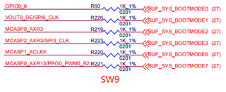

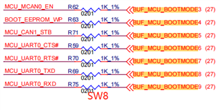

Hi Expert:
On our customized TDA4 board, after the SW8 and SW9 pins are pulled into the eMMC startup mode, the serial terminal does not output any information. The relevant details are as follows:
1. Dial code configuration:
    SW8[1-8] = 1000 0000
    SW9[1-8] = 0100 0000
2. SDKs:
    ti-processor-sdk-linux-j7-evm-08_00_00_08
    ti-processor-sdk-rtos-j721e-evm-08_00_00_12
3. Other introduction:
   The DIP circuit of SW8 and SW9 is the same as that of TDA4VM.
    eMMC can read, write and burn images normally.
Please help us analyze and locate the cause of the problem, and guide us to solve the problem correctly.
Thank you for your support and look forward to your reply.

    From the system startup log, after setting the "mmcdev" and "bootpart" environment variables, the system can work normally:
    => setenv mmcdev 0
    => setenv bootpart 0
    => boot
    But after I unplug the SD card, after I unplug the code into the eMMC startup configuration, the serial terminal does not output any information. The following is my eMMC code setting:
    Then I reconfigured to the boot mode of the SD card, the system can start normally and enter the rootfs, and through the "mount" command, we can see that the rootfs is successfully mounted to the 0:2 partition of the eMMC, and the following is my SD card pull code Setup and "mount" command records:
    SW8[1-8] = 1000 0010
    SW9[1-8] = 0000 0000

    There is one difference between the TDA4VM and TDA4VM in the dialing circuit of our custom board: the TCA6424ARGJR module is removed from the custom TDA4 board, and the other dialing circuit designs are the same. The following screenshots are the removed parts:
    My personal analysis: It may be that the eMMC dialing code is unsuccessful, and the eMMC boot mode is not detected when the system starts. If this possibility exists, how can I verify this conjecture from the software level?

  • The emmc startup problem has been solved. There is a problem with the DIP circuit of our custom TDA4 board. It has been modified. The last remaining problem of eMMC has been resubmitted to the case link: e2e.ti.com/.../3953581
