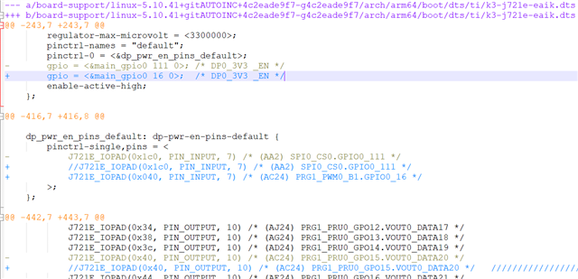

    I tried to set BUILD_MCU_BOARD_DEPENDENCIES to no in vision_apps_build_flags.mak to control ENABLE_DSS_SINGLE and ENABLE_DSS_EDP undefined, but it didn't work.
    I tried to commented out the line "name_overlays=k3-j721e-vision-apps.dtbo" in uEnv.txt file from the BOOT partition and save the file and exit. Then boot the board, it didn't work.
    The DP0_3V3_EN pin is changed from gpio0_111 to gpio0_16 on our customized board.
    I modified DP power in the K3-j721e-eaik.dts file accordingly, as follow:
    If I control the dss by R5F, should I make corresponding changes in RTOS and where to modify it?
    Thanks and Best Regards.
  • Hi Gao,
    I am bit confused. If you are planning to run vision apps demos, then DSS must be controlled by R5F, as the display node supported in vision apps runs on R5F. In this case, can you please make sure to install vision apps binaries in sd card, using "make linux_fs_install_sd"?
    If you are not planning to use vision apps, please remove vision apps dtbo file and also remove the line from uEnv.txt file as well. In fact, i would suggest to start a fresh, create a SD card, copy filesystem, and without installing vision_apps demo, boot with this SD card. You should see output on eDP on EVM.
    If you are trying it out on your board, please make board specific changes in the dtb files and then rebuild dtb files from PSDKLA, copy them into SD card and try it out.
    You are making above changes eaik.dts file, are you using this, ie EdgeAI demos? Otherwise, it will not be used and will not be setup..

  • Hi Brijesh
    The DP monitor is working properly.
    My hardware colleague modified a crystal oscillator to solve this problem.
    Thanks for your full support!
    Best Regards.
  • Hi Guifeng Gao,
    Could you please provide more information on the fix? What was the crystal you were using earlier and what changed fixed the issue?
    Brijesh
  • Hi Brijesh
    On our hardware, this X1301 is 20MHz,but reference design is 19.2MHz.
    I change the dss control from R5F to A72 and there is exception log output as follow:
    So hardware colleagues tried to modify the X1301 crystal oscillator to 19.2MHz and it took effect. There is no exception log, and the display can display normally.
