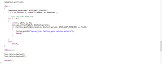

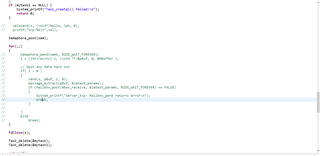

I set 6678 as Server and PC as Client respectively, and the connection between PC and 6678 is good.
Now, I use one thread to receive data, and it success. I could receive the hello string and the data I sent on PC
The other one thread is used for sending data, it failed. The message_upload is created on above function server_tcp() by API:   mytask1 = Task_create((ti_sysbios_knl_Task_FuncPtr)message_upload, &mytaskparams1, NULL);
But I couldn't receive the "upload:hello" from message_upload function, the return data of send() is -1, while the error is EBADF  9  // Bad file descriptor
Could you offer me some solutions?

    I added two semaphores to my codes, but it still doesn't work, maybe I didn't use semaphores correctly?
    The latest result is tcp_server could send and receive data, while the message_upload still couldn't send hello to PC.
    I guess the message_upload doesm't get the parameter of "socket s", because the message_upload didn't work when I deleted the code of for loop in tcp_server(). I think the tcp_server get the "socket s" when DaemonNew() executed, while the upload() get the "socket s" from the formal parameter of message_upload(socket s), however, I didn't pass the "socket s" to message_upload() when I use task_create().

  • Hi Zahir Wang,
    Please make "Socket s" as global and volatile. Then try with semaphore code. The socket descriptor needs to be same variable, if socket re opened for same port with different variable(In your scenario, it is two different local variable). Second thread only returns "-1", since socket is busy and could not be opened.

    Thanks for your help!
    Instead of using DaemonNew to create a socket, I used socket, bind, listen and accept to get the avaliable and global socket, and then I did it.
