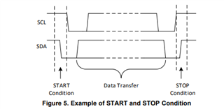

    I think as I understand it, i2cStart() transmits a "Setup Read", is that accurate?
  • Running the examples without the correct sensor will sooner or later give an error since the expected response will not be received. But as I understand it you are now able to see something on the I2C bus.
    From the Sensor Controller Documentation:
    "i2cStart
    Prototype: i2cStart()
    Clears state.i2cStatus and transmits start condition on the I2C bus."
    From https://www.ti.com/lit/an/slva704/slva704.pdf this should be:
    I2C issues are a bit difficult for us to debug since we don't have the same sensor and therefore are not able to test code.
    Have you compared the traffic on the I2C bus with what is described in the sensor datasheet? Start to read out a known value, typically the sensor has a register that contains a chip ID or similar.
