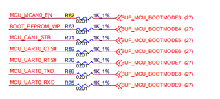

1. The circuit marked in red circle has been removed in the custom TDA4 board:

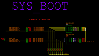

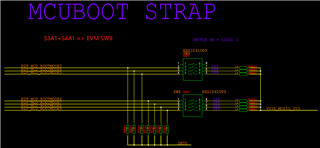

3. After removing the circuits described in 1 and 2 above from the custom TDA4 board, will the configuration of the SW8 and SW9 dip switches be affected?  The following is the custom TDA4 board DIP switch circuit design:
【SW8】
【SW9】
4. I have several questions about the EVM SW8, SW9 DIP switch configuration:
    a). What is the function of TCA6424ARGJR? Will the driver of this module change the configuration of the SW8 and SW9 DIP switches?
    b). After the pins of the SW8 and SW9 DIP switches are configured, is the level of the configured pins consistent with the level of the pins connected to the SOM TDA4 CPU? Here is my level configuration for testing SW9 on the SOM board:
