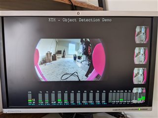

Hi E2E-Team,
It works fine everything if I manually run the application (like  /opt/vision_apps/vx_app_fcw_hba.out --cfg /opt/vision_apps/app_od_two_models.cfg) or through script(/home/root/hba.sh) in the console.
It does not work (camera feed) on autorun(autolaunch) at TDA4 power-on using the sytemctl command.  It runs(launch) the application(it shows CPU performance benchmarks in the bottom screen) but it does not show the camera image.  Please let me know the solution?
Script:-
root@j7-evm:/opt/vision_apps# cat /home/root/hba.sh
#! /bin/sh
cd /opt/vision_apps

    Are you running the "source ./vision_apps_init.sh" as a part of this script somewhere?
    And do you mind attaching the logs for when this fails versus when this is successful?
    Lucas
  • Hi Lucas,
    same result of with and without running  "source ./vision_apps_init.sh"
    I was running the script in background mode(/home/root/hba.sh &) to simulate the (systemctl start hba.service) issue and log. But its same effect of running "systemctl start hba.service"
    Please find the log

    root@j7-evm:/opt/vision_apps# /home/root/hba.sh &
    [2] 1512
    root@j7-evm:/opt/vision_apps# APP: Init ... !!!
    MEM: Init ... !!!
    MEM: Initialized DMA HEAP (fd=4) !!!
    MEM: Init ... Done !!!
    IPC: Init ... !!!
    IPC: Init ... Done !!!
    REMOTE_SERVICE: Init ... !!!
    REMOTE_SERVICE: Init ... Done !!!
    APP: Init ... Done !!!
      2833.474944 s:  VX_ZONE_INIT:Enabled
      2833.474971 s:  VX_ZONE_ERROR:Enabled
      2833.474988 s:  VX_ZONE_WARNING:Enabled
      2833.475640 s:  VX_ZONE_INIT:[tivxInit:69] Initialization Done !!!
      2833.475846 s:  VX_ZONE_INIT:[tivxHostInit:48] Initialization Done for HOST !!!
      2833.476667 s: ISS: Enumerating sensors ... !!!
      2833.477065 s: ISS: Enumerating sensors ... found 0 : IMX390-UB953_D3
      2833.477075 s: ISS: Enumerating sensors ... found 1 : AR0233-UB953_MARS
      2833.477094 s: ISS: Enumerating sensors ... found 2 : AR0820-MAX9295
      2833.477109 s: ISS: Enumerating sensors ... found 3 : UB9xxx_RAW12_TESTPATTERN
      2833.477123 s: ISS: Enumerating sensors ... found 4 : UB96x_UYVY_TESTPATTERN
      2833.477137 s: ISS: Enumerating sensors ... found 5 : GW_AR0233_UYVY
    Sensor selected : IMX390-UB953_D3
    Querying IMX390-UB953_D3
      2833.477173 s: ISS: Querying sensor [IMX390-UB953_D3] ... !!!
      2833.477360 s: ISS: Querying sensor [IMX390-UB953_D3] ... Done !!!
      2833.477379 s:  VX_ZONE_INIT:[update_img_mosaic_defaults:1543] main.c: mosaic_counter if condition: 1
      2833.477396 s:  VX_ZONE_INIT:[app_update_param_set:1637] update_draw_detections_defaults in app_update_param_set
    [MCU2_0]   2833.476784 s: ImageSensor_RemoteServiceHandler: IM_SENSOR_CMD_CREATE
    [MCU2_0]   2833.476853 s: Sensor at index 0 = IMX390-UB953_D3
    [MCU2_0]   2833.476886 s: Sensor at index 1 = AR0233-UB953_MARS
    [MCU2_0]   2833.476909 s: Sensor at index 2 = AR0820-MAX9295
    [MCU2_0]   2833.476931 s: Sensor at index 3 = UB9xxx_RAW12_TESTPATTERN
    [MCU2_0]   2833.476957 s: Sensor at index 4 = UB96x_UYVY_TESTPATTERN
    [MCU2_0]   2833.476981 s: Sensor at index 5 = GW_AR0233_UYVY
    [MCU2_0]   2833.477239 s: ImageSensor_RemoteServiceHandler: IM_SENSOR_CMD_QUERY
    [MCU2_0]   2833.477292 s: Received Query for IMX390-UB953_D3
      2833.484411 s: ISS: Initializing sensor [IMX390-UB953_D3], doing IM_SENSOR_CMD_PWRON ... !!!
    [MCU2_0]   2833.484498 s: ImageSensor_RemoteServiceHandler: IM_SENSOR_CMD_PWRON
    [MCU2_0]   2833.484556 s: IM_SENSOR_CMD_PWRON : channel_mask = 0x1
    [MCU2_0]   2833.484656 s: IMX390_PowerOn : chMask = 0x1
    [MCU2_0]   2834.084107 s: ub960_cfgScript : ub960I2cAddr = 0x30
    [MCU2_0]   2834.084169 s: UB960 config start
      2834.284508 s: ISS: Initializing sensor [IMX390-UB953_D3], doing IM_SENSOR_CMD_CONFIG ... !!!
    [MCU2_0]   2834.284370 s:  End of UB960 config
    [MCU2_0]   2834.284609 s: ImageSensor_RemoteServiceHandler: IM_SENSOR_CMD_CONFIG
    [MCU2_0]   2834.284665 s: Application requested features = 0x158
    [MCU2_0]
    [MCU2_0]   2834.284704 s: ub960_cfgScript : ub960I2cAddr = 0x30
    [MCU2_0]   2834.284731 s: UB960 config start
    [MCU2_0]   2834.540198 s:  End of UB960 config
    [MCU2_0]   2834.540262 s: ub960_cfgScript : ub960I2cAddr = 0x3d
    [MCU2_0]   2834.540293 s: UB960 config start
    [MCU2_0]   2834.796142 s:  End of UB960 config
    [MCU2_0]   2834.796200 s: Configuring camera # 0
    [MCU2_0]   2834.796232 s: ub953 config start : slaveAddr = 0x64
    [MCU2_0]   2834.986199 s:  End of UB953 config
    [MCU2_0]   2834.986253 s:  Configuring IMX390 imager 0x40.. Please wait till it finishes
      2837.066297 s: ISS: Initializing sensor [IMX390-UB953_D3] ... Done !!!
    [MCU2_0]   2837.066109 s:  IMX390 config done
    [MCU2_0]   2837.066171 s: IM_SENSOR_CMD_CONFIG returning status = 0
    Scaler output1 width   = 512
    Scaler output1 height  = 512
    Scaler output2 width   = 1024
    Scaler output2 height  = 512
    Computing checksum at 0x0000FFFF79A5AE80, size = 911672
      2837.675339 s:  VX_ZONE_REFERENCE:Enabled
    Computing checksum at 0x0000FFFF78DA9CC0, size = 357656
      2837.979842 s:  VX_ZONE_REFERENCE:Enabled
      2837.979913 s:  VX_ZONE_INIT:[displayTIDLOutput:1149] app_tidl:  Speed limit (20km/h), class-id: 0, score: 0
      2838.023184 s:  VX_ZONE_INIT:[app_create_graph:982] main.c before create graph preprococ
      2838.023259 s:  VX_ZONE_INIT:[app_create_graph:985] main.c after create graph preprococ
      2838.023282 s:  VX_ZONE_INIT:[app_create_graph:990] main.c before create graph tidloc
      2838.023380 s:  VX_ZONE_INIT:[app_create_graph:992] main.c after create graph tidloc
      2838.023503 s:  VX_ZONE_INIT:[app_create_graph:1042] Gaussian node done
      2838.023572 s:  VX_ZONE_INIT:[app_create_graph:1054] Erode node done
      2838.023676 s:  VX_ZONE_INIT:[app_create_graph:1065] Dilate node done
      2838.023750 s:  VX_ZONE_INIT:[app_create_graph:1074] minval init:   2838.023753 s:  VX_ZONE_INIT:[app_create_graph:1076]
     maxval init:   2838.023768 s:  VX_ZONE_INIT:[app_create_graph:1078]
    [C7x_1 ]   2838.289319 s:  VX_ZONE_WARNING:[tivxKernelTIDLCreate:698] All Interrupts DISABLED during TIDL process
    [C7x_1 ]   2838.354781 s:  VX_ZONE_WARNING:[tivxKernelTIDLCreate:698] All Interrupts DISABLED during TIDL process
     maxval count init:   2838.468851 s: ISS: Starting sensor [IMX390-UB953_D3] ... !!!
    [MCU2_0]   2838.469227 s: ImageSensor_RemoteServiceHandler: IM_SENSOR_CMD_STREAM_ON
    [MCU2_0]   2838.469299 s: IM_SENSOR_CMD_STREAM_ON:  channel_mask = 0x1
    [MCU2_0]   2838.469340 s: ub960_cfgScript : ub960I2cAddr = 0x30
    [MCU2_0]   2838.469368 s: UB960 config start
    [MCU2_0]   2838.725203 s:  End of UB960 config
    [MCU2_0]   2838.725266 s: ub960_cfgScript : ub960I2cAddr = 0x3d
    [MCU2_0]   2838.725297 s: UB960 config start
    [MCU2_0]   2838.981151 s:  End of UB960 config
    [MCU2_0]   2838.981207 s: Starting camera # 0
    [MCU2_0]   2838.981233 s: Entering IssSensor_Start
    [MCU2_0]   2838.991148 s: enableUB960Streaming ub960InstanceId = 0
    [MCU2_0]   2838.991337 s: ub960_cfgScript : ub960I2cAddr = 0x30
    [MCU2_0]   2838.991371 s: UB960 config start
      2839.023343 s: ISS: Starting sensor [IMX390-UB953_D3] ... !!!
     HM KTM - Camera based Object Detection
     p: Print performance statistics
     x: Exit
     Enter Choice:   2839.023651 s:  VX_ZONE_INIT:[displayTIDLOutput:1149] app_tidl:  Speed limit (20km/h), class-id: 0, score: 0
      2839.023932 s:  VX_ZONE_INIT:[app_run_graph_for_one_frame_pipeline:1249] g_switch_count: 1
    [MCU2_0]   2839.023200 s:  End of UB960 config
      2839.024161 s:  VX_ZONE_INIT:[app_run_graph_for_one_frame_pipeline:1273]
     maxval  count high condition: 0
      2839.024318 s:  VX_ZONE_INIT:[app_run_graph_for_one_frame_pipeline:1275] entering high beam
    [MCU2_0]   2864.970227 s: DHCP client timed out. Retrying.....
