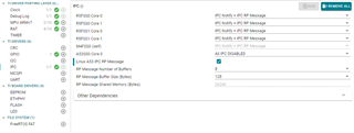

2. Once you verify the LED blink example works fine through CCS, you can add IPC through syscfg tool so that the program can be loaded from Linux. Simply open example.syscfg of the CCS project and add IPC as below.

one more for you my customer does not want to use CCS to setup the syscfg file. Can you point how to do this without CCS please?

Syscfg file can be opened from command line. Please refer to the MCU+ SDK documentation: https://software-dl.ti.com/mcu-plus-sdk/esd/AM64X/latest/exports/docs/api_guide_am64x/SYSCONFIG_INTRO_PAGE.html.
ok i think i got it to work. The only thing which you don't need to do is remove the symbols. You can just use the .out that gets created. remoteprog knows how to handle the symbols. Also you can use the sysconf stand alone to change the mode from non IPC to IPC. That way no need for ccs.
