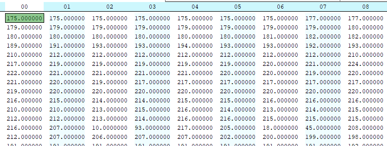

I am now using the QAT model on the PC to get the intermediate results.
I found that the preprocessing result is wrong.
The settings on import.txt are as follows:
inDataNorm = 1
inMean = 0 0 0
inScale = 0.00392157 0.00392157 0.00392157
layer0 value is:
layer1 value is:

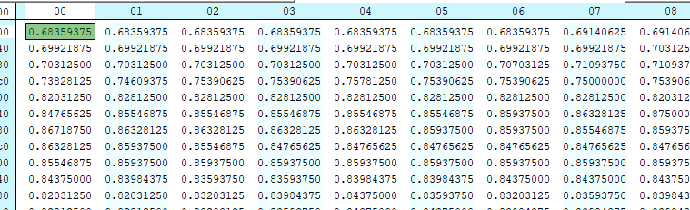

For example, the first value should be 175 * 0.00392157 = 0.68627475, right?

  • Hi Henry, Sorry about the delay in replying.
    Inside TIDL, the mean subtraction and scaling is happening in fixed point.
    will be quantized first to 8bits (if you are using 8bit mode in TIDL) and the operation will happen in fixed point.
    That is the reason why you are seeing this difference with the result of floating point operation.
    TIDL also has a floating point simulation mode in PC (won't work in EVM) and in that, this quantization is not there.
