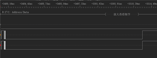

    In mcu domain, i use I2C2 communicate with slave device,now i think the controller aways die。The scenario is like this: after reading or writing some registers,slave will pull down sda scl at the same time,after about 32Ms,sda  scl will pull high again。After that,the sda scl aways has no data, although i send data,but the bus always high,or the signal is abnormal, can't communicate normally。

  • Strictly speaking, it is not pulling down and pulling up at the same time,You can refer to the diagram I provided。  I‘m almost sure that ’this pull down and pull up is initiated by slave.
    then my question is ,the controller is unable to withstand this pull-down and pull-up action? The controller seems to have died after this,As I said earlier,the sda scl aways has no data, although i send data,but the bus always high,or the signal is abnormal, can't communicate normally。
