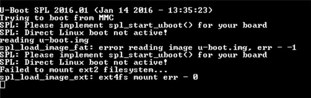

Seems it is possible to boot from SD card.
What is the default mac id of IDKam4376 board.
I am trying to boot from SD card but its not working.
I am not using linux or TI provided MLO files.
FIles i am using works fine with evm4376 board.
Can you suggest what to look for ?
facing below issue.
