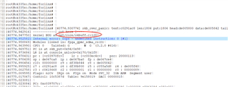

AM3354: Kernel crashes with network traffic
Part Number: AM3354
Hi team
Our customer encountered a problem of using the network port, which has a probability of crashing, and found a similar error in your forum. There is a post saying that it is a bug of linux 3.2. The problem has been solved on your latest version, but it is currently updated to The workload on the latest kernel is too large. Is there any patch patch to solve the problem for our reference?
https://e2e.ti.com/support/processors-group/processors/f/processors-forum/530328/am335x-kernel-crashes-with-network-traffic

root@ok335x:/home/forlinx# [40774.930774] skb_over_panic: text:c0291ac8 len:1806 put:1806 head:de005800 data:de005842 tail:0xde005f50 end:0xde005f40 dev:eth0
[40774.942916] ------------[ cut here ]------------
[40774.947750] kernel BUG at net/core/skbuff.c:128!
[40774.952582] Internal error: Oops - undefined instruction: 0 [#1]
[40774.958869] Modules linked in: fpga_gpmc_edma_cs(O)
[40774.963990] CPU: 0    Tainted: G        W  O  (3.2.0 #616)
[40774.969751] PC is at skb_put+0x94/0x98
[40774.973686] LR is at console_unlock+0x170/0x1f8
[40774.978431] pc : [<c03970fc>]    lr : [<c003ec4c>]    psr: 20000113
[40774.978439] sp : de067ca8  ip : de067ba0  fp : de067ce4
[40774.990456] r10: 00000000  r9 : df38b844  r8 : de005842
[40774.995925] r7 : c0291ac8  r6 : df38b800  r5 : c055a5d8  r4 : de005f40
[40775.002758] r3 : c0618668  r2 : 00000001  r1 : 00000000  r0 : 00000089
[40775.009595] Flags: nzCv  IRQs on  FIQs on  Mode SVC_32  ISA ARM  Segment user
[40775.017067] Control: 10c5387d  Table: 9e158019  DAC: 00000015
[40775.023081]

log is also attached.
BR
Brandon
    Unfortunately TI does not maintain a patch set to resolve kernel issues.  Also this kernel is beyond a version that TI can support.
    The skb_over_panic is saying the size of the packet is 1806, perhaps this is too large. From what I see here I cannot tell where the packet was destined to go to. For example the cpsw Linux driver cannot handle packets larger than 1522.
    Schuyler
