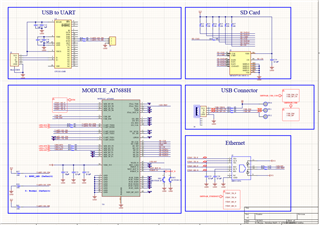

Hi I'm Freya. I'm fresher Hardware Designer. I want to find a CPU has these interfaces : 1 Ethernet, 1 SDIO, 2 UART, 1 USB , 52 GPIO, 1 SPI. It could communicate with server by Things Board, It could have the operating system like Linux, Window. It could learn like AI to run the script follow the data we gave. Lastest version we designed this device by using 2 CPU: module AI7688H and MCU STM32F407ZGT6. STM32F407ZGT6 just used for GPIO interfaces and communicate with CPU module AI7688H by UART
      Our TM4C129 MCU can meet most of your requirements. However, it does not have SDIO interface. You can use the SPI on the MCU to interface with the SD card. Another thing is that TM4C129 does not support Linux or Windows OS.  Currently we only support TI-RTOS (a real-time OS for embedded systems). Please refer to the product selection guide to determine with part number will be best fit for your applications.
