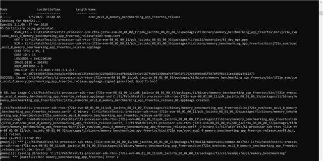

  • I seem to get a similar error.
    process_begin: CreateProcess(C:\ti\ti-processor-sdk-rtos-j721e-evm-08_01_00_11\pdk_jacinto_08_01_00_33\packages\ti\binary\memory_benchmarking_app_freertos\bin\j721e_evm\ocmc_mcu1_0_memory_benchmarking_app_freertos_release.xer5f, C:/ti/ti-processor-sdk-rtos-j721e-evm-08_01_00_11/pdk_jacinto_08_01_00_33/packages/ti/binary/memory_benchmarking_app_freertos/bin/j721e_evm/ocmc_mcu1_0_memory_benchmarking_app_freertos_release.xer5f -O binary C:/ti/ti-processor-sdk-rtos-j721e-evm-08_01_00_11/pdk_jacinto_08_01_00_33/packages/ti/binary/memory_benchmarking_app_freertos/bin/j721e_evm/ocmc_mcu1_0_memory_benchmarking_app_freertos_release.xer5f.bin, ...) failed.
    make (e=193): Error 193
    gmake[1]: *** [C:/ti/ti-processor-sdk-rtos-j721e-evm-08_01_00_11/pdk_jacinto_08_01_00_33/packages/ti/build/makerules/common.mk:740: C:/ti/ti-processor-sdk-rtos-j721e-evm-08_01_00_11/pdk_jacinto_08_01_00_33/packages/ti/binary/memory_benchmarking_app_freertos/bin/j721e_evm/ocmc_mcu1_0_memory_benchmarking_app_freertos_release.xer5f.bin] Error 193
    gmake[1]: Leaving directory 'C:/ti/ti-processor-sdk-rtos-j721e-evm-08_01_00_11/pdk_jacinto_08_01_00_33/packages/ti/csl/example/ospi/memory_benchmarking'
    gmake: *** [makefile:363: memory_benchmarking_app_freertos] Error 2

  • The only thing I have changed is the XDC tool version on pdk_tools_path.mk.
    Here is the Log;

    # SBL App image C:/ti/ti-processor-sdk-rtos-j721e-evm-08_01_00_11/pdk_jacinto_08_01_00_33/packages/ti/binary/memory_benchmarking_app_freertos/bin/j721e_evm/ocmc_mcu1_0_memory_benchmarking_app_freertos_release.appimage and C:/ti/ti-processor-sdk-rtos-j721e-evm-08_01_00_11/pdk_jacinto_08_01_00_33/packages/ti/binary/memory_benchmarking_app_freertos/bin/j721e_evm/ocmc_mcu1_0_memory_benchmarking_app_freertos_release_BE.appimage created.
    C:\ti\ti-processor-sdk-rtos-j721e-evm-08_01_00_11\pdk_jacinto_08_01_00_33\packages\ti\build>

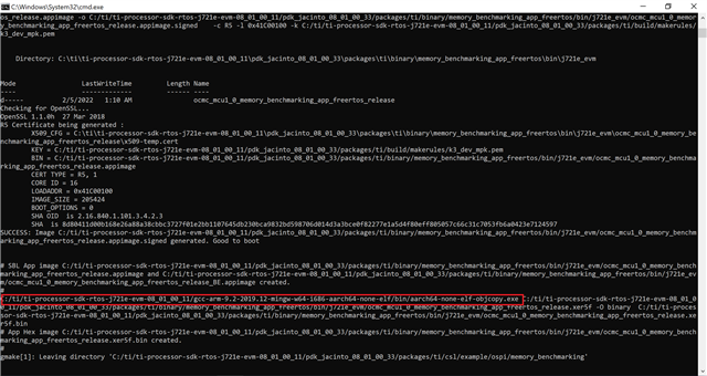

  • Hey,
    Looks like this application has some dependency on gcc arm toolchain.
    Here are my logs:
    C:\ti\ti-processor-sdk-rtos-j721e-evm-08_01_00_11\pdk_jacinto_08_01_00_33\packages\ti\build>gmake BOARD=j721e_evm CORE=mcu1_0 memory_benchmarking_app_freertos

    C:/ti/ti-processor-sdk-rtos-j721e-evm-08_01_00_11/xdctools_3_61_04_40_core/bin/echo a+x C:/ti/ti-processor-sdk-rtos-j721e-evm-08_01_00_11/pdk_jacinto_08_01_00_33/packages/ti/boot/sbl/tools/multicoreImageGen/bin/MulticoreImageGen.exe
    C:/ti/ti-processor-sdk-rtos-j721e-evm-08_01_00_11/pdk_jacinto_08_01_00_33/packages/ti/boot/sbl/tools/xipGen/xipGen.exe -i C:/ti/ti-processor-sdk-rtos-j721e-evm-08_01_00_11/pdk_jacinto_08_01_00_33/packages/ti/binary/memory_benchmarking_app_freertos/bin/j721e_evm/ocmc_mcu1_0_memory_benchmarking_app_freertos_release.rprc_tmp -o C:/ti/ti-processor-sdk-rtos-j721e-evm-08_01_00_11/pdk_jacinto_08_01_00_33/packages/ti/binary/memory_benchmarking_app_freertos/bin/j721e_evm/ocmc_mcu1_0_memory_benchmarking_app_freertos_release.rprc -x C:/ti/ti-processor-sdk-rtos-j721e-evm-08_01_00_11/pdk_jacinto_08_01_00_33/packages/ti/binary/memory_benchmarking_app_freertos/bin/j721e_evm/ocmc_mcu1_0_memory_benchmarking_app_freertos_release.rprc_xip --flash-start-addr 0x50000000 -v > C:/ti/ti-processor-sdk-rtos-j721e-evm-08_01_00_11/pdk_jacinto_08_01_00_33/packages/ti/binary/memory_benchmarking_app_freertos/bin/j721e_evm/temp_stdout.txt
    C:/ti/ti-processor-sdk-rtos-j721e-evm-08_01_00_11/pdk_jacinto_08_01_00_33/packages/ti/boot/sbl/tools/multicoreImageGen/bin/MulticoreImageGen.exe LE 55 C:/ti/ti-processor-sdk-rtos-j721e-evm-08_01_00_11/pdk_jacinto_08_01_00_33/packages/ti/binary/memory_benchmarking_app_freertos/bin/j721e_evm/ocmc_mcu1_0_memory_benchmarking_app_freertos_release.appimage     4 C:/ti/ti-processor-sdk-rtos-j721e-evm-08_01_00_11/pdk_jacinto_08_01_00_33/packages/ti/binary/memory_benchmarking_app_freertos/bin/j721e_evm/ocmc_mcu1_0_memory_benchmarking_app_freertos_release.rprc >> C:/ti/ti-processor-sdk-rtos-j721e-evm-08_01_00_11/pdk_jacinto_08_01_00_33/packages/ti/binary/memory_benchmarking_app_freertos/bin/j721e_evm/temp_stdout.txt
    C:/ti/ti-processor-sdk-rtos-j721e-evm-08_01_00_11/pdk_jacinto_08_01_00_33/packages/ti/boot/sbl/tools/multicoreImageGen/bin/MulticoreImageGen.exe LE 55 C:/ti/ti-processor-sdk-rtos-j721e-evm-08_01_00_11/pdk_jacinto_08_01_00_33/packages/ti/binary/memory_benchmarking_app_freertos/bin/j721e_evm/ocmc_mcu1_0_memory_benchmarking_app_freertos_release.appimage_xip 4 C:/ti/ti-processor-sdk-rtos-j721e-evm-08_01_00_11/pdk_jacinto_08_01_00_33/packages/ti/binary/memory_benchmarking_app_freertos/bin/j721e_evm/ocmc_mcu1_0_memory_benchmarking_app_freertos_release.rprc_xip >> C:/ti/ti-processor-sdk-rtos-j721e-evm-08_01_00_11/pdk_jacinto_08_01_00_33/packages/ti/binary/memory_benchmarking_app_freertos/bin/j721e_evm/temp_stdout.txt
    C:/ti/ti-processor-sdk-rtos-j721e-evm-08_01_00_11/pdk_jacinto_08_01_00_33/packages/ti/boot/sbl/tools/multicoreImageGen/bin/MulticoreImageGen.exe BE 55 C:/ti/ti-processor-sdk-rtos-j721e-evm-08_01_00_11/pdk_jacinto_08_01_00_33/packages/ti/binary/memory_benchmarking_app_freertos/bin/j721e_evm/ocmc_mcu1_0_memory_benchmarking_app_freertos_release_BE.appimage  4 C:/ti/ti-processor-sdk-rtos-j721e-evm-08_01_00_11/pdk_jacinto_08_01_00_33/packages/ti/binary/memory_benchmarking_app_freertos/bin/j721e_evm/ocmc_mcu1_0_memory_benchmarking_app_freertos_release.rprc >> C:/ti/ti-processor-sdk-rtos-j721e-evm-08_01_00_11/pdk_jacinto_08_01_00_33/packages/ti/binary/memory_benchmarking_app_freertos/bin/j721e_evm/temp_stdout.txt
    powershell -executionpolicy unrestricted -command C:/ti/ti-processor-sdk-rtos-j721e-evm-08_01_00_11/pdk_jacinto_08_01_00_33/packages/ti/build/makerules/x509CertificateGen.ps1 -b C:/ti/ti-processor-sdk-rtos-j721e-evm-08_01_00_11/pdk_jacinto_08_01_00_33/packages/ti/binary/memory_benchmarking_app_freertos/bin/j721e_evm/ocmc_mcu1_0_memory_benchmarking_app_freertos_release.appimage -o C:/ti/ti-processor-sdk-rtos-j721e-evm-08_01_00_11/pdk_jacinto_08_01_00_33/packages/ti/binary/memory_benchmarking_app_freertos/bin/j721e_evm/ocmc_mcu1_0_memory_benchmarking_app_freertos_release.appimage.signed    -c R5 -l 0x41C00100 -k C:/ti/ti-processor-sdk-rtos-j721e-evm-08_01_00_11/pdk_jacinto_08_01_00_33/packages/ti/build/makerules/k3_dev_mpk.pem
        Directory: C:\ti\ti-processor-sdk-rtos-j721e-evm-08_01_00_11\pdk_jacinto_08_01_00_33\packages\ti\binary\memory_benchmarking_app_freertos\bin\j721e_evm
    Mode                 LastWriteTime         Length Name
    d-----          2/5/2022   1:10 AM                ocmc_mcu1_0_memory_benchmarking_app_freertos_release
    Checking for OpenSSL...
    OpenSSL 1.1.0h  27 Mar 2018
    R5 Certificate being generated :
            X509_CFG = C:\ti\ti-processor-sdk-rtos-j721e-evm-08_01_00_11\pdk_jacinto_08_01_00_33\packages\ti\binary\memory_benchmarking_app_freertos\bin\j721e_evm\ocmc_mcu1_0_memory_benchmarking_app_freertos_release\x509-temp.cert
            KEY = C:/ti/ti-processor-sdk-rtos-j721e-evm-08_01_00_11/pdk_jacinto_08_01_00_33/packages/ti/build/makerules/k3_dev_mpk.pem
            BIN = C:/ti/ti-processor-sdk-rtos-j721e-evm-08_01_00_11/pdk_jacinto_08_01_00_33/packages/ti/binary/memory_benchmarking_app_freertos/bin/j721e_evm/ocmc_mcu1_0_memory_benchmarking_app_freertos_release.appimage
            CERT TYPE = R5, 1
            CORE ID = 16
            LOADADDR = 0x41C00100
            IMAGE_SIZE = 205424
            BOOT_OPTIONS = 0
            SHA OID  is 2.16.840.1.101.3.4.2.3
            SHA  is 8d80411d00b168e26a88a38cbbc3727f01e2bb1107645db230bca9832bd598706d014d3a3bce0f82277e1a5d4f80eff805057c66c31c7053fb6a0423e7124597
    SUCCESS: Image C:/ti/ti-processor-sdk-rtos-j721e-evm-08_01_00_11/pdk_jacinto_08_01_00_33/packages/ti/binary/memory_benchmarking_app_freertos/bin/j721e_evm/ocmc_mcu1_0_memory_benchmarking_app_freertos_release.appimage.signed generated. Good to boot
    C:/ti/ti-processor-sdk-rtos-j721e-evm-08_01_00_11/gcc-arm-9.2-2019.12-mingw-w64-i686-aarch64-none-elf/bin/aarch64-none-elf-objcopy.exe C:/ti/ti-processor-sdk-rtos-j721e-evm-08_01_00_11/pdk_jacinto_08_01_00_33/packages/ti/binary/memory_benchmarking_app_freertos/bin/j721e_evm/ocmc_mcu1_0_memory_benchmarking_app_freertos_release.xer5f -O binary  C:/ti/ti-processor-sdk-rtos-j721e-evm-08_01_00_11/pdk_jacinto_08_01_00_33/packages/ti/binary/memory_benchmarking_app_freertos/bin/j721e_evm/ocmc_mcu1_0_memory_benchmarking_app_freertos_release.xer5f.bin
    # App Hex image C:/ti/ti-processor-sdk-rtos-j721e-evm-08_01_00_11/pdk_jacinto_08_01_00_33/packages/ti/binary/memory_benchmarking_app_freertos/bin/j721e_evm/ocmc_mcu1_0_memory_benchmarking_app_freertos_release.xer5f.bin created.
    As you can see, towards the end the it is looking for gcc-arm-9.2-2019.12-mingw-w64-i686-aarch64-none-elf at <SDK_Install_Path>.
    When I removed this folder, I ran into similar issue as yours. Can you please confirm if that toolchain is available in your SDK? If it is not there, you can download it from https://developer.arm.com/tools-and-software/open-source-software/developer-tools/gnu-toolchain/gnu-a/downloads/9-2-2019-12.

  • I did not have that file, I downloaded it into the the SDK folder stated in the Rules.make file. Still get an error. I may have the impression that there are some dependencies missing. However, the logs does not mention what I am missing nor does the SDK user guide states what is need.
  • No, there is something wrong with the tool chain you downloaded. If I remove gcc-arm-9.2-2019.12-mingw-w64-i686-aarch64-none-elf folder from my SDK folder, I am running into exactly the same error as yours.
    Can you share the screenshot of your SDK folder?
  • Hey,
    I was able to build, Thanks!
    I accidently downloaded the gcc-arm-9.2-2019.12-mingw-w64-i686-arm-none-eabi.tar.xz
