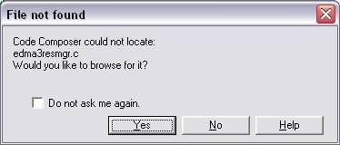

We modified the "test_2D2D_nointr" function to copy the data from DDR2 to L1 cache. The same code when we used in our project to copy the data, the EDMA3_DRV_requestChannel goes for infinite loop after second time onwards and when we try to halt the execution, a below mentioned pop-up window will appeared.

    The source file being sought in the CCS dialog is just looking for the EDMA3 LLD file that was compiled and archived into the EDMA3 LLD library. It is natural that its location is not known within your project, so you could browse for it if you wish. The more helpful thing would be to look at your arguments to EDMA3_DRV_requestChannel and figure out why it might have a problem with being called a second time.
    There is no way to tell from here if the copy into L1D cache is causing your problem or if it is the arguments to your requestChannel function. But these are two important places for you to study.
