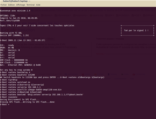

I wish to configure my SDK with the Environment Setup Script (setup.sh).
However, after completing the various steps of the Setup Script, this one fail during the Load Script uboot.
I folow The OMAPL138 Software Developers Guide and I do not really understand how to solve this problem.
  • Which part of this failed? It looks like it wrote the correct environmental variables and saved it to the SPI flash. Now you can just reboot the board and it should boot Linux.
    Jeff

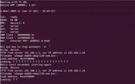

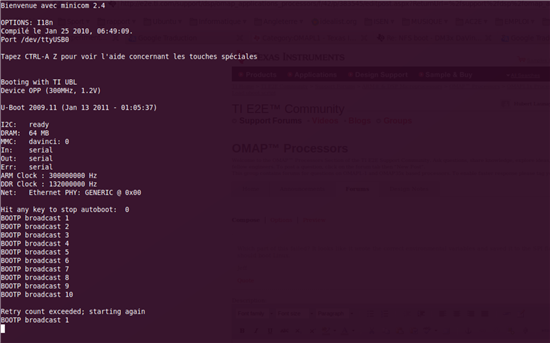

  • The problem is that when I boot the board, Linux do not start and displays:
    The TFTP server seems to be configured correctly  and I have no firewall on my computer (10.04 LTS).

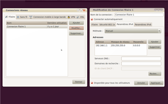

  • I have connected the board to my computer via a hub and two straight cables, but communication still fails.
    Here is my network configuration:
    Soon, I'll try with a crossover cable.

  • The SDK install script assumes a set up involving a router with DHCP so using the switch or hub won't work.
    If you want to use direct connect, you need to assign static IPs on both the Linux PC and EVM. Cross-over type cable is not necessary.
    On the EVM, you need to modify the bootargs by replacing ip=dhcp with ip=<EVM static IP address>, and remove the "dhcp" part in the 'bootcmd' environment variable
    For example, let's say you want to use static IP addresses 192.168.1.101 for the EVM and 192.168.1.105 for the Linux PC. On the PC, assign the static IP 192.168.1.105 as per the direction for Ubuntu 10.04. On the EVM, boot the EVM to u-boot command prompt and modify the u-boot settings:

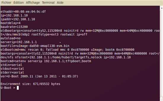

  • I changed the bootargs like this:
    but it still does not work.
  • You still have the server ip address missing from the bootargs. On the first screen above, your "nfsroot=" should have the static ip address that you have assigned to the server (host Linux PC). If it is 192.168.1.1, then the bootargs should show   ".... root=/dev/nfs nfsroot=192.168.1.1:/home/hubert/targetfs,nolock ..."

  • Indeed, it works well ...
    Thank you for your help.
    For information, here is my final configuration of U-boot:
  • If the serverip is already saved, you can remove the "setenv serverip 192.168.1.1" from the boot command.
