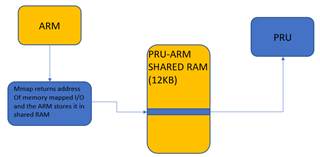

  • HI Nick,
    According to our customer,
    So, after doing some reading I’ve come to believe that you can not use mmap on the PRU due to the lack of an OS on the PRU (correct me if I am wrong). So, I came up with an idea to get access to the am335x registers from the pru by using mmap from the ARM side in the user space and I would like to know if it could work or if you have any ideas. My idea is to call mmap from a user space program and have it create a block of memory that has access to /dev/mem (so mapped I/O) and mmap will return the starting address to this block of memory that contains the mapped I/O. This starting address is then stored into the PRU-ARM 12KB shared RAM and then the PRU can access the mapped I/O from the starting address that’s stored into the shared RAM. I believe this will provide the PRU access to the I2C registers that are on the ARM side. I included an image to try to make this a bit clearer.
    Danilo
  • Hello Danilo,
    First caveat: check the AM335x version
    Note that AM3351 does not have PRU-ICSS. Make sure the customer references the AM335x Datasheet "Device Features Comparison" to make sure they are using a part number with PRU in it.
    Accessing memory locations from the PRU
    Please point the customer to the PRU Software Support Package. You can find that in the Linux Processor SDK under example-applications/pru-icss-x.x.x, or at the git repo: https://git.ti.com/cgit/pru-software-support-package/pru-software-support-package/
    I
    f using the git repo, please make sure you are using the version of PSSP that corresponds to your version of Linux. For example, if the customer is using Linux kernel 5.4 or earlier, they should use PSSP v5.9 or earlier. The PSSP packaged in the Linux SDK will always be compatible with the Linux SDK kernel version.
    For an example of using PRU to control another peripheral on the processor (including how to access specific register and memory locations), take a look at examples/am335x/PRU_ADC_onChip/pru_adc_firmware.c. The PRU can directly access the I2C registers without ARM involvement. See the example README for more.
    The PRU can read any area of memory, and write to any area of memory that does not require elevated permissions (e.g., PRU does not have the permissions to change pinmux settings).

  • Hi Nick,
    Hi, this does resolve my issue but I was wondering if since I am accessing the i2c from the pru is the performance still deterministic with no jitter? Or can I expect the same i2c performance on the pru side as if I was accessing the it from the arm side?
    Danilo

  • Hello Danilo,
    Thank you for the pings.
    For information on PRU read latencies, please see this app note:
    https://www.ti.com/lit/sprace8
    In general, reads to memory locations within the PRU-ICSS are deterministic. (the one edge case is if a core external to the PRU-ICSS is accessing that memory at the exact same time - in that case, bus arbitration needs to occur. But it doesn't sound like we need to do a deep dive on that concept for this customer usecase).
    Reads outside of the PRU-ICSS use the system busses. Those reads are no longer 100% deterministic, because other cores might be using the busses at the same time. However, I would still expect PRU accesses to the I2C to have less jitter than ARM accesses since you don't have to deal with all the scheduling challenges of the Linux OS.
