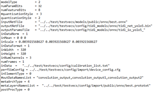

I trained the model of edgeai-yolov5 and got the prototxt file and the onnx file with the new export.py. After that, I complied the onnx model file to a int8 bin file and a float32 bin file. I run these two bin file with the PC_dsp_test_dl_algo.out file in ti-processor-sdk-rtos-j721e-evm-08_01_00_11/tidl_j7_08_01_00_05/ti_dl/test, and found bin file of float32 can't get the right result.
The following picture is the import config. In the file, I set numParamBits = 8 and run tidl_model_import.out to get the bin file of int8

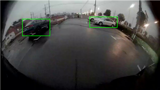

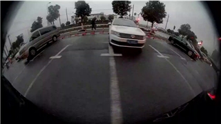

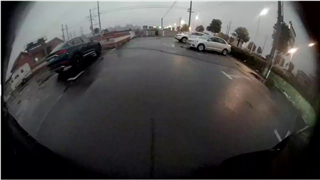

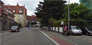

The result of float32 inference

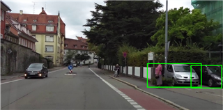

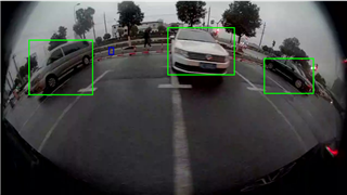

The result of int8 inference
It can be seen from the picture above that the inference result of the float32 model has no rectangle found. Is there some thing wrong with my config file? Why the bin file of float32 can't get the right inference result?

Because I will use the model of int8 in TDA4, is the above import config file right for the int8 bin file?
    We have identified a bug in float32 mode recently[1833] . It will fixed in sdk8.2 release. In the meantime, you can try in 16 bits for close to float accuracy.
    Regarding the config , set numParamBits = 8 as well. For better accuracy in 8 bit, you can use advance calibration by setting calibrationOption=7 and more number of frames(~50) for calibration.

    I have compare your config and mine, and found numFrames is different. When I set numFrames = 50 as yours, the accuracy in int8 mode will be improved.
    So what is the function of this parameter? when I set numFrames = 10 and numFrames = 50, the inference result is different. Which value of numFrames is required to be set that can works for good accuracy in int8 mode.
     You can set numFrames=50 and calibrationOption = 7 to improve the accuracy. Generally speaking, more the number of frames, better will be the  quantization. This will increase the time taken to import the model significantly. However, the accuracy will be better as well.
