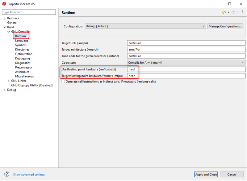

    How do I remove/disable the settings -mfpu=neon -mfloat-abi=hard ?
    Assuming you are using a CCS project, check the "Runtime" options in the project properties:
    ki
  • Ki,
    Thanks for the try.  But that is NOT giving me the control I need.  I've been hacking on this for a while...
    If I change the setting in the properties, I get an error that it's "not compatible" with the other setting (which the opt file injected).
    Something, somewhere is creating the compiler.opt file, on the fly.  Probably in XDC, or something in the CFG file, which I can never find any doc on.
    It's not related to anything in CCS, so I don't know why they even brought you into it.
    How is this compiler.opt file created, and how do I control it?
    (Now they are telling me they are dropping support for all this.  Well, I don't need anything fixed.  I need it explained how this is happening...  you like actual doc that I can locate... and explanation how I can control it )

  • Yeah, the opt file has these:
    -mcpu=cortex-a8
    -mfpu=neon
    -mfloat-abi=hard
    -mabi=aapcs
    -g
    -Dxdc_target_types__="gnu/targets/arm/std.h"
    -Dxdc_target_name__=A8F
    -Dxdc_cfg__xheader__="\"C:/.../Test/Release/configPkg/package/cfg/app_pa8fg.h\""
    Plus some -I include paths.
    And that line you showed in the GUI doesn't even appear in the actual CFG file.
    So I copied it out of the GUI screen:
    -Wunused
    -Wunknown-pragmas
    -ffunction-sections
    -fdata-sections
    -mcpu=cortex-a8
    -mfpu=neon
    -mfloat-abi=hard
    -mabi=aapcs
    -g
    -O3
    -Dfar= -D__DYNAMIC_REENT__
    Which do not match what is in the opt file.
    So, it doesn't appear in the CFG file... UNLESS I change something.
    Then the entire line is injected in the CFG file.  So now at least I know the root object:
    BIOS.customCCOpts = "-Wunused -Wunknown-pragmas -ffunction-sections  ...
    But it then is summarily ignored when the opt file is created.
    Nice huh...?  Not really.
    I hope you can find out what's going on.

    Ok I think I may have an idea.
    I have a SYS/BIOS project for beaglebone.
    Target: gnu.targets.arm.A8F
    Platform: ti.platforms.beaglebone
    When I browse in (for the Target)
    C:\ti\bios_6_76_03_01\packages\gnu\targets\arm\A8F.xdc
    I see additional build options such as:
    "-mcpu=cortex-a8 -mfpu=neon -mfloat-abi=hard -mabi=aapcs -g"
    Likely it is getting picked up from there.
    perhaps you will need to create a new target/platform with your own custom settings
    This is covered a bit in section 7.2.2 of the SYS/BIOS user's guide:
    https://www.ti.com/lit/ug/spruex3v/spruex3v.pdf
    Unfortunately the document is out of date and refers to a tool/wizard that no longer exists.
    This is all beyond my area of expertise unfortunately. I will need the device experts to comment further. Sorry for all the pain
