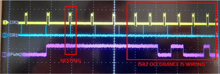

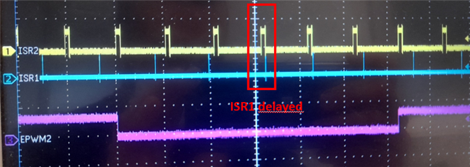

    Do you mean, that if ISR2 is running, and higher priority ISR1 happens in the middle, than ISR2 takes longer to complete?
     If ISR1 does not nest ISR2, the period of ISR2 is fixed (833us). This is an expected behaviour.
    On the other hand, if ISR2 is running and ISR1 happens, next occurance of ISR2 is not correctly triggered. Indeed, the period of ISR2 decreases (it is about 533us)
    I would like to know if my functions ISR2 and ISR1 are correct.

  • Dear mr Victor Kazmirenko,
    thank you for your support.
    Probably, as you mentioned, the problem is the pre-emption.
    Indeed, my code fails if ISR1 happens while ISR2 is executing the following instructions:
    etaMax = ptNOM->etaMaxS-(ptNOM->frEtaMaxS-freal)*ptNOM->KetaMax;
    etaMax = (etaMax < ptNOM->etaMaxS) ? etaMax : ptNOM->etaMaxS;
    etaMax = (etaMax > ptNOM->etaMaxI) ? etaMax : ptNOM->etaMaxI;
    Probably a wrong preservation of the registers involves wrong calculations of my variables.
    By replacing the static struct ptNom with numbers, the problem disappears.....!
    etaMax = 1.0-(30.0-freal)*0.05;
    etaMax = (etaMax < 1.0) ? etaMax : 1.0;
    etaMax = (etaMax > 0.85) ? etaMax : 0.85;
    To my knowledge, to make program with interrupts one have to preserve registers modified by ISR and restore them on return
    Yes, I do. At the beginning of my ISRs I preserve the following registers: CSR, ITSR, IER and  IRP. Should I preserve other registers? ...
    This can be done by compiler if interrupt keyword is specified for ISR. I don't see that in your snippet, hope it's there in your real code.
    I do not use the keyword __interrupt. I developed my code starting from the CSL examples within  the pdk_k2g_1_0_16. No example uses this keyword...
    I have just added this keyword to my ISRs but they never happens...the system does not work anymore.
    Benito

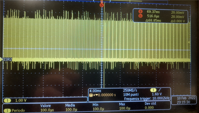

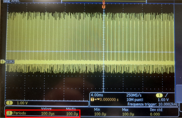

    I performed a simple test. I programmed the module TIMER 1 to trigger a ISR named timerISR with a period of 100us.
    Here below the function I used to program the module INTC.
    eventId = (int32_t)CSL_C66X_COREPAC_TIMER_1_INTL; //  C66x Interrupt Sources ID
    intNum=4; // interrupt priority
    addrIsr=&timerIsr; // address of ISR
    intc_init(eventId, intNum, addrIsr);
    The function intc_init is reported in the following snippet:
    void intc_init(uint32_t event, int32_t intNum, void *addrIsr)
        CSL_IntcObj IntcObj;
        CSL_IntcEventHandlerRecord  evtHandler;
        CSL_IntcVectId n_priority;
         // record the index in the handle
         gContext.numEvtEntries = (Uint16)C66X_COREPAC_EVENT_CNT;
         gContext.eventhandlerRecord = gEventRecord;
         (void)CSL_intcInit(&gContext);
         FirstTime = (bool)true; // first time occured
         (void)CSL_intcGlobalNmiEnable(); // This API enables global NMI
         (void)CSL_intcGlobalEnable((CSL_IntcGlobalEnableState *)NULL_PTR); // The API enables the global interrupt
         IntcHandle = CSL_intcOpen(&IntcObj, (CSL_IntcEventId)event, (CSL_IntcParam *)&intNum, (CSL_Status *) NULL_PTR); // It returns a handle to the INTC
         evtHandler.arg = (void *) (uintptr_t)&IntcHandle;
         evtHandler.handler = (CSL_IntcEventHandler)addrIsr;
         (void)CSL_intcPlugEventHandler(IntcHandle, &evtHandler); // It associates the event-handler to the event so that the occurence of the event would result in the event-handler being invoked.
         (void)CSL_intcHwControl(IntcHandle,CSL_INTC_CMD_EVTCLEAR,NULL_PTR); // It clears the events
         (void)CSL_intcHwControl(IntcHandle,CSL_INTC_CMD_EVTENABLE,NULL_PTR); // It enables the events
         (void)CSL_intcInterruptEnable((CSL_IntcVectId)intNum);      // Enabling the interrupt in INTC.
         //CSL_intcClose(IntcHandle);
    Here below two different behaviours.
    CASE 1: No use of keyword interrupt WITH a function call in ISR
    void timerIsr(void)
         {   GPIOx_write(GPIO_AUDIOEXP16_PIN_NUM, GPIO_PIN_HIGH); // set GPIO high
             DSP_function() // this function performs some calculations
             GPIOx_write(GPIO_AUDIOEXP16_PIN_NUM, GPIO_PIN_LOW); // set GPIO low
    The interrupt is correctly triggered every 100us
    CASE 2: Use of keyword interrupt WITH a function call in ISR
    interrupt void timerIsr(void)
             DSP_function();  // this function performs some calculations
    The interrupt is triggered only within 30ms. After 30ms the execution suddenly exits from taskISR (the GPIO remains high) and never triggers it again.
    CASE 3: Use of keyword interrupt WITHOUT any function call in ISR
           /* no functions */
    Therefore, in CASE 2 after 30ms the execution enters the DSP_run() but it never returns....
    Why does this happen?
    Benito

    By replacing the struct ptNOM  with numbers everything works fine....
    Therefore, the nesting of the ISR1 within the first script corrupts the calculations....
    Benito
  • Dear Victor,
    the problem seems to be related to the nesting of the ISR while the following instructions are in execution.
    I focused on the pointer to struct ptNom.
    By replacing this pointer with the struct, the problem does not occur anymore.
    etaMax = tbpard.etaMaxS-(tbpard_.frEtaMaxS-freal)*tbpard.KetaMax;
    etaMax = (etaMax < tbpard.etaMaxS) ? etaMax : tbpard.etaMaxS;
    etaMax = (etaMax > tbpard.etaMaxI) ? etaMax : tbpard.etaMaxI;
    Benito
