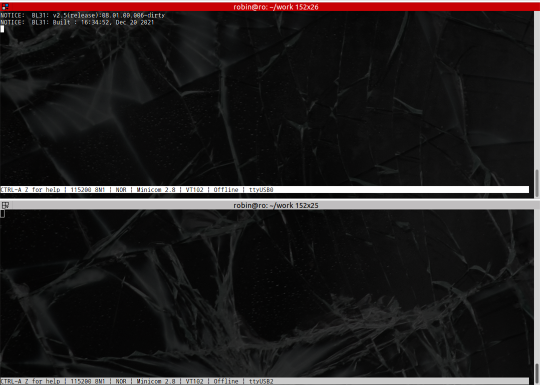

We modified the below for mcusw bootting by EMMC.
a. pdk_jacinto_08_01_00_36/packages/ti/boot/sbl
b. pdk_jacinto_08_01_00_36/mcusw/mcuss_demos/boot_app_mcu_rtos

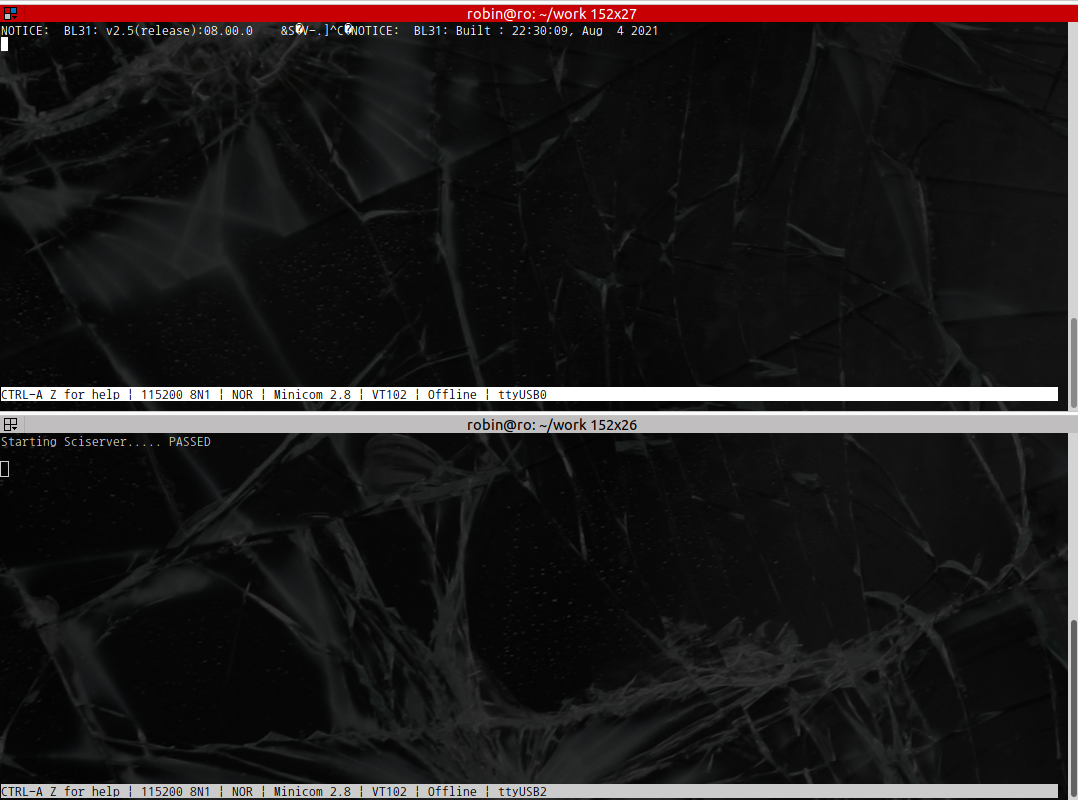

the compile result of boot_app_mcu_rtos was working well on the sdk_8_0(ti-processor-sdk-rtos-j721e-evm-08_01_00_11)
but, that is not working on the the sdk_8_1(ti-processor-sdk-rtos-j721e-evm-08_01_00_13)
the below is compile-command for boot_app_mcu_rtos
- sdk_8_0
> $ make -s can_boot_app_mcu_rtos MCUSW_UART_ENABLE=TRUE BOARD=j721e_evm SOC=j721e BUILD_PROFILE=release CORE=mcu1_0 BUILD_OS_TYPE=tirtos
- sdk_8_1
> $ make -s can_boot_app_mcu_rtos MCUSW_UART_ENABLE=TRUE BOARD=j721e_evm SOC=j721e BUILD_PROFILE=release CORE=mcu1_0 BUILD_OS_TYPE=freertos

how to boot of the mcusw on EMMC on SDK8.01?
Can I get the sample code for bootting of the mcusw on EMMC for SDK8.01?
