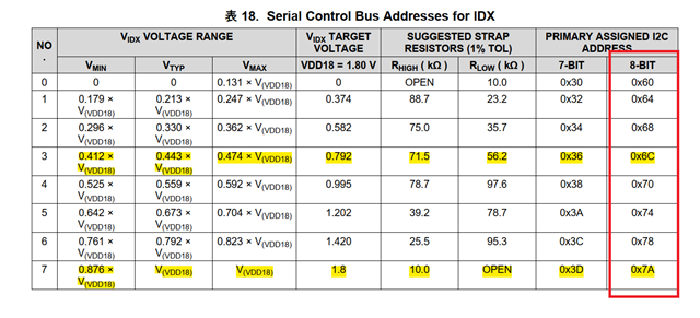

In that board, there is a Deserializer DS90UB960-Q1. We want to know:
1) what is the device address(I2C address) of DS90UB960-Q1 in TDA4VM?
2) how can we know it is using 7-bit or 8-bit address?

  • Hi Li,
    TDA4VM board does not contain UB960. There is a separate board, known as fusion board, which includes ub960.
    I think the i2c address of the ub960 on fusion board is 0x3D and it is 7 bit address.

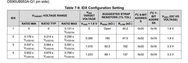

    Currently we are using Camera AR820(including Serializer UB953). And connect to Deserializer UB960 in TDA4VM fusion board.
    We confirmed the I2C address of Serializer UB953 is 0x30(8bit).

  • Hi Li,
    Yes, the i2c address of ub960 on fusion board is 0x3d for the instance-1 and 0x36 for the instance-2. You could find it in the Board_fpdU960GetI2CAddr API in ti-processor-sdk-rtos-j721e-evm-08_01_00_11/pdk_jacinto_08_01_00_33/packages/ti/board/src/devices/fpd/ds90ub960.c file.
    Address is 7bit, but additional 1bit is used to specify read/write operation, so total 8bits..
    Brijesh
  • Hello Jadav
    We still have some question.
    As I menteioned, we are using Serializer UB953 in Camera AR820. And UB953 is using 8bit address.
    If Deserializer UB960 is using 7bit address, how can they communicate with each other and how can they know whether the other one is using 7bit or 8bit?
    You can refer address table from data sheet.
    UB953:
    UB960:
    Li
  • Hi LI,
    Both are using 7bit address, Typically 7bit address is shift by 1 bit to create 8bit address (0x36 -> 0x6C) and lower bit is used for indicating read/write operations..
    Brijesh

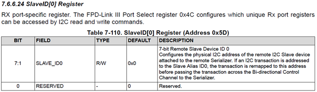

  • Hello Brijesh
    Thank you for your reply.
    Could you please point me out in this SDK where I can find related code of 1 bit shift for read and write?
    I found the address defination in ds90ub960.c. But I can't find the bit shift related code.
    Li
  • Hello Li,
    Please check file ti-processor-sdk-rtos-j721e-evm-08_00_00_12\imaging\sensor_drv\src\iss_sensors.c, it writes ub960 register using UB960_WriteReg -> Board_i2c8BitRegWr. This API uses 7bit address, which gets directly written to I2C_SA register..
    In addition, please refer to below application note to understand how i2c transaction works.
    https://www.ti.com/lit/an/slva704/slva704.pdf
    Brijesh

    1) We confirmed in this code, it is calling both 0x3D for instance-1 and 0x36 for instance-2. We want to know why it is calling both 0x3D and 0x36? And what is the purpose to call both of them?
    2)How can we know 0x36 and 0x3D they are 7bit or 8bit?
    3)In the test code, we confirmed it is accessing SlaveID[0] register(address 0x5D) and SlaveID[1] register(address 0x5E).
    3-1) Our understanding is it is means Serializer UB953 Slave[0] address is 0x30 and Serializer UB953 Slave[1] address is 0xFF. Is our understanding correct or not?
    3-2) Basd on the table 7-10 SlaveID[0] register, bit0 is reserved. So it is actually 7bit 0x18. Is our understanding correct?
    3-3) Why bit0 is reserved? it is reserved for read or write?
    0x3d	0x5d	0x30	#SlaveID[0]
    0x3d	0x65	0xff	#SlaveAlias[0]
    0x3d	0x5e	0xff	#SlaveID[1]
    0x3d	0x66	0xff	#SlaveAlias[1]
    0x36	0x5d	0x30
    0x36	0x65	0xff
    0x36	0x5e	0xff
    0x36	0x66	0xff
    4) Based on your reply Address is 7bit and shift 1 bit for read or write. However in the address table, there is also 8-bit adress. For 0x3D(7bit), 8bit adress is 0x71A. We'd like to know why you also define 8bit adress and in what case 8bit address will be used?
    Li
    ok, can you also check the lock status?
    It could be, but before that, can you check the lock status? if the link is locked, then you could read valid i2c address in these registers.
    Yes
    Please ignore bit0, just use upper 7bit as a slave address
    8bit address is just left shifted 7bit address. 7bit address will be appended by 1bit for indicating read/write operation to create 8bit address.. I would suggest you to refer to below application note to understand how i2c works.
    www.ti.com/.../slva704.pdf
    Brijesh

    We confirmed the application note you share. I know the point is Device address is 7bit.
    But 8bit address defined as below is really confused us. Can we know the backgrond TI define 8Bit here?
    What is the confusion here? 8bit address is 1bit left shifted 7bit address..
    Brijesh

    The point confused us is in table there is defination for both 7bit and 8bit, it gives us impresstion that 7bit and 8bit are different and used in different case.
    Based on your explaination, 8bit just 1 bit shift and it is equivalent to 7bit. Is my understanding correct?
    Li
  • Hi LI,
    As i explained we are using only 1 channel and lock statsu is 1, can you please reply to my first question as below?
    I think that is how the common configuration is set in the imaging component. In the API IssSensor_DeserializerInit, in the file ti-processor-sdk-rtos-j721e-evm-08_01_00_13\imaging\sensor_drv\src\iss_sensors.c, the common configuration is set for both the ub960. You could remove it if you dont require it..
    Yes, that's correct.
    Brijesh
