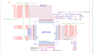

DPI1->ADV7511->hdmi monitor

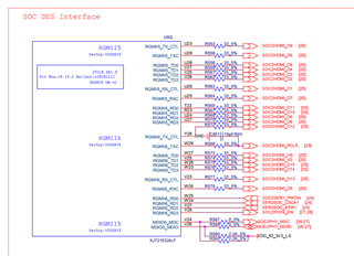

In my TDA4VM board,we use DPI1(Vout1) connect to hdmi monitor as shown above.
we use 16 bit data in vout1.
I made the changes in these files as below. and test with this demo named "gles2-gears", but there is no signal in Vout1 pins.
It will show a picture in screen if it work.

pdk_jacinto_07_01_00_45/packages/ti/board/src/j721e_evm/J721E_pinmux_data.c
static pinmuxPerCfg_t gVout0PinCfg[] =
/* MyVOUT1 -> VOUT1_DATA0 -> U23 */
PIN_RGMII5_TX_CTL, PIN_MODE(4) | \
((PIN_PULL_DISABLE) & (~PIN_PULL_DIRECTION & ~PIN_INPUT_ENABLE))
/* MyVOUT1 -> VOUT1_DATA1 -> U26 */
PIN_RGMII5_RX_CTL, PIN_MODE(4) | \
/* MyVOUT1 -> VOUT1_DATA2 -> V28 */
PIN_RGMII5_TD3, PIN_MODE(4) | \
/* MyVOUT1 -> VOUT1_DATA3 -> V29 */
PIN_RGMII5_TD2, PIN_MODE(4) | \
/* MyVOUT1 -> VOUT1_DATA4 -> V27 */
PIN_RGMII5_TD1, PIN_MODE(4) | \
/* MyVOUT1 -> VOUT1_DATA5 -> U28 */
PIN_RGMII5_TD0, PIN_MODE(4) | \
/* MyVOUT1 -> VOUT1_DATA6 -> U29 */
PIN_RGMII5_TXC, PIN_MODE(4) | \
/* MyVOUT1 -> VOUT1_DATA7 -> U25 */
PIN_RGMII5_RXC, PIN_MODE(4) | \
/* MyVOUT1 -> VOUT1_DATA8 -> U27 */
PIN_RGMII5_RD3, PIN_MODE(4) | \
/* MyVOUT1 -> VOUT1_DATA9 -> U24 */
PIN_RGMII5_RD2, PIN_MODE(4) | \
/* MyVOUT1 -> VOUT1_DATA10 -> R23 */
PIN_RGMII5_RD1, PIN_MODE(4) | \
/* MyVOUT1 -> VOUT1_DATA11 -> T23 */
PIN_RGMII5_RD0, PIN_MODE(4) | \
/* MyVOUT1 -> VOUT1_DATA12 -> Y28 */
PIN_RGMII6_TX_CTL, PIN_MODE(4) | \
/* MyVOUT1 -> VOUT1_DATA13 -> V23 */
PIN_RGMII6_RX_CTL, PIN_MODE(4) | \
/* MyVOUT1 -> VOUT1_DATA14 -> W23 */
PIN_RGMII6_TD3, PIN_MODE(4) | \
/* MyVOUT1 -> VOUT1_DATA15 -> W28 */
PIN_RGMII6_TD2, PIN_MODE(4) | \
/* MyVOUT1 -> VOUT1_DE -> W26 */
PIN_RGMII6_RXC, PIN_MODE(4) | \
/* MyVOUT1 -> VOUT1_HSYNC -> W27 */
PIN_RGMII6_TD0, PIN_MODE(4) | \
/* MyVOUT1 -> VOUT1_PCLK -> W29 */
PIN_RGMII6_TXC, PIN_MODE(4) | \
/* MyVOUT1 -> VOUT1_VSYNC -> V25 */
PIN_RGMII6_TD1, PIN_MODE(4) | \
{PINMUX_END}

    2. I use run_app_dof.sh script, HDMI still no output, and the CLK of adv7511 has no signal, but data2 has, data3 and data12 also no signal.
    3. In another version i use A72 control DSS, and test 'gles2-gears',  i find that CLK and data of adv7511 have signals, but HDMI is not output in the end.
    This version has some modify in default code. so i want to known is there a patch when use DPI-1 for output. If it is exist, please share me, Thanks

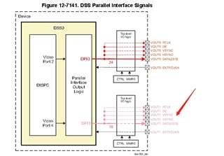

    https://e2e.ti.com/support/processors-group/processors/f/processors-forum/949461/faq-processor-sdk-dra8x-tda4x-how-to-enable-vout1-dpi1-output-in-vision-apps
    Are you enable DPI1 in embedded sync format or discrete sync format? Because embedded sync format is not supported on DPI1.
    If you are using discrete sync format and it is still not working, can you please probe clk, hs, vs signals and see if they are toggling first?

    Now i have a problem. by hw designe vout1 hava 16 ouputs, it is data0~data15, and it's encode is BT1120. But which parameter is difined it? now vout1 data has no signals. Is there anything need to config?
  • Hi xie jc,
    Sorry did not get your question, do you mean your receiving module expects bt1120 format? I think bt1120 format is not supported on vout1.
    Brijesh
  • Are you enable DPI1 in embedded sync format or discrete sync format? Because embedded sync format is not supported on DPI1
    as your last advise, i modify dvoFormat to APP_DCTRL_DV_GENERIC_DISCSYNC, then HS,VS,DE has signals, but vout1 data0~data15 pins has no signals, and hdmi monitor also no image.
    in DPI1 inputs condition, we only want hdmi monitor can display, but now it not work.
    on my side,i find that if i only modify dvoFormat to APP_DCTRL_DV_BT1120_EMBSYNC, vout1 data0~data15 has signals, but HS,VS,DE no signal.
    i think maybe some something not correct in code.
    also i am not sure what is correct videoIfWidth. 12bit or 16bit is correct in my design?
    Looking forward to your reply, thanks a lot!
  • When you set the output format to APP_DCTRL_DV_BT1120_EMBSYNC, there will not be any sync signals, ie nothing on HS, VS and DE.
    Could you please check if you require these signals or not?
    If you require these signals, then please set the output format to APP_DCTRL_DV_GENERIC_DISCSYNC. If you are seeing signals in HS, VS and DE output signals, then the venc is started and is outputting data. can you also check if vs frequency is correct? In this case, can you please check if pinmux is setup correct? What is the background color you are setting in overlay manager. Can you set the some difference background color, like white, which will have all line high?

  • Hi Brijesh Jadav,
    now hdmi connect is work, it will show background color, not display no signal.
    when i set to APP_DCTRL_DV_GENERIC_DISCSYNC, the frequece of VS is 57Hz, the frequece of HS is 43kHz, and DE also has signal. But DPI1 output0~output15 no signal.
    Is these frequeces correct?
    as your said "If you are seeing signals in HS, VS and DE output signals, then the venc is started and is outputting data."
    what will cause this thing happen? the display flow is DPI1->ADV7511->hdmi monitor, now ADV7511->hdmi is normal.so maybe something is wrong in TDA4 DPI1 setting.
    what is your opition about it?
