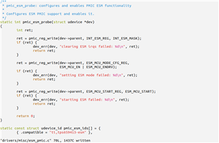

Dear Champs,
My customer found the watchdog interrupt(SOC_SAFETY_ERRORn) was not worked and there was no wdt interrupt generated during long time when they test watchdog using ltp command.
When they checked watchdog driver, it seems there is no issue in SW and watchdog driver was processed.
But, there was no signal change observed in SOC_SAFETY_ERRORn pin of TDA4.
As there is no specific design between TDA4 and TPS65941213 and SOC_SAFETY_ERRORn was just connected to GPIO3 of TPS65941213 in their HW, they want to get our helpful comments to debug this issue.
one other strange thing is that reset was not occurred even when they forced low signal in the GPIO3 of TPS65941213 PMIC.
When they tried all these things in TI EVM, they found the WDT reset was occurred well. And also, when they tried to force low signal in the GPIO3 of PMIC, the reset was occurred in TI EVM.
Please check below log and let me know you guide to debug this issue in their custom board.
