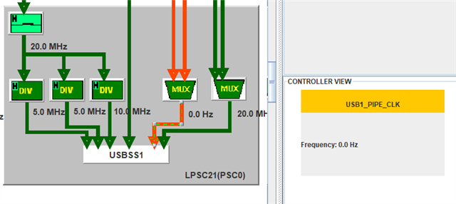

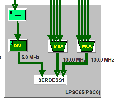

I am having trouble getting the USB3.0 host controller to connect with a device on a type C connector on USBSS1. The device will connect at HS but not SS. I am verifying that the clocks are set up correctly.
The Clock Tree Tool shows a clock called USB1_PIPE_CLK that is not enabled (red) but there is no documentation for this that I could find in the TRM. I am using SERDES1.
The Mux shows it is set up to choose the SERDES1_IP_LN1_CLKOUT
I will have more things to check on this thread but I want to verify the clocks are set up correctly first.

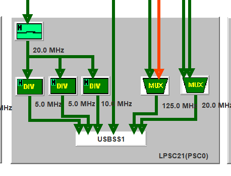

The CTT does not show ACLK either.
Where is USBSS1 ACLK in CTT?
What is USB1_PIPE_CLK in CTT?
  • Here is the SERDES1 in CTT:

    Focusing on USB1_PIPE_CLK first, does the clock tree tool show the source of the 2 inputs to MUX_USB1_PIPE?  Is there a way to enable one of them?
    -Zack

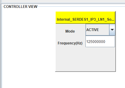

  • in CTT, the source inputs to MUX_USB1_PIPE go to SERDES1_IP3_LN1_CLKOUT and SERDES2_IP3_LN1_CLKOUT. If you go to the Controller View for those clocks it shows mode Inactive. If you toggle to active then I think you need to specifiy a frequency but there's no documentation for these clocks that I could find in SPRUIJ7A.
    As a test I changed Internal_SERDES1_IP_LN1_So... to Mode Active and set it to 125MHz (complete swag), then saved the CTT registers and compared that to my register dump that I got from the board over jtag. There were no diffs.
  • If you disable that clock and then save the CTT registers, and diff them with the CTT registers with the clock enabled, is there a difference?  Also, what software is setting the registers on your board?
    no
    code from ti-processor-sdk-rtos-j721e-evm-07_03_00_07

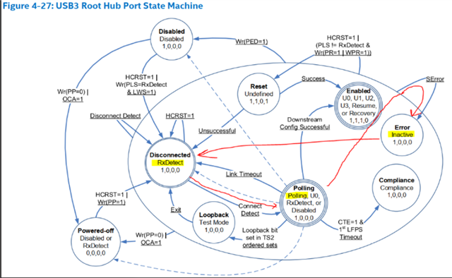

    I was seeing the USB2 xhci portsc transition to the connected state but the USB3 portsc went from link state RxDetect->Polling->Inactive->RxDetect with the PLC flag set.
    We removed the surge suppresion components between the type C and the USB3 redriver and the behavior changed to never getting out of the RxDetect Disconnected state.
