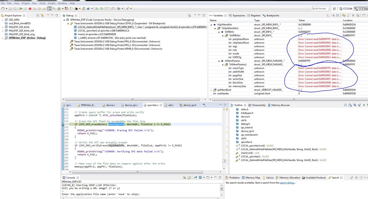

While debugging we found following issue
The hSPIMEMInfo Variable shows in the debugger, that CCS cannot read at the specific adresses. So the problem is, that it does not goes into the erasing and programming section as it always drop out at:
else if (hSPIMemInfo->hMemParams->memType == SPI_MEM_TYPE_FLASH)
